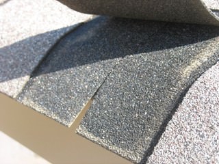

Phillip Posted July 24, 2008 Report Share Posted July 24, 2008 Brandon, I would tell my clients to get their own roofer out there to look at it and call the manufacturer to talk to them about it. If the starter strip is wrong it's still wrong whether it's leaking are not. If you are going to peel back shingles which is your choice to do I would take a caulking gun with the proper type sealant and stick the shingles back down. Quote Link to comment Share on other sites More sharing options...

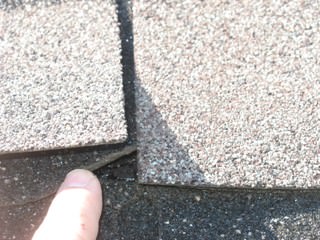

Phillip Posted July 24, 2008 Report Share Posted July 24, 2008 The best roofer in the area did this according to the home owner which was my client. The roof was put on 4 months ago. Image Insert: 137.97 KB Image Insert: 166.43 KB Image Insert: 148.68 KB Image Insert: 179.83 KB Image Insert: 140.6 KB Quote Link to comment Share on other sites More sharing options...
caryseidner Posted July 24, 2008 Report Share Posted July 24, 2008 Brandon, I always love hearing that statement "It's caused no problem up to now". It makes me laugh. Here's some verbiage from the NRCA Roofing & Waterproofing Manual (4th ed.): Starter Course for Shingles The starter course is applied directly over the underlayment or ice dam protection membrane along the downslope portion of the roof. Its primary purpose is to shed water that may migrate through the joints and cut-outs of the shingles in the overlying first course. The seams need to be staggered. Quote Link to comment Share on other sites More sharing options...
Tom Raymond Posted July 24, 2008 Report Share Posted July 24, 2008 OK, why would the roofer be upset about your comments if he didn't install the roof? Maybe he was just born an a$$hole... Phillip, with regards to pic #2, it's obvious the boot wasn't replaced, but what exactly do you recommend? If it were my house I would relocate the service entrance to eliminate the mast penetration through the roof, might as well because to replace the boot, the service would have to be disconnected and the clamps and weatherhead removed. Around here you might get the utility to foot the bill if you needed to upgrade to triplex anyhow, but from the shadow on the roof it looks like that was already done. Tom Quote Link to comment Share on other sites More sharing options...
hausdok Posted July 24, 2008 Report Share Posted July 24, 2008 Originally posted by Tom Raymond to replace the boot, the service would have to be disconnected and the clamps and weatherhead removed. Tom Not so. The same companies that make the one-piece boots also make two piece boots that can be installed around masts when the old boot is so trashed it needs to be cut off and thrown away. ONE TEAM - ONE FIGHT!!! Mike Quote Link to comment Share on other sites More sharing options...

caryseidner Posted July 24, 2008 Report Share Posted July 24, 2008 I would not make a habit of peeling back shingles. The potential for damage to the shingle is too great and unless you are prepared to correctly re-seal them, I think you are opening yourself up to liability for future damage. Quote Link to comment Share on other sites More sharing options...
Jerry Simon Posted July 25, 2008 Report Share Posted July 25, 2008 Originally posted by caryseidner I would not make a habit of peeling back shingles. The potential for damage to the shingle is too great and unless you are prepared to correctly re-seal them, I think you are opening yourself up to liability for future damage. I've done it on about 6,000 houses. Never a complaint. Quote Link to comment Share on other sites More sharing options...
hausdok Posted July 25, 2008 Report Share Posted July 25, 2008 Hi, I think your taking this too far. The only way that a case for liability for future damage could be brought if it could be proven that the future damage is directly related to the specific shingle that one pried up. So, if the edge of the roof below that specific shingle were damaged they'd have a case to say, "Hey you, you've got to pay for replacement of the rotten decking and this shingle," but they could not possibly make him liable for damages that occur elsewhere on the roof. I'd guess that about 40 to 50% of the roofs around here aren't properly sealed down and I routinely recommend having them hand sealed; nobody does it. The number of times I've actually seen damage other than a snapped-off shingle occur due to not being sealed down I can count on one hand out of many many thousands of roofs. ONE TEAM - ONE FIGHT!!! Mike Quote Link to comment Share on other sites More sharing options...
