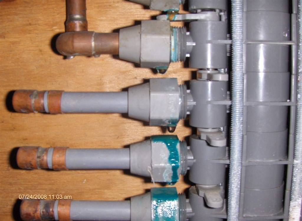

John Dirks Jr Posted July 27, 2008 Report Share Posted July 27, 2008 I found leaks at the PB manifold. I reported them but what is with the blue dye? Any ideas? Image Insert: 100.02 KB Also, if you blow up this picture you will see grass clippings and frogs in the sump pit. There were other signs of past flooding in this basement. Do you think the frogs and grass clippings got in there from the flood? How else would they get in there? Image Insert: 91.41 KB Quote Link to comment Share on other sites More sharing options...
ghentjr Posted July 27, 2008 Report Share Posted July 27, 2008 The "blue dye" appears to be copper sulphate from acidic water. Quote Link to comment Share on other sites More sharing options...

ghentjr Posted August 3, 2008 Report Share Posted August 3, 2008 After thought; If you look at this condition long term the blue corrosion means acidic water, which means down the line the entire copper system will get corrosion pinholes. They really need a water treatment system that will take the Ph down to an acceptable level. Quote Link to comment Share on other sites More sharing options...
Chad Fabry Posted August 4, 2008 Report Share Posted August 4, 2008 They really need a water treatment system that will take the Ph down to an acceptable level. Up Quote Link to comment Share on other sites More sharing options...
ghentjr Posted August 4, 2008 Report Share Posted August 4, 2008 Originally posted by Chad Fabry They really need a water treatment system that will take the Ph down to an acceptable level. Up Yes, up. Quote Link to comment Share on other sites More sharing options...
