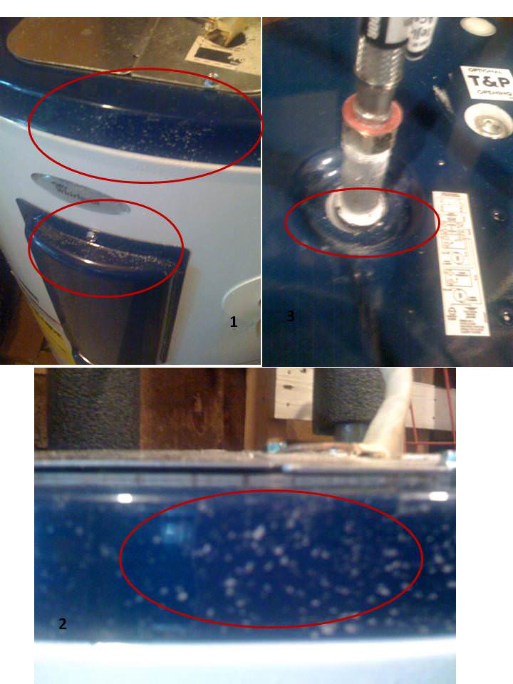

boo-booj Posted July 28, 2008 Report Share Posted July 28, 2008 I just noticed a white powdery substance around and on my water heater. It looks like someone took a can of baby powder and sprinkled it all over. The water heater is approx 6 months old. It does not appear to be coming from any of the fittings and is not on or around any of the other appliances in the area (freezer, washer, dryer). Any ideas, anyone? Polly Quote Link to comment Share on other sites More sharing options...

boo-booj Posted July 28, 2008 Author Report Share Posted July 28, 2008 Originally posted by Les Polly, Have you had any remodeling work done lately? How old is the house? No where near where the water heater is (outside shed) we did have a new roof put on the main house 2 months ago but not the shed, plus it just appeared in the last day or two. When I replaced it the plumber recommended we put on galvanized fittings for where the water comes in and out because my last one had rusted out in that area, that is the only thing different from my last water heater. Could that have someting to do with it? Quote Link to comment Share on other sites More sharing options...
Jim Katen Posted July 28, 2008 Report Share Posted July 28, 2008 Originally posted by boo-booj I just noticed a white powdery substance around and on my water heater. It looks like someone took a can of baby powder and sprinkled it all over. The water heater is approx 6 months old. It does not appear to be coming from any of the fittings and is not on or around any of the other appliances in the area (freezer, washer, dryer). Any ideas, anyone? Polly Where, precisely, in relation to the water heater is the powder? Is it on the floor or is it on top of the heater, near where the flue gases come out? - Jim Katen, Oregon Quote Link to comment Share on other sites More sharing options...
boo-booj Posted July 28, 2008 Author Report Share Posted July 28, 2008 Basically all over, it's like there was a light showering of snow on and around it. I don't know aboute the fuse gases but on top, on the edge where the plate is that you change the temperature and on the floor, is like fresh snow. Quote Link to comment Share on other sites More sharing options...

Jim Katen Posted July 28, 2008 Report Share Posted July 28, 2008 Originally posted by boo-booj Yes it is electric. When I get home this evening I will take a picture and post it, sorry I didn't have one this morning. My husband had a contractor friend of ours to come look at it. He said he had never seen anything like this but took a sample to take a plumber for us. Carpenter ants living in the foam shell? - Jim Katen, Oregon Quote Link to comment Share on other sites More sharing options...
boo-booj Posted July 28, 2008 Author Report Share Posted July 28, 2008 Don't know about that, I will look for any signs of ants, although I didn't see any this morning. I did poke my finger down on the foam core that surrounds the area where the water comes in and out but it seemed very firm, had no give or any loose material with it. Quote Link to comment Share on other sites More sharing options...
hausdok Posted July 28, 2008 Report Share Posted July 28, 2008 Hi, Well, if it were a gas water heater I'd expect that it was mineral salts from acid reacting with the flue. Since it's an electric it's hard to say. South Carolina, hmmm, baby powder, hmmm, is there any exposed framing above it? Maybe you've got powder post beetle(lychtid) frass (excrement) there. Are you sure it's white? If the floor joists above are exposed, examine them very closely for miniscule emergence holes. ONE TEAM - ONE FIGHT!!! Mike Quote Link to comment Share on other sites More sharing options...
boo-booj Posted July 28, 2008 Author Report Share Posted July 28, 2008 Thanks, Mike, I only had a few minutes to look this morning before coming to work however I did look overhead and the ceiling is exposed but seemed no different than the rest of the ceiling and the stuff is ONLY around and on the water heater. I don't think it's coming from above because the pipes that cross over the top of an inverter "L" did not have anything on them. Polly Quote Link to comment Share on other sites More sharing options...

boo-booj Posted July 28, 2008 Author Report Share Posted July 28, 2008 Well, the contractor friend wiped up most of the powder, he's coming back in a couple of days to see if there is any new. However, I did get a couple of pictures that shows a little. The spots that you see in picture 1 and 2 are what I'm talking about. Picture 3 shows there's no corrusion around the water lines. I went through the rest of the shed and saw nothing else. Polly Image Insert: 69.58 KB Quote Link to comment Share on other sites More sharing options...
boo-booj Posted July 29, 2008 Author Report Share Posted July 29, 2008 Jim Katen you may have hit it on the nail. I went out real early this morning and sure enough there were ants on the water heater, now I just need to verify and see what I need to do to get rid of them or get a new water heater. Thanks everyone! Polly Quote Link to comment Share on other sites More sharing options...
