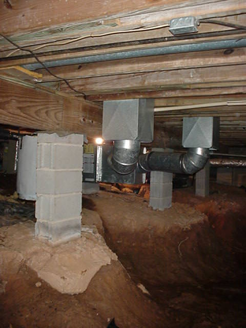

Phillip Posted July 31, 2008 Report Share Posted July 31, 2008 Some one wanted some more workspace in the walk in crawlspace. Image Insert: 98.5 KB Quote Link to comment Share on other sites More sharing options...
Erby Posted August 1, 2008 Report Share Posted August 1, 2008 If he doesn't reinforce that dirt, he's going to end up with less work space. Quote Link to comment Share on other sites More sharing options...
Jim Baird Posted August 1, 2008 Report Share Posted August 1, 2008 Philip I've seen a lot worse undercutting and have seen some that was really old, but have never seen signs of soil failure at those undercuts. Maybe it's the stability and strength of Ga red clay. At one undercut job, that was accomplished with equipment, the worst erosion of soil base was occuring on the outside of the foundation wall, where wrong-way site sloping was carving out beside the footing every time it rained. The house was under foreclosure, and the buyer who hired me found it on an internet list of "distressed properties". I don't think he bought it, but he seemed to be a trouble magnet. I followed him to his dwelling to get paid, and there he showed me burglar damage that his landlord wouldn't fix, and then he showed me the pistol he kept in his pocket due to the unsavory 'hood he lived in. Got my check and never seen him since. Erby, I have scratched my head a lot to figure out how one might "reinforce" or support that kind of mistake, and decided the only practical correction would be to start at the new level of cut, install spot piers with posts and beams to pick up whatever loads there are. Quote Link to comment Share on other sites More sharing options...

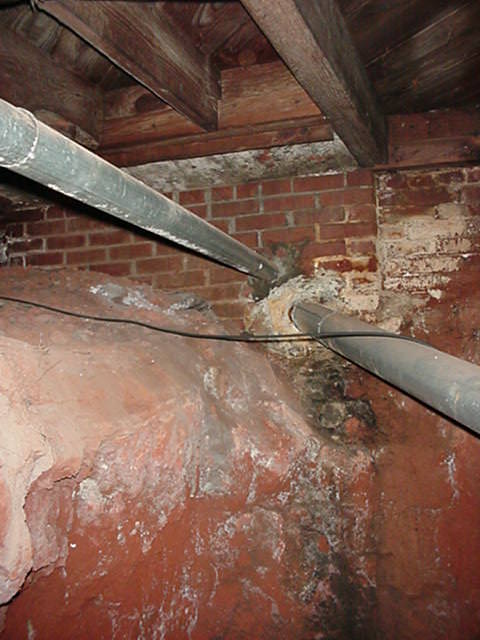

Jim Baird Posted August 1, 2008 Report Share Posted August 1, 2008 Couldn't stand it. See below. Image Insert: 57.3 KB Image Insert: 50.58 KB Quote Link to comment Share on other sites More sharing options...
Jim Baird Posted August 1, 2008 Report Share Posted August 1, 2008 Cpl more. Image Insert: 48.39 KB Image Insert: 57.94 KB Quote Link to comment Share on other sites More sharing options...

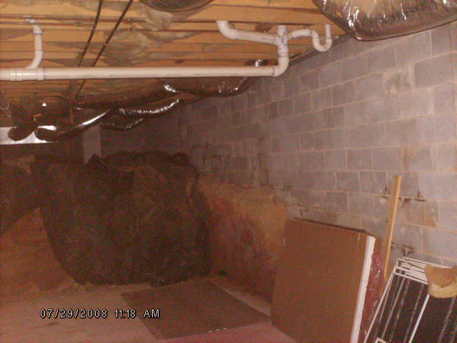

Erby Posted August 2, 2008 Report Share Posted August 2, 2008 I've seen several "dug out" basements around here. Stacked stone foundations reinforced. Thought I had a picture of the interior of this one I looked at earlier this week. They even added a window or two. House on the right. Dug out the about two thirds of the right half of the crawl space. Image Insert: 80.28 KB See it back past the water heater. Image Insert: 52.04 KB Yeah, it's cracked a bit but that's likely because of the downspout dumping water right at the rear corner. Rest of the crawl space was like this. Image Insert: 71.54 KB Image Insert: 56.87 KB Quote Link to comment Share on other sites More sharing options...
