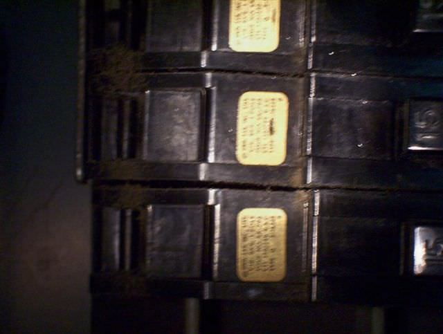

Mike Lamb Posted September 7, 2008 Report Share Posted September 7, 2008 Are all Zinsco panels and circuit breakers under suspicion of failure? This 1969 Zinsco panel had breakers labeled UND LAB INC. if I read correctly. Image Insert: 52.73 KB Image Insert: 64.35 KB Quote Link to comment Share on other sites More sharing options...
Jim Katen Posted September 8, 2008 Report Share Posted September 8, 2008 Originally posted by Mike Lamb Are all Zinsco panels and circuit breakers under suspicion of failure? This 1969 Zinsco panel had breakers labeled UND LAB INC. if I read correctly. Part of the problem with Zinsco panels was the design of the bus bars and the way that they connected to the breakers. The panel in your picture has the same troubling design. There are a lot of stories about unreliable Zinsco breakers, but no solid information. Personally, I wouldn't have one in my house. - Jim Katen, Oregon Quote Link to comment Share on other sites More sharing options...
hausdok Posted September 8, 2008 Report Share Posted September 8, 2008 Hi, Jim has it right. Look at the photo and the way those breakers are sagging. The loose connection to the buses makes them arc and overheat and that melts down the breaker casings. It doesn't happen with every single one but it happens with enough of them that they've earned a reputation with electricians as being a piece of crap. I used to live right across the street from a big electrical contractor. A couple of years ago when I'd talked to them about Zinsco panels, they told me that they'd recently replaced over 80 of them in a condo complex and that a "significant number" of them had problems. The guy didn't quantify exactly what that "significant number" was but it was clear that he and his guys consider them crappy panels. ONE TEAM - ONE FIGHT!!! Mike Quote Link to comment Share on other sites More sharing options...
kurt Posted September 8, 2008 Report Share Posted September 8, 2008 I've seen hundreds of them, and never seen a problem. That said, I adamantly insist to any of my customers considering a house with a Zinsco panel that they should get rid of it. It's a really crappy design. If someone wants to ignore me, that's their prerogative. Quote Link to comment Share on other sites More sharing options...
msteger Posted September 13, 2008 Report Share Posted September 13, 2008 i ditto what Kurt says. There isn't much info on the web (or elsewhere) available like what we find for FPE equipment, but I still tell my clients these have had a bad history of issues, are old by now, and recommend replacing them. Quote Link to comment Share on other sites More sharing options...
