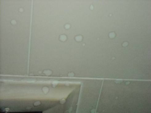

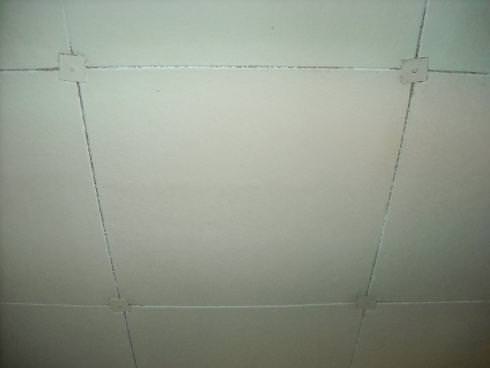

sepefrio Posted September 30, 2008 Report Share Posted September 30, 2008 A little background info. 1941 house. Home inspection for a client who is having some problems in her home, this house is not for sale. While talking with the owner of the house, she mentioned her husband and mother both died of cancer. Also in the time I was there, she herself smoked dang near a whole pack of cigarettes. I know nothing can be said 100%, but I think I'm looking at asbestos here. Anyone think I'm taking a leap by thinking two cancer deaths and the ceiling tiles may be linked? Would you say something besides have it tested? Image Insert: 141.81 KB Image Insert: 148.71 KB Image Insert: 141.4 KB Quote Link to comment Share on other sites More sharing options...
kurt Posted September 30, 2008 Report Share Posted September 30, 2008 They could be cellulose with white paint. At least, that's what they looked like. Highly unlikely that ceiling tiles killed people. Probably more like all those cigarettes. Quote Link to comment Share on other sites More sharing options...
Jim Katen Posted September 30, 2008 Report Share Posted September 30, 2008 Originally posted by sepefrio A little background info. 1941 house. Home inspection for a client who is having some problems in her home, this house is not for sale. While talking with the owner of the house, she mentioned her husband and mother both died of cancer. Also in the time I was there, she herself smoked dang near a whole pack of cigarettes. I know nothing can be said 100%, but I think I'm looking at asbestos here. Anyone think I'm taking a leap by thinking two cancer deaths and the ceiling tiles may be linked? Would you say something besides have it tested? If they were 12x12 tiles, they sure look like Firtex -- one of the few older building products that never contained asbestos. - Jim Katen, Oregon Quote Link to comment Share on other sites More sharing options...
hausdok Posted September 30, 2008 Report Share Posted September 30, 2008 Yep, Evil Knievel kinda leap. OT - OF!!! M. Quote Link to comment Share on other sites More sharing options...
Brandon Whitmore Posted September 30, 2008 Report Share Posted September 30, 2008 Those tiles/asbestos have nothing to do with it (non expert opinion disclaimer here). The nicotine crud from the tobacco smoke likely sealed the tiles long ago. I would guess that everything in that house was sticky? The same sticky stuff that prevented the asbestos fibers from flying airborne prevented their lungs from functioning adequately and led to cancer.......... Just a guess here. Quote Link to comment Share on other sites More sharing options...
