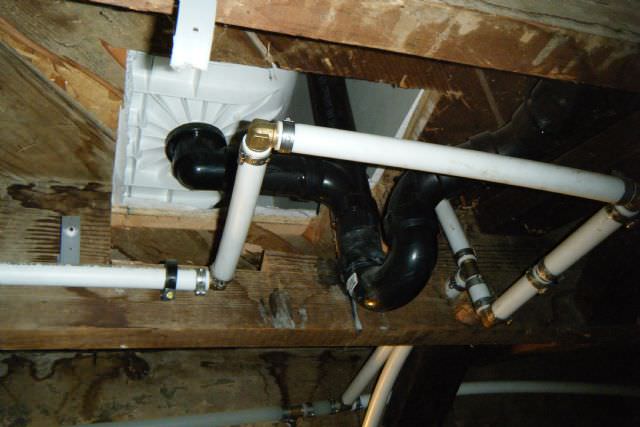

Brandon Whitmore Posted July 30, 2009 Report Share Posted July 30, 2009 Thanks Scott, It's easy to see the fittings in an unfinished basement.... Click to Enlarge 46.17 KB Quote Link to comment Share on other sites More sharing options...

Kyle Kubs Posted July 31, 2009 Report Share Posted July 31, 2009 Thanks Scott, It's easy to see the fittings in an unfinished basement.... Click to Enlarge 46.17 KB Ya know, I've seen a few installations like that recently. So many joints in it they might as well have used Copper... Remember when the whole point of PEX was to have piping with as few joints as possible? Despite that, I don't see a lot of this stuff at all. Either it's just not very popular in my area or my kind of clients aren't buying those kind of houses. And I don't mind at all. Quote Link to comment Share on other sites More sharing options...
KGarten Posted July 31, 2009 Report Share Posted July 31, 2009 Thanks Scott, It's easy to see the fittings in an unfinished basement.... Click to Enlarge 46.17 KB Ya know, I've seen a few installations like that recently. So many joints in it they might as well have used Copper... Remember when the whole point of PEX was to have piping with as few joints as possible? Despite that, I don't see a lot of this stuff at all. Either it's just not very popular in my area or my kind of clients aren't buying those kind of houses. And I don't mind at all. What is really fun is when you really get into the technical aspects of pex installations that are like this (non manifold installations)with too many joints. For example: if you follow the installation in the picture from left to right and going up through the floor you have a total developed length just from the fittings of 40 feet. Each 90 degree turn in pex is a minimum of 9 feet developed length and a coupling or running tee is 2 feet. Also the interior diameter of pex is substantially smaller the copper. 1-1/2" Pex has the same internal diameter as 1-1/4" copper. And don't let them sell you on the "I can run it at a higher rate of flow" argument. The pressure loss at 7 ft/sec velocity on 4gpm on 1/2" pex is 20psi per 100'. Type L copper running 4gpm will run a velocity of 5ft/sec (which will be a quieter system) with a pressure loss of 10 psi per 100'. This is substantial when you consider the friction losses in pressure due to fittings (copper fittings add 1 foot developed length in 90s and 2 feet on branch tees . Couplings on small copper sizes are not counted at all.) It is easy for the Pex installations like the one shown in the picture to go into a higher range band in the IRC sizing charts. I've seen what should have been a 100' developed length design go into a 250' developed length because of fittings. The problems are worse in larger houses with bigger sizes of pex. I have been in a brand new 5000 sq/ft house where you could turn on a lavatory faucet and then turn on the one right next to it and watch both streams of water get smaller. And turn on the tub and watch the streams get smaller again. All the while the water pressure guage on the system is dropping 2psi, from 52psi down to 50psi. Anyone running a branch and tee system with multiple fittings using pex must substantially upsize the system or it will be noisy and inefficient at best. Manifold systems are the way to go. Quote Link to comment Share on other sites More sharing options...
