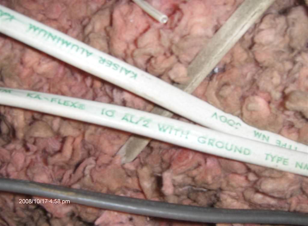

John Dirks Jr Posted October 19, 2008 Report Share Posted October 19, 2008 I've been inspecting homes for a bit over a year now. I found aluminum wiring for the first time this past Friday. It was a mess being haphazardly strewn about the attic with no staples or junction boxes. Yikes!!! Image Insert: 90 KB Image Insert: 136.21 KB Image Insert: 127.5 KB Quote Link to comment Share on other sites More sharing options...
msteger Posted October 19, 2008 Report Share Posted October 19, 2008 John, I've only run across a home completed wired with Al once in over 6 years. I noted this condition in the report and put a blurb about the potential risks of AL wiring. The selling agent freaked out saying he'd never heard of Aluminum wiring being a problem and has not referred me since (about 4 years ago). I included a link to the CPSC brochure about Al wiring hazards for the client and agent to see. Incidentally, I did find several branch circuits with undersized wiring compared to the overcurrent protection. I recommended having a licensed electrician in to evaluate the electrical system (due to the Al wiring AND the overcurrent protection issues) since I couldn't tell if any of the components (such as switches and receptacles) were rated for AL. Quote Link to comment Share on other sites More sharing options...
John Dirks Jr Posted October 19, 2008 Author Report Share Posted October 19, 2008 Both the NAHI and State of Maryland SOP require inspectors to mention in the report the presence of aluminum wiring. I did that. I noted that it wasn't the aluminum wiring itself that was a problem but the installation methods that needed to be checked to make sure they are correct. I didn't get into it too deep. I just stated that the electrician will know what to look for. I did call out other specific electrical problems like open splices, doubled neutrals, open grounds, painted receptacles, etc. Quote Link to comment Share on other sites More sharing options...
John Dirks Jr Posted October 20, 2008 Author Report Share Posted October 20, 2008 You're right Walter. I'm glad that it's not my job to judge an electrician's ability. However, it is my job to tell my client to get said electrician out to fix whatever. After that, it's in my rear view mirror. Hopefully for good. Quote Link to comment Share on other sites More sharing options...
Brian G Posted October 20, 2008 Report Share Posted October 20, 2008 I noted that it wasn't the aluminum wiring itself that was a problem But according to the CPSC and others, it is. Pardon my saying so, but it's not a good idea to bless it.id="blue"> I'm sure our moderator will weigh in, but my understanding is that the problems were primarily related to installation issues, like incompatible devices and improper connection methods that couldn't tolerate the greater expansion/contraction typical of AL branch wiring. I can't find anything at CSPS that says different; got any links? Brian G. Not That I Would Bless It Either [:-scared] Quote Link to comment Share on other sites More sharing options...
Phillip Posted October 20, 2008 Report Share Posted October 20, 2008 This is what I use on my report when I have aluminum wiring. It is from Mark Cramer. I also recommend that they have an electrical that knows about this type wire check the connection and repair as needed. Solid strand aluminum wiring is present in the home. This wiring was installed in homes between 1965 and 1973 after which it was discovered that it is a potential fire hazard. The Consumer Product Safety Commission (CPSC) has had research conducted that has demonstrated that homes with this old style aluminum wiring (pre-1972) are 55 times more likely to have one or more connections reach fire hazard conditions than homes wired with copper. The hazard occurs at connections, such as at receptacles, switches, and at major appliance connections. Corrosion of the metals in the connection, particularly the wire itself, causes increased resistance to the flow of electricity that causes over heating. Newer aluminum alloys have fewer problems. Modern standards require the use of newer, safer devices (Receptacles, switches, and circuit breakers, etc.) labeled ALR rather than the older AL devices used here. The modern devices reduce the risk. Some experts feel that even these devices do not completely eliminate the hazards. We recommend you obtain the booklet "Aluminum Wiring in the Home" from the CPSC at 1-800-638-2772 or on the web at http://www.cpsc.gov/cpscpub/pubs/516.pdf Quote Link to comment Share on other sites More sharing options...
Jim Katen Posted October 20, 2008 Report Share Posted October 20, 2008 Originally posted by Phillip This is what I use on my report when I have aluminum wiring. It is from Mark Cramer. I also recommend that they have an electrical that knows about this type wire check the connection and repair as needed. Solid strand aluminum wiring is present in the home. This wiring was installed in homes between 1965 and 1973 after which it was discovered that it is a potential fire hazard. The Consumer Product Safety Commission (CPSC) has had research conducted that has demonstrated that homes with this old style aluminum wiring (pre-1972) are 55 times more likely to have one or more connections reach fire hazard conditions than homes wired with copper. The hazard occurs at connections, such as at receptacles, switches, and at major appliance connections. Corrosion of the metals in the connection, particularly the wire itself, causes increased resistance to the flow of electricity that causes over heating. Newer aluminum alloys have fewer problems. Modern standards require the use of newer, safer devices (Receptacles, switches, and circuit breakers, etc.) labeled ALR rather than the older AL devices used here. The modern devices reduce the risk. Some experts feel that even these devices do not completely eliminate the hazards. We recommend you obtain the booklet "Aluminum Wiring in the Home" from the CPSC at 1-800-638-2772 or on the web at http://www.cpsc.gov/cpscpub/pubs/516.pdf There's a small flaw in that bit of boilerplate. While you definitely want to have switches & receptacles with the CO-ALR designation, there isn't any such thing as a circuit breaker with that designation. They're all labeled CU-AL (and that's ok). My take on aluminum wiring: I don't trust the old 1350 alloy at all. It fatigues easily and there's a high risk of cracked wires. That risk increases every time it's manipulated -- for instance when an electrician examines the connections on our recommendation. Also, most of the 1350 branch wiring was installed with switches & receptacles that were either listed for copper only or that were the older, inferior CU-AL type. I'm aware of two homes in my area that burned to the ground because of defects with this type of wire. One of those homes was owned by my wife's boss. If I can determine that this type of branch circuit wiring is present in a house that I'm inspecting, I recommend ripping it all out and replacing it with new copper. The improved 8000-series alloys are different. This wire is fine, though the connections are still slightly challenging. With that alloy, I'd advise my customer to have an electrician ensure that every switch & receptacle is the CO-ALR type, that every connection is snug, and that every connection is made up with a device that's listed for aluminum. Any new connections should be made up with the new Alumiconn connectors. In my area, that should take an electrician about one afternoon if he works with an assistant. With this small investment, 8000-series branch circuit wiring ought to be as safe as copper wiring. In John's original post, the cables in the pictures look like the older alloy -- I don't see the marking "AA-8000" on the cable sheath anywhere. Since most of the wiring in that house seems to be copper, it should be relatively simple to just swap out the few aluminum circuits that are there. I certainly wouldn't waste any money trying to improve the mess in that attic -- I'd rather put the money toward replacement. - Jim Katen, Oregon Quote Link to comment Share on other sites More sharing options...

Phillip Posted October 21, 2008 Report Share Posted October 21, 2008 Originally posted by Jim Katen There's a small flaw in that bit of boilerplate. While you definitely want to have switches & receptacles with the CO-ALR designation, there isn't any such thing as a circuit breaker with that designation. They're all labeled CU-AL (and that's ok). - Jim Katen, Oregon Thanks for the info Jim. Quote Link to comment Share on other sites More sharing options...
