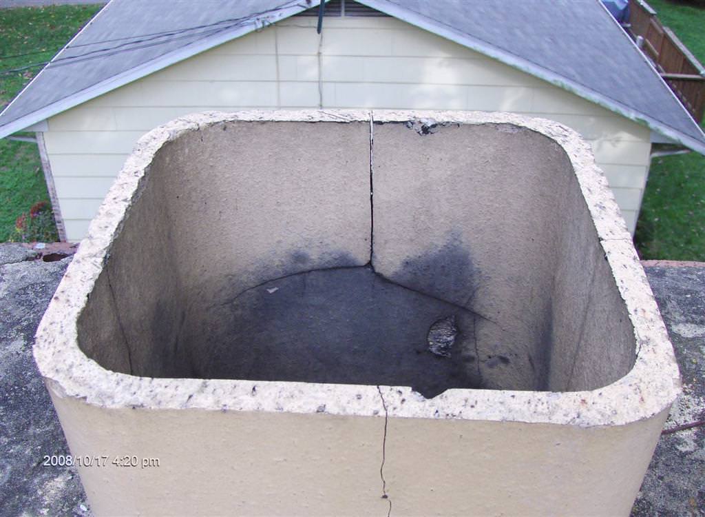

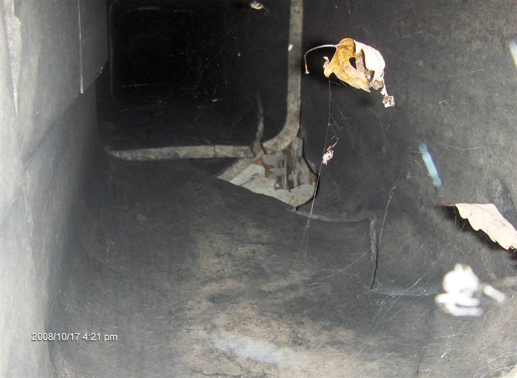

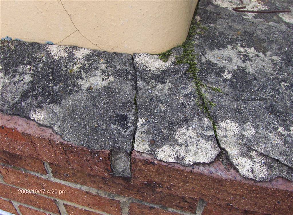

John Dirks Jr Posted October 21, 2008 Report Share Posted October 21, 2008 Does the cracked crown cause the damage to the liner? If not, what do you think caused the damaged liner? Image Insert: 229.86 KB Image Insert: 128.09 KB Image Insert: 103.2 KB Quote Link to comment Share on other sites More sharing options...
Tim H Posted October 21, 2008 Report Share Posted October 21, 2008 Hi John, It is possible that water penetrated the cracks in the crown, and then froze (and expanded). The expansion moved the crown, and the crown then crushed the flue liner. Tim Quote Link to comment Share on other sites More sharing options...
Chad Fabry Posted October 21, 2008 Report Share Posted October 21, 2008 The mason didn't use a bond breaker between the flue and the crown. When the cap cured it bonded to the flue. When the flue gets hot it gets taller and the whole mess, flue, crown et al moves up and down. Masonry is, as a rule, opposed to being moved around. Quote Link to comment Share on other sites More sharing options...
Tim H Posted October 21, 2008 Report Share Posted October 21, 2008 Originally posted by Chad Fabry The mason didn't use a bond breaker between the flue and the crown. When the cap cured it bonded to the flue. When the flue gets hot it gets taller and the whole mess, flue, crown et al moves up and down. Masonry is, as a rule, opposed to being moved around. D'oh. As they say around this part of the country; "if it was a snake, it would have bit me". Tim Quote Link to comment Share on other sites More sharing options...

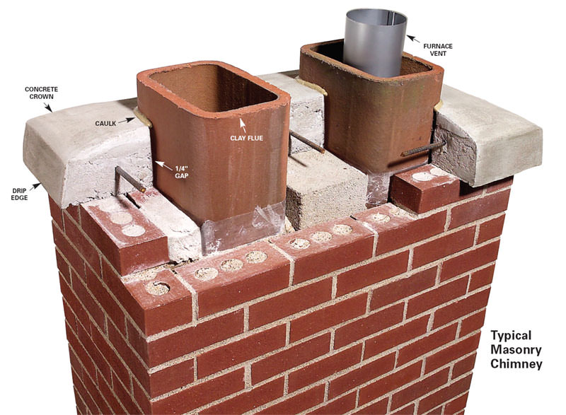

Brian G Posted October 22, 2008 Report Share Posted October 22, 2008 All chimney caps look like that around here, but damaged flue liners are very rare. Would lack of a bond breaker normally damage the second liner section too? What does a bond breaker typically look like? Got a photo, anybody? John, your lack of over-sensitivity to constructive criticism continues to serve you well (and others). Keep it up. Brian G. Circuit Breaker, Vacuum Breaker, and Now Bond Breaker [:-crazy] Quote Link to comment Share on other sites More sharing options...
Bill Kibbel Posted October 22, 2008 Report Share Posted October 22, 2008 Originally posted by Brian G What does a bond breaker typically look like? Got a photo, anybody? I can show you what it's supposed to look like. I've never seen one actually done (most chimneys I see don't have flue liners and the few that do, never, ever have the break). Quote Link to comment Share on other sites More sharing options...
Chad Fabry Posted October 22, 2008 Report Share Posted October 22, 2008 What does a bond breaker typically look like? Got a photo, anybody? Around here most masons that are aware of the issue use a piece of felt between the crown and flue. Pretty much anything that prevents the two from sticking together works well. There are products specifically intended for use as a bond breaker in other areas like between the house foundation and the garage slab. I've seen literally dozens of homes where the top course of block was lifted because it was attached to slab and the edge curl levitated the whole shebang by a 1/4 inch or more. Anyway, I should have tempered my remark by inserting a 'maybe' or an 'it's likely' somewhere. I see tons of chimneys just like the one in John's photo and the root of most broken crowns and flues is poor building practices; especially the lack of bond breakers. Quote Link to comment Share on other sites More sharing options...

Bain Posted October 22, 2008 Report Share Posted October 22, 2008 The other best practice being ignored in John's photo is that the crown is mortar, not concrete. Mortar is porous and absorbs water, which of course expands when it freezes and exacerbates and/or causes the cracks in the photo. Quote Link to comment Share on other sites More sharing options...
