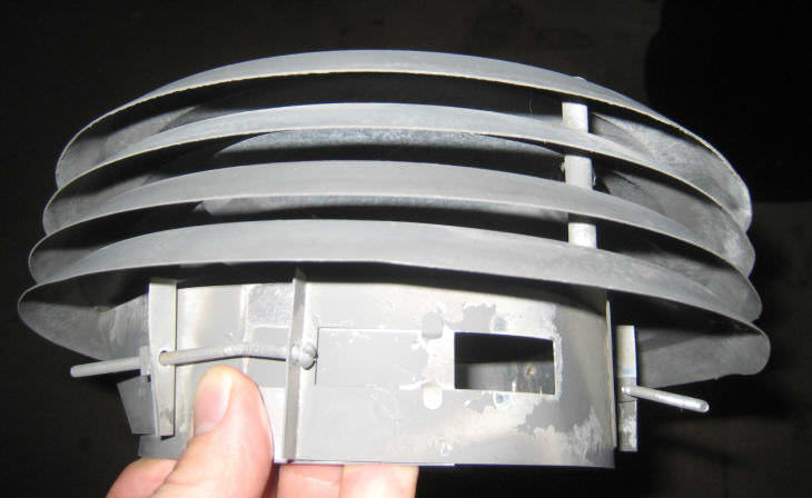

brianross Posted October 26, 2008 Author Report Share Posted October 26, 2008 An update: We now have heat. Found a good HVAC guy and he confirmed that furnace exhaust blowing out the top of your hot water heat vent is not a good way to raise a healthy family. Long story short is that the furnace flue was not chock full of squirrels, birds or other foreign matter (we checked it from the bottom up and from the roof down). However, the roofers had installed a cosmetically nice vent cap which was preventing the flue to draft. Image Insert: 44.86 KB For now there is no vent cap and plenty of good draft. My HVAC guy noted that over half of my neighbors have the same vent cap (same roofing company replaced most of the roofs after a May storm) and wondered aloud if most people would even notice anything like I did. Thoughts on this? I could see this being somewhat common - most roofing crews aren't considering proper venting while they are slapping down the hot tar up there. Roofer actually called back and said he would be right over. Must have gotten in an accident or something because he never made it. I hope he is OK! I still need to rule out a leak at the storm collar and will keep on the roofer (not to mention I would like to cap the flue before I actually have birds in there), but I think my main intention for this post is resolved so I probably will not update further unless there is interest. Again, thanks to all on this site. I found it fun and informative to interact with you guys. B Quote Link to comment Share on other sites More sharing options...
msteger Posted October 27, 2008 Report Share Posted October 27, 2008 Thanks for sharing your story with us and keeping us updated. Its always fun watching contractors from one discipline screw up a system of another discipline. Quote Link to comment Share on other sites More sharing options...
hausdok Posted October 27, 2008 Report Share Posted October 27, 2008 Hi, Perhaps a letter to the manufacturer of the pretty vent bonnet would be a good idea. They should know about this sort of thing before it kills someone. OT - OF!!! M. Quote Link to comment Share on other sites More sharing options...
