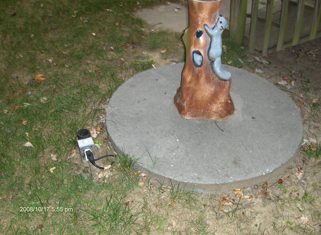

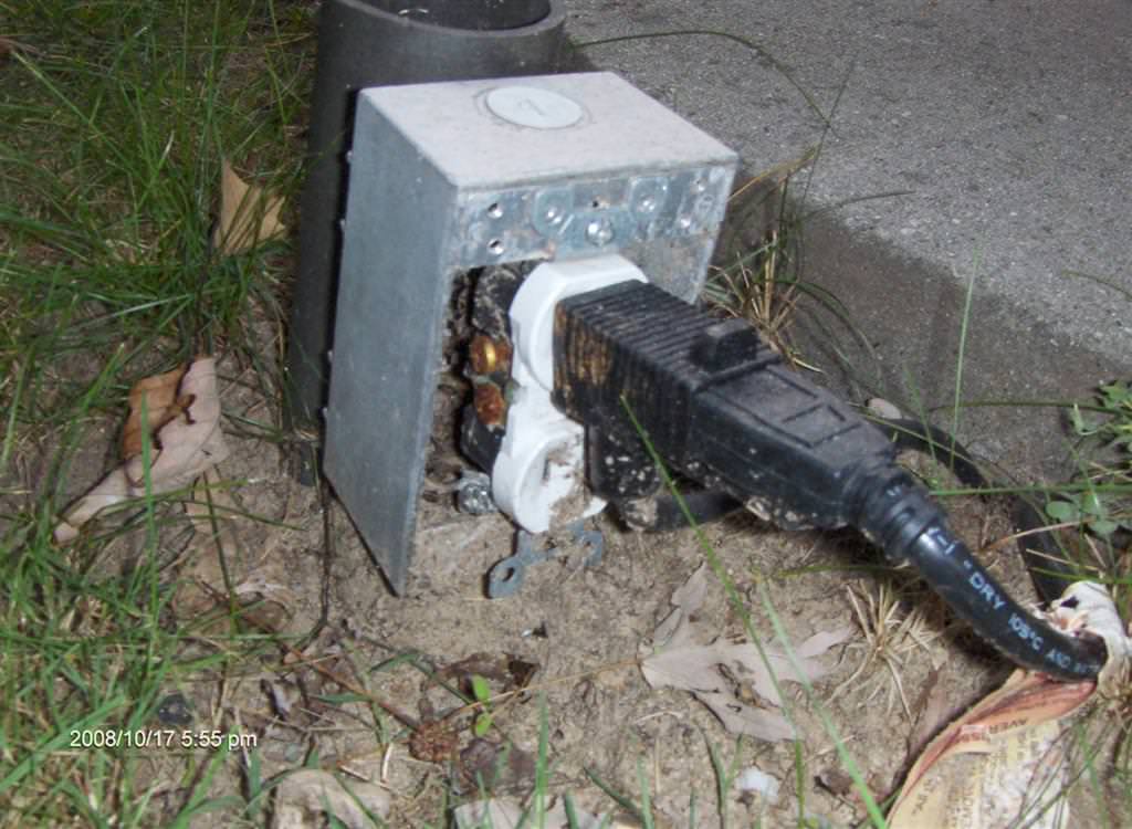

John Dirks Jr Posted October 23, 2008 Report Share Posted October 23, 2008 I wrote up the receptacle arrangement as not being suitable for a wet exterior loction. I'm not quite sure what the cord serves though. It goes in under the concrete lid. Whats's going on here? Image Insert: 150.08 KB Image Insert: 167.9 KB Quote Link to comment Share on other sites More sharing options...
Chad Fabry Posted October 23, 2008 Report Share Posted October 23, 2008 The cord is a sump pump cord. You can tell by the funky double plug head thingy that connects to the float switch. It's likely a de-watering pump. Or an electric squirrel killin' machine. Either one. Quote Link to comment Share on other sites More sharing options...
Jerry Simon Posted October 23, 2008 Report Share Posted October 23, 2008 Septic lift-station pump cord. Lift station collects effluent, pump pumps it up to highest point of septic field. Gravity does the rest. Quote Link to comment Share on other sites More sharing options...
John Dirks Jr Posted October 23, 2008 Author Report Share Posted October 23, 2008 Lift pump is what I thought it was. At least that's what came out of my mouth when the client was standing next to me. I guessed that one right. How would one test a pump like that? I couldn't find a well head anywhere in the yard. I saw them in the neighbors yards, but not this one. What's up with that? Quote Link to comment Share on other sites More sharing options...
Chad Fabry Posted October 23, 2008 Report Share Posted October 23, 2008 Septic lift-station pump cord. Lift station collects effluent, pump pumps it up to highest point of septic field. Gravity does the rest. I've never seen one outside. Is that a normal thing around your area Jerry? Quote Link to comment Share on other sites More sharing options...
Les Posted October 23, 2008 Report Share Posted October 23, 2008 Around here we have lots of buried well heads. Test by bypassing the switch plug. Quote Link to comment Share on other sites More sharing options...
davidlord Posted October 23, 2008 Report Share Posted October 23, 2008 I don't quite understand your relation of the well head to a septic sump pump. In these parts its not uncommon to have a municipal water source and a septic system. We are fortunate enough to orient our drain fields to resemble elephant burial mounds. Your picture is typical of most sump pump outlet installations. Quote Link to comment Share on other sites More sharing options...
Les Posted October 23, 2008 Report Share Posted October 23, 2008 David, In Mid-Michigan it is quite common to have sewers and private wells. It is less common to have public water and septic systems. I agree it looks like a sump pit and pump. Quote Link to comment Share on other sites More sharing options...
Jeremy Posted October 23, 2008 Report Share Posted October 23, 2008 Originally posted by John Dirks Jr Lift pump is what I thought it was. At least that's what came out of my mouth when the client was standing next to me. I guessed that one right. How would one test a pump like that? I couldn't find a well head anywhere in the yard. I saw them in the neighbors yards, but not this one. What's up with that? With no visible well head in the yard or basement, you can't rule out the possibility of a shared well, wich would obviously create numerous concerns. I think it is unlikely that the picture represents a well head. Is there any water equipment(bladder, switch, gauge, etc.) inside the home that would suggest that the water comes from a private source? Quote Link to comment Share on other sites More sharing options...
carle3 Posted October 23, 2008 Report Share Posted October 23, 2008 It may be a shared well. In this case the well could be in the neighboring lot. Was there a pressure tank on the property? A pit that was well hidden could account for no visible casing or pump house. In our area well pits are being forced out and would be good information for ones client. Another location is in the basement, if you have them. These are commonly point wells which are out of favor in our locality and another good mention for ones clients. Most lending institutions will approve lending on a home with a point well. I would stay away from any comments on the septic system. The electric is a good observation but the evalution of the pump would be stepping out from under your home inspector 's hat and putting on a new septic inspector's hat. Unless you want to wear that hat, not recommended. Quote Link to comment Share on other sites More sharing options...
Jerry Simon Posted October 23, 2008 Report Share Posted October 23, 2008 Originally posted by Chad Fabry Septic lift-station pump cord. Lift station collects effluent, pump pumps it up to highest point of septic field. Gravity does the rest. I've never seen one outside. Is that a normal thing around your area Jerry? Chad...most every septic lift-station in these parts is outside, and that sure looks exactly like such...right down to the dual pump cords. In another life/dimension, I had the pleasant task of overseeing the repairs for about 45 septic fields that had all failed, most for different reasons. I've had a lot of experience with that kind of sh*t. John...you could test the pump by bypassing the switch cord-plug and plugging the pump cord-plug directly into the receptacle. Quote Link to comment Share on other sites More sharing options...
Tom Raymond Posted October 23, 2008 Report Share Posted October 23, 2008 Uh...if that is a lift pump shouldn't it have an alarm? Otherwise the crap comes out the lowest drain in the house before you realise there is a problem with the pump. Tom Quote Link to comment Share on other sites More sharing options...
Jerry Simon Posted October 23, 2008 Report Share Posted October 23, 2008 Originally posted by Tom Raymond Uh...if that is a lift pump shouldn't it have an alarm? Otherwise the crap comes out the lowest drain in the house before you realise there is a problem with the pump. Tom Yes. Such alarms, at least 'round here, are located inside the house. Quote Link to comment Share on other sites More sharing options...

Scottpat Posted October 26, 2008 Report Share Posted October 26, 2008 I will vote for a septic lift station. Very common in my parts and they look like that. Some have an alarm on the inside of the home and some on the outside. The ones on the exterior tend to be on newer homes. But, if you're not 100% sure just simply say that you are not sure what the heck it is and that the owners need to be questioned about it. That's about all you really need to say, outside of the electrical connection. Quote Link to comment Share on other sites More sharing options...
