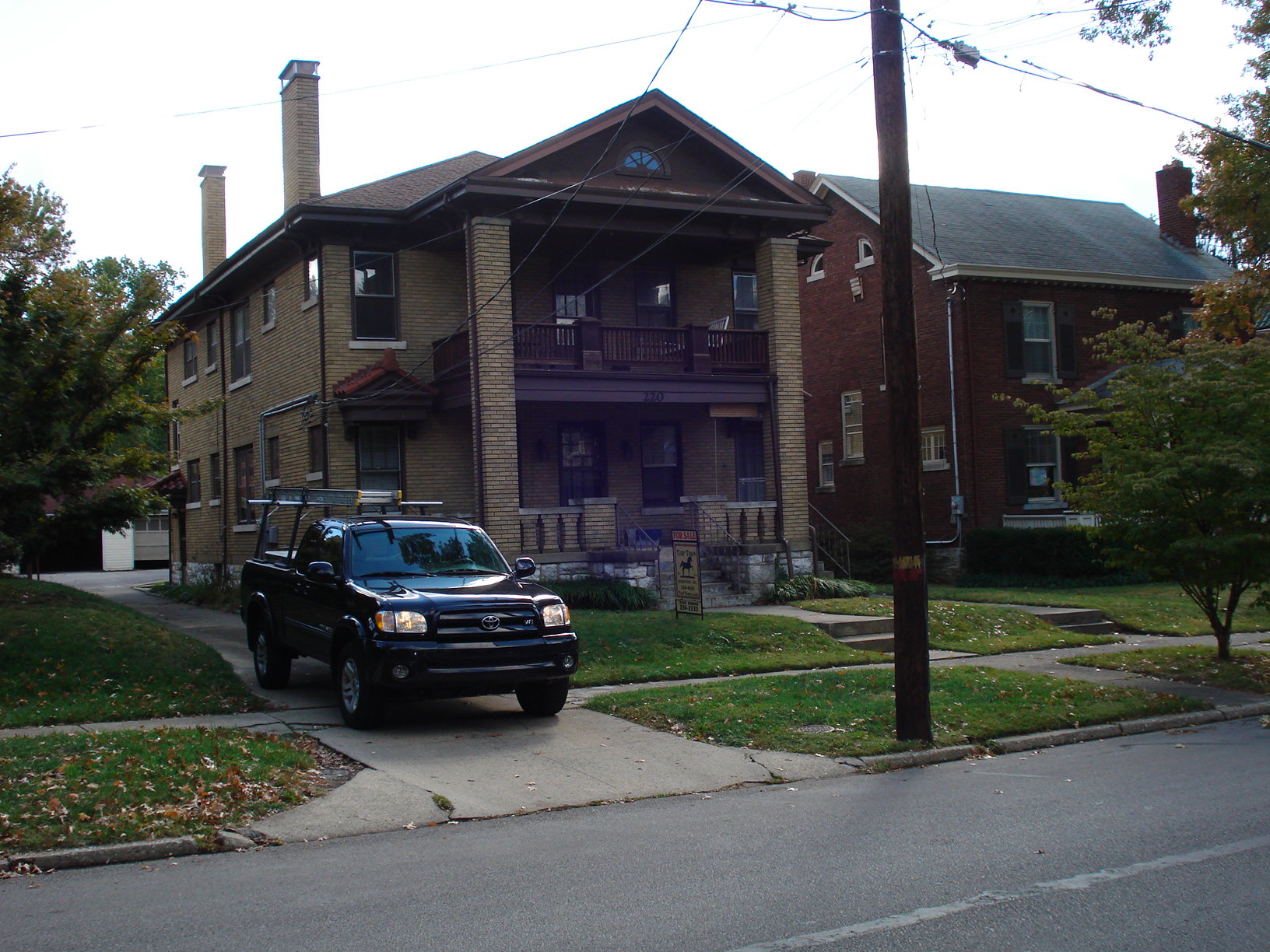

Bain Posted October 25, 2008 Report Share Posted October 25, 2008 I looked at a duplex today, and both panels--one for up, one for down--contained a wicked melted SE cable. My first thought was that the exterior pigtail to the service drop was loose. But the three cables weren't connected at the same point. One panel was tied into the bottom of the service-drop cable, while the second was connected eight or ten inches upstream. I didn't take a photo of the service drop, but you can sort of see it above my truck in the last photo. I realize the burned cables could have loose connections in the panels, but that seems too coincidental. Any ideas? Image Insert: 836.88 KB Image Insert: 859.08 KB Image Insert: 886.82 KB Quote Link to comment Share on other sites More sharing options...
Jim Katen Posted October 25, 2008 Report Share Posted October 25, 2008 Originally posted by Bain I looked at a duplex today, and both panels--one for up, one for down--contained a wicked melted SE cable. My first thought was that the exterior pigtail to the service drop was loose. But the three cables weren't connected at the same point. One panel was tied into the bottom of the service-drop cable, while the second was connected eight or ten inches upstream. I didn't take a photo of the service drop, but you can sort of see it above my truck in the last photo. I realize the burned cables could have loose connections in the panels, but that seems too coincidental. Any ideas? If the burning is only near the connection, that almost always means that the connection is or was loose. If the same electrician wired both units at the same time, it isnt' unusual for him to have made the same error. - Jim Katen, Oregon Quote Link to comment Share on other sites More sharing options...

Kyle Kubs Posted October 27, 2008 Report Share Posted October 27, 2008 Originally posted by Jim Katen Originally posted by Bain I looked at a duplex today, and both panels--one for up, one for down--contained a wicked melted SE cable. My first thought was that the exterior pigtail to the service drop was loose. But the three cables weren't connected at the same point. One panel was tied into the bottom of the service-drop cable, while the second was connected eight or ten inches upstream. I didn't take a photo of the service drop, but you can sort of see it above my truck in the last photo. I realize the burned cables could have loose connections in the panels, but that seems too coincidental. Any ideas? If the burning is only near the connection, that almost always means that the connection is or was loose. If the same electrician wired both units at the same time, it isnt' unusual for him to have made the same error. - Jim Katen, Oregon Agreed. (As if Katen needs my support) - Note that all three main lugs have the screws heads stripped out. There was an amateur afoot, or a careless pro. Quote Link to comment Share on other sites More sharing options...
kurt Posted October 27, 2008 Report Share Posted October 27, 2008 No anti-oxidant paste either. What's that stuff called again? My feeble brain is blanking. Also, ask Katen what he found in a crawlspace a few years back....... Quote Link to comment Share on other sites More sharing options...
