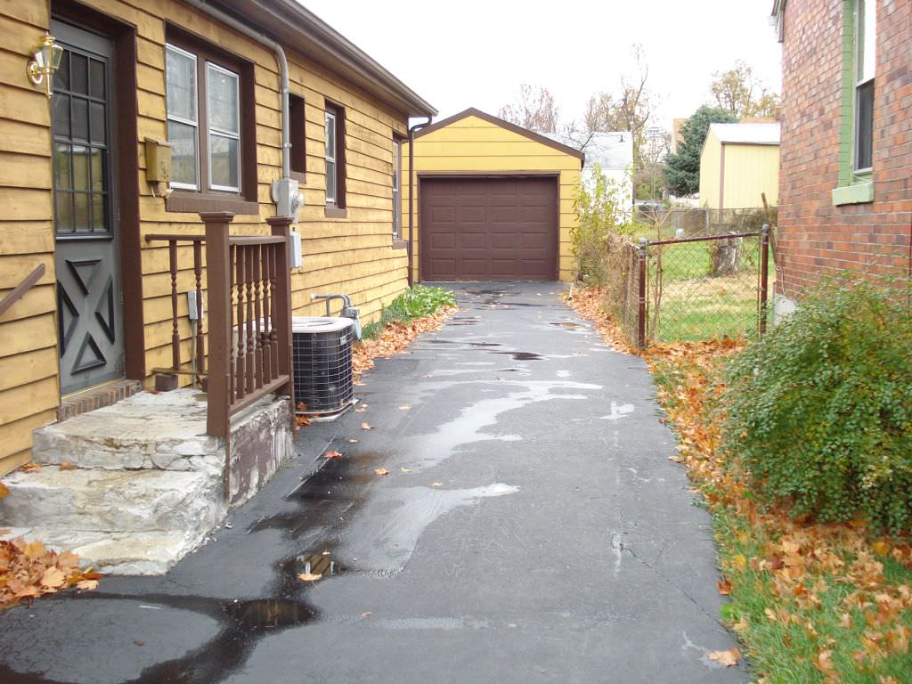

Bain Posted November 17, 2008 Report Share Posted November 17, 2008 Do you think it'll provide adequate protection for the gas meter? Image Insert: 191.37 KB Quote Link to comment Share on other sites More sharing options...
hausdok Posted November 18, 2008 Report Share Posted November 18, 2008 Looks like there might be just a wee bit of adverse possession going on there. Bet if the neighbor has a survey done the line will carve a bit off that driveway. So, veneer brick house with a layer of clapboard siding applied over the veneer? ONE TEAM - ONE FIGHT!!! Mike Quote Link to comment Share on other sites More sharing options...

Bill Kibbel Posted November 18, 2008 Report Share Posted November 18, 2008 It would only take my wife a couple days to take out the porch. Then on day three, she would bulldoze the condensing unit into the gas meter. The scary part is that it would be on purpose. Quote Link to comment Share on other sites More sharing options...
Bain Posted November 18, 2008 Author Report Share Posted November 18, 2008 Originally posted by hausdok Looks like there might be just a wee bit of adverse possession going on there. Bet if the neighbor has a survey done the line will carve a bit off that driveway. So, veneer brick house with a layer of clapboard siding applied over the veneer? ONE TEAM - ONE FIGHT!!! Mike Mike, You are, as my Father used to say, a smart sumbitch. I realize the depths of the hideous brown casings sort of give it away. But I was there, and had to convince myself that someone would actually cover brick veneer with wooden siding. Quote Link to comment Share on other sites More sharing options...
hausdok Posted November 18, 2008 Report Share Posted November 18, 2008 Originally posted by BainMike, You are, as my Father used to say, a smart sumbitch. Not really, the deeply inset windows and doors and the soldier rows of bricks at the window sills and doorthreshold gave it away right away. Besides, you can see the mirror image of the sill on the house on the right. There's a town here called Mountlake Terrace that was built after WWII to house returning GI's who're going to work for Boeing and other big manufactucturers here. Most of the original homes are CMU and a whole lot of them are covered up with all manners of siding. ONE TEAM - ONE FIGHT!!! Mike Quote Link to comment Share on other sites More sharing options...
Mike Lamb Posted November 18, 2008 Report Share Posted November 18, 2008 Pulling into the garage. Probably. Backing out. NO. I sank posts next to my meter after my wife took it off the side of the house one 20 degree January evening. The fire dept came and set up this huge fan while a guy capped the pipe. By 2 AM the gas company had a new meter in. I was impressed. And no charge. Quote Link to comment Share on other sites More sharing options...
