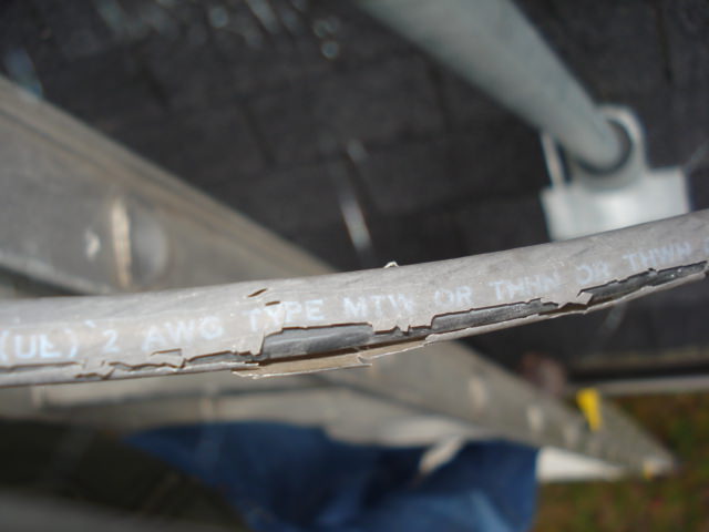

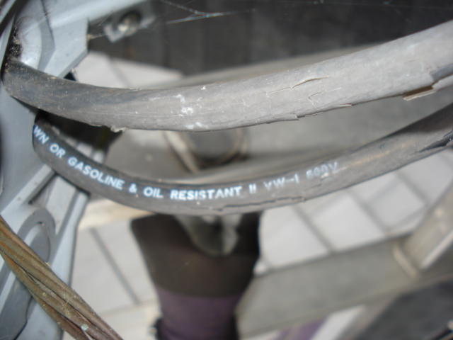

randynavarro Posted November 18, 2008 Report Share Posted November 18, 2008 I don't see any markings indicating these service cables are rated for exposure to the sun (which they are in this installation). As the plastic / nylon jacket is deteriorating, it appears they're NOT rated for sunlight. Am I missing something? Image Insert: 132.18 KB Image Insert: 117.92 KB Quote Link to comment Share on other sites More sharing options...
hausdok Posted November 18, 2008 Report Share Posted November 18, 2008 Hi Randy, My Hansen's says that it's alright for that purpose, however that doesn't look like SEU, SER or URD type cable although it's hard to tell from the picture. OT - OF!!! M. Quote Link to comment Share on other sites More sharing options...
Bill Kibbel Posted November 19, 2008 Report Share Posted November 19, 2008 MTW - Machine Tool Wire, dry locations THHN - Thermoplastic insulation, dry locations THWN - Thermoplastic insulation, wet locations All the above would be marked "SUNLIGHT RESISTANTâ⬠Quote Link to comment Share on other sites More sharing options...
Bill Kibbel Posted November 19, 2008 Report Share Posted November 19, 2008 Here it is: www.ul.com/regulators/W&CMG_April2007_Final.pdf Quote Link to comment Share on other sites More sharing options...
