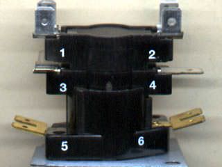

newguy Posted December 15, 2008 Report Share Posted December 15, 2008 No I meant sequencers, i am trying to figure out how to load a picture. Here is a brief discription. The terminals at the base are the 24 volt ac. control inputs. Caution: some Lennox Furnaces have sequencers with 240 volt inputs. The specs on the top of the unit indicate the the first stage is "first on last off" and the second stage is "last on and first off" Some setups the sequencer also controls the blower fan in the unit. Units with more elements will have additional sequencers that are "last on" first off". Then I found this Different manufacturers use different devices, some use contactors, while others will use relays or sequencers. Some use a combination of contactors and sequencers to activate a second stage heat bank. Which leads us to a noisy relay or contactor. Image Insert: 15.86 KB Quote Link to comment Share on other sites More sharing options...
Terence McCann Posted December 15, 2008 Report Share Posted December 15, 2008 The original question was regarding a Trane unit and I'm pretty sure they don't use sequencers. Quote Link to comment Share on other sites More sharing options...
