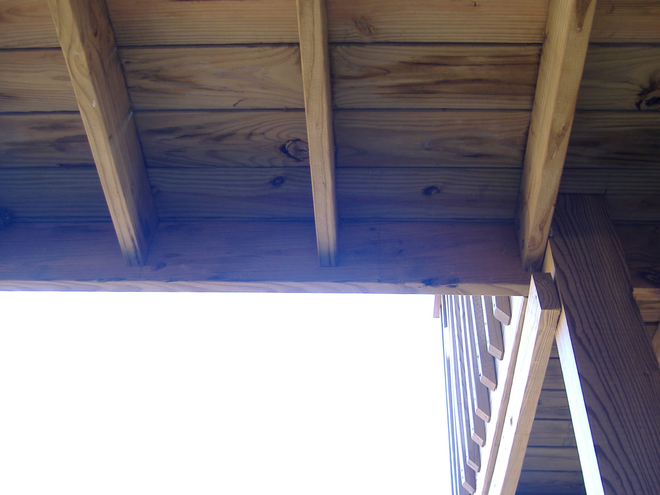

bghi Posted December 5, 2008 Report Share Posted December 5, 2008 Is there a requirement to use joist brackets on both ends on deck floor joist. I would think you would want them and plan to recommend upgrading for safety reasons. any thoughts? Image Insert: 1165.25 KB Quote Link to comment Share on other sites More sharing options...

Richard Moore Posted December 5, 2008 Report Share Posted December 5, 2008 You want joist hangers at the ledger board attached to the house, but the most commonly designed deck is cantilevered at the outboard side and has the joists resting on and supported by a beam. The joists are then supporting the rim joist which is typically just nailed. Hangers don't work well when the forces are reversed. There are, of course, different and more complex designs. Basically, if a joist is attached to a supporting member, then it should have a hanger at that point...but not if it is itself providing support. That make sense? There are tie-downs and other "strong-ties" that might be used in places, but I'm assuming you were talking about joist hangers. There's this which is a good read... http://www.awc.org/Publications/DCA/DCA6/DCA6.pdf And/or go down to the big box store and get yourself a "how to" book on decks. They cover most common designs. Quote Link to comment Share on other sites More sharing options...
bghi Posted December 5, 2008 Author Report Share Posted December 5, 2008 Thanks for the information I hope the picture helps. Great web site Thanks for the link Quote Link to comment Share on other sites More sharing options...
Acorn Home Posted December 5, 2008 Report Share Posted December 5, 2008 Originally posted by bghi Image Insert: 1165.25 KB Is the 2x4 attached to the post also supporting the weight of the other deck (where the balusters are)? Quote Link to comment Share on other sites More sharing options...
Brandon Whitmore Posted December 5, 2008 Report Share Posted December 5, 2008 Is there a better pic of that deck. I am curious as to whether those joists are cantilevered out. If there is no cantilever, that is wrong. If there is a cantilever, joist hangers would not be necessary as the beam would carry the load, and the header joist would prevent later movement of the joists. That 2x does not qualify as a beam. Quote Link to comment Share on other sites More sharing options...
