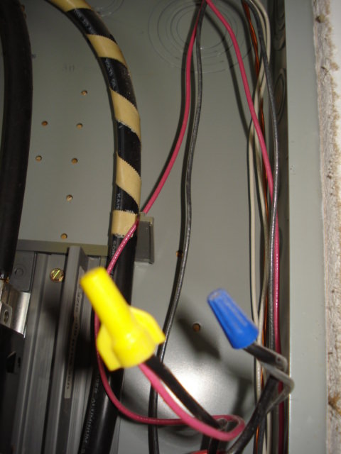

randynavarro Posted December 13, 2008 Report Share Posted December 13, 2008 The pic may or not help. Hopefully, it's pretty easy to understand. The homeowner has re-wired so that each leg of the multiwire circuit feeds of off two of the generator switching panel's circuits. Does this create the potential for overloading the neutral? Image Insert: 162.17 KB Quote Link to comment Share on other sites More sharing options...

randynavarro Posted December 13, 2008 Author Report Share Posted December 13, 2008 Multi wire circuit (red and black wires in the pic). Disconnect the hot legs from the breakers. Now connect each of those wires to the two incoming wires from the generator switch (in the photo, the larger black #12 wires under the wire nuts are from the generator switch). Does this help? Quote Link to comment Share on other sites More sharing options...
inspector57 Posted December 13, 2008 Report Share Posted December 13, 2008 Depends if the generator wires are separate phases. 240 volts between the two hots and 120 volts from each hot to neutral means the two hots are from separate phases and would be ok if all other switches, etc. are done properly. Quote Link to comment Share on other sites More sharing options...
Jeff Remas Posted December 13, 2008 Report Share Posted December 13, 2008 I prefer to see multi-wire circuits fed from double pole breakers. If they are part of the generator panel then the should still be hooked up to a double pole breaker or you need to make sure that they are fed from separate phases as stated in the above post. Quote Link to comment Share on other sites More sharing options...
Jim Katen Posted December 13, 2008 Report Share Posted December 13, 2008 Originally posted by randynavarro Multi wire circuit (red and black wires in the pic). Disconnect the hot legs from the breakers. Now connect each of those wires to the two incoming wires from the generator switch (in the photo, the larger black #12 wires under the wire nuts are from the generator switch). Does this help? What Jim & Jeff said. Different poles ok. Same pole bad. - Jim Katen, Oregon Quote Link to comment Share on other sites More sharing options...

Inspectorjoe Posted December 13, 2008 Report Share Posted December 13, 2008 Originally posted by randynavarro I guess the next question then: is anyone familiar with the GenTran switch boxes that can be purchased at H. Depot? Or any generators for that matter. Are there different poles in generators? I assumed there wasn't but what do I know. . . I installed one in my house two years ago. The generator panel is fed from a two pole breaker in the main panel (and also from the the 2 pole 4 wire feed from the generator, through a rubber cord). The branch circuit hots are disconnected from the breakers in the main panel and wire nutted to pigtails that connect to the breakers in the generator panel. The two panels are bonded. The only neutral in the generator panel is from the generator as it passes through the enclosure and on to the neutral/ground bus bar in the main panel. Gen-Tran manual My installation Quote Link to comment Share on other sites More sharing options...
Chad Fabry Posted December 13, 2008 Report Share Posted December 13, 2008 Are there different poles in generators? I assumed there wasn't but what do I know. . . Sure, if it's a 120/240 volt unit. Quote Link to comment Share on other sites More sharing options...
