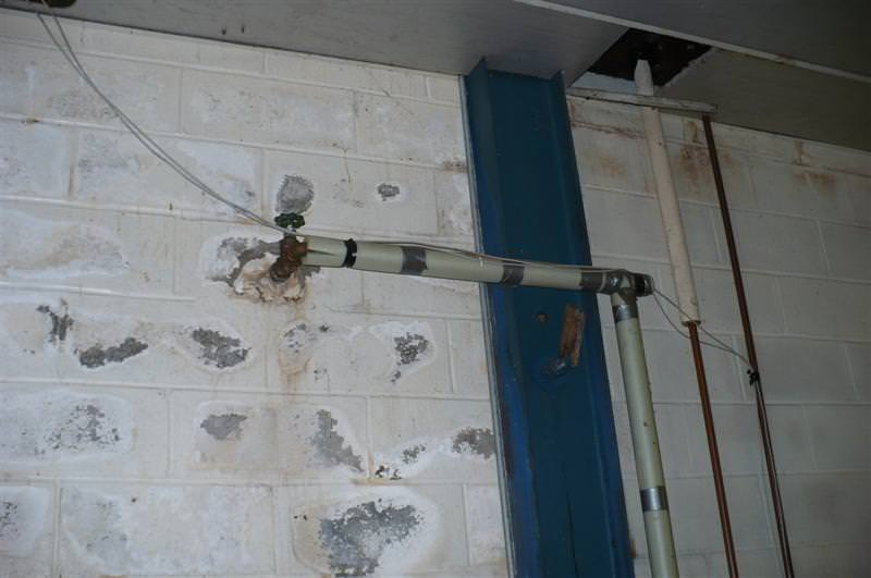

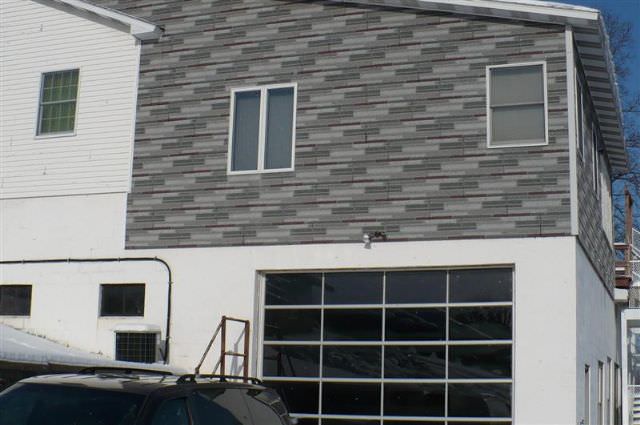

gtblum Posted December 15, 2008 Report Share Posted December 15, 2008 First pic shows the main line in. The second shows the meters for the home and an inlaw apt. The line before the meter feeds a giant commercial type garage below the home. You motor heads would love this. Air lines, a lift, overhead door like a service dept, ect. Image Insert: 53.26 KB Image Insert: 50.85 KB Image Insert: 75.25 KB Quote Link to comment Share on other sites More sharing options...
SWagar Posted December 15, 2008 Report Share Posted December 15, 2008 I noticed the meters inside this building, was there another meter in the Garage? The solder on the pipes looks to be all about the same vintage. That valve is turned off, any idea where the pipe went? Quote Link to comment Share on other sites More sharing options...
Ken Meyer Posted December 15, 2008 Report Share Posted December 15, 2008 Is there a meter out by the street, or are all the meters in your area inside? If they are inside, someone has to come in to read them, and they would see an unmetered connection. Could it be that the 2 meters are there for the homeowner to keep track of water use for the apartment and the home separately? Quote Link to comment Share on other sites More sharing options...

gtblum Posted December 15, 2008 Author Report Share Posted December 15, 2008 There are no outside meters. I hate to admit this but, I'm not even sure how I'm charged. my meter is inside like these and nobody shows up here to read it. The utilitys are read by drive by (sensor on the house) but, I don't know about the water. Guess I'd better call them LOL. Quote Link to comment Share on other sites More sharing options...
Brandon Whitmore Posted December 15, 2008 Report Share Posted December 15, 2008 If there are no other meters upstream, then the water is free to the shop and free (stolen) to the hose bib at the end of the line as shown in the pic. Quote Link to comment Share on other sites More sharing options...
gtblum Posted December 15, 2008 Author Report Share Posted December 15, 2008 Just got off the phone with the water utility. They use electronic sensors as well and they service that property. Looks like there's a problem. Now to report it to my client without starting a war with the home owner. HMM Quote Link to comment Share on other sites More sharing options...
