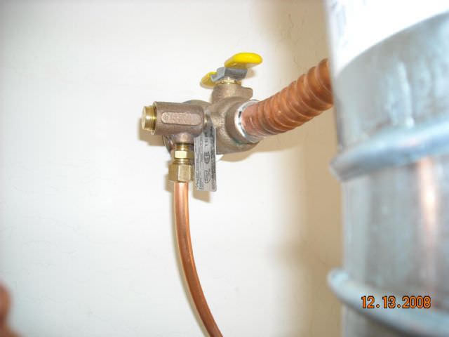

Tim H Posted December 23, 2008 Report Share Posted December 23, 2008 I have never seen this before and I can't figure out what they were trying to accomplish. Any ideas? Thanks-Tim Click to View 38.57 KB Quote Link to comment Share on other sites More sharing options...

SWagar Posted December 23, 2008 Report Share Posted December 23, 2008 Not only is that goofy, it is one big accident waiting to happen. I don't know what the pressure/burst rating is for CPVC pipe. If the water heater overpressurized it would more than likely burst the pipe. Something would have to give, the pipe would be the weak point. Then one would have one big mess! Quote Link to comment Share on other sites More sharing options...
Richard Saunders Posted December 23, 2008 Report Share Posted December 23, 2008 I think that is a relief valve for thermal expansion incorporated in the shut off valve (takes the place of an expansion tank). Granted, it shouldn't be teed to the T&P drain but normally, there would not be any water flow through it. Quote Link to comment Share on other sites More sharing options...
Richard Saunders Posted December 23, 2008 Report Share Posted December 23, 2008 Here's one Click to View 24.28 KB Quote Link to comment Share on other sites More sharing options...
SWagar Posted December 23, 2008 Report Share Posted December 23, 2008 I thought what I was seeing in the photo was that the CPVC pipe fed the cold inlet and was Tee'd to the TPR valve. But after closer inspection, the CPVC TPR drain pipe just has the copper pipe from the cold water shut off connected to it. So I'd have to agree it is for thermal expansion. Was there a pressure reducing valve or backflow preventer installed on the water main? Was this house on a well? In general, I thought most thermal expansion is dissipated by the cold water plumbing from the water heater back toward the water supply, unless there is a device preventing water flow back toward the supply. Quote Link to comment Share on other sites More sharing options...

Richard Saunders Posted December 24, 2008 Report Share Posted December 24, 2008 This valve arrangement seems to be the new way to go. The valve should have a separate drain line to the exterior. Probably cheaper than a tank and may last longer. Quote Link to comment Share on other sites More sharing options...
