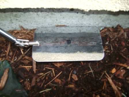

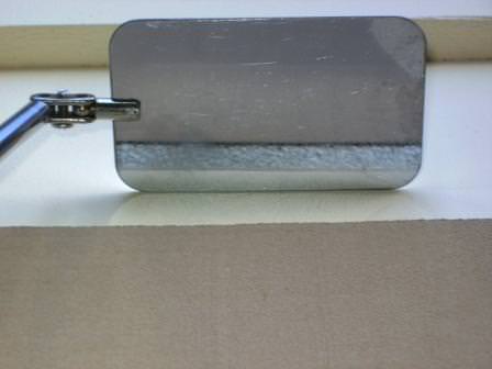

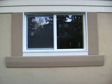

Ponyboy Posted January 3, 2009 Author Report Share Posted January 3, 2009 Below are some pictures of the exterior stucco application. The stucco is a one coat system applied directly to the brick. A primer/sealer was applied to the brick prior to the stucco being applied. The Dryvit acrylic top coat was then applied over the stucco. All of the original brick weep holes have been filled, but this should be ok since the acrylic is waterproof. This application looked ok. EIFS trim is installed around the windows. The trim is just glued on top of the stucco and was not blended into the stucco system. The top and bottom ends of the vertical trim are not backwrapped and a finish coat was not applied over the base coat. I think the trim installation was real cheap. The brick around the windows is wrapped with a plastic trim product. Caulking of the trim was minimal and some trim pieces covered the window weep holes. What do you think? Click to View 64.86 KB Click to View 40.28 KB Click to View 39.77 KB Click to View 36.44 KB Quote Link to comment Share on other sites More sharing options...

hausdok Posted January 3, 2009 Report Share Posted January 3, 2009 Brad, I've looked at it for the past 20 minutes and I still can't figure out what I'm seeing in that center picture. Guess I need to go drink another cuppa before I try again. ONE TEAM - ONE FIGHT!!! Mike Quote Link to comment Share on other sites More sharing options...
Ponyboy Posted January 4, 2009 Author Report Share Posted January 4, 2009 Hey Mike, The third picture down is the top edge of the vertical side pant-ons at all the windows. The top and bottom edges are not back wrapped. The bottom picture shows the mesh sticking out of the base coat of the ppant-on and the finish of the plant-ons. All are only base coated, not finish coat. Writing the report this morning. The roof was also just grand. New install 50 year shingle with improper layout. Exposed shingle butt joints across the entire roof. Originally posted by hausdok Brad, I've looked at it for the past 20 minutes and I still can't figure out what I'm seeing in that center picture. Guess I need to go drink another cuppa before I try again. ONE TEAM - ONE FIGHT!!! Mike Quote Link to comment Share on other sites More sharing options...
