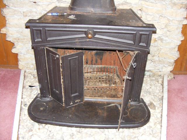

Jeff Beck Posted January 2, 2009 Report Share Posted January 2, 2009 I see about one wood burning stove every four years so this isn't my strongest area [:-dunce]. The clearance on the back of the stove is probably no more that 8". The back wall is a happy homeowner special with various rock types mortared together. There is nothing behind the stone but wood paneling. There is about an 18" clearance on the front pan. The stove sits in a framed area that is filled with river rock which sits on the sub-floor. There is only 4" to 6" clearance on either side of the stove. There are other issues with the flue but I'm not sure of the placement of the stove and the use of the loose stones being both safe or meeting codes. Please help with your opinion of this install. Thanks, Jeff Beck Foresight Home Inspection Click to View 65.19 KB Quote Link to comment Share on other sites More sharing options...

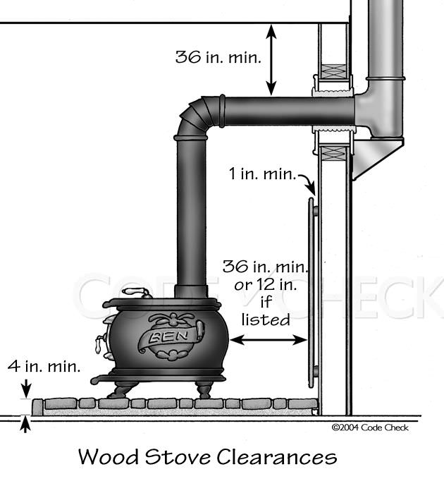

Terence McCann Posted January 2, 2009 Report Share Posted January 2, 2009 Hey Jeff, you ever play with the Yardbirds? Heard that one before eh? Attached is a CodeCheck pic of wood stove clearances. Check with the manufacture too. They have clearances in the install manual. Click to View 50.66 KB Quote Link to comment Share on other sites More sharing options...
AHI in AR Posted January 3, 2009 Report Share Posted January 3, 2009 I rarely see freestanding stoves either, but based on my experience in installing a couple different ones, your install is all wrong. Typically, the side hearth extensions need to be larger. The rear clearance is also seriously inadequate -- especially without any heat shield either on the stove or behind the stone. Keep in mind that while the rock won't burn, with extended run times, heat soak will occur and the paneling behind it could ignite. Also, I can't see that loose stones would qualify as a noncombustible hearth extension since embers could make their way down between the stones to a combustible wood floor below -- if that's what you have. That may be a vintage unit with no manual available. Even without one, there are a lot of obvious issues and referring it to an expert would be prudent. Quote Link to comment Share on other sites More sharing options...
Jim Katen Posted January 3, 2009 Report Share Posted January 3, 2009 Originally posted by Jeff Beck I see about one wood burning stove every four years so this isn't my strongest area [:-dunce]. The clearance on the back of the stove is probably no more that 8". The back wall is a happy homeowner special with various rock types mortared together. There is nothing behind the stone but wood paneling. That's a very old wood stove. It probably dates from the late '70s and is almost certainly unlisted. The manufacturer is probably out fo business. There won't be any manual around and, in fact, it might not have ever had a manual. NFPA 211 requires 36" of clearance between an unlisted stove and a combustible wall surface. That means that a 36" long string attached to any point on the stove shouldn't be able to touch the paneling. If there's a proper clearance reduction system in place, you can reduce that clearance to 12". However a proper clearance reduction system requires an air space behind it. The stove installation in your picture doesn't come close to those requirements. There is about an 18" clearance on the front pan. The stove sits in a framed area that is filled with river rock which sits on the sub-floor. There is only 4" to 6" clearance on either side of the stove. There should be 18" in front and 18" to either side. The loose river rock is almost certainly not acceptable per NFPA 211. What was the clearance under the stove? There are different requirements that depend on that dimension. There are other issues with the flue but I'm not sure of the placement of the stove and the use of the loose stones being both safe or meeting codes. Please help with your opinion of this install. It's not safe. That stove is very primitive by modern woodstove standards. It has a lousy door design that can't be well sealed and the firebox is very inefficient. As a result, fires built in it will burn very hot. Lots of energy will be wasted up the flue, but you'll also get very high temperatures on the surface of the stove. It'll radiate outward and really heat up the walls, the stones & the floor. If the residents are imprudent in their firebuilding habits, something could get hot enough to ignite outside the stove. In Oregon, you wouldn't even be allowed to fix that installation. A pre-DEQ stove with a non-compliant installation would have to be ripped out and sent to a scrap dealer. You wouldn't even be able to sell it or install it in your shop. It'd have to be destroyed. Washington may have a similar law. - Jim Katen, Oregon Quote Link to comment Share on other sites More sharing options...
Bill Kibbel Posted January 3, 2009 Report Share Posted January 3, 2009 It's not safe. That stove is very primitive by modern woodstove standards. It has a lousy door design that can't be well sealed and the firebox is very inefficient. As a result, fires built in it will burn very hot. Lots of energy will be wasted up the flue, but you'll also get very high temperatures on the surface of the stove. It'll radiate outward and really heat up the walls, the stones & the floor. If the residents are imprudent in their firebuilding habits, something could get hot enough to ignite outside the stove. Identical stoves are still manufactured today. It's not supposed to be a modern, efficient, rope-sealed door stove. In fact, it was intended to operate with the doors open, until the end of a period of use. It's a "Franklin stove", although not exactly Franklin's original design of 1742 (it didn't work). Franklin liked the heating ability of the recent German settlers' five-plate stoves, but he didn't like the fact that one couldn't see the fire. His design was a compromise, but was intended to be significantly more efficient than an open fireplace. David Rittenhouse improved Franklin's concept in 1772 so it would vent properly. He called it the "Rittenhouse Stove", which is still the same exact design as in Jeff's pic. Everyone calls it the Franklin stove to this day. It's almost impossible for most folks to be able to determine if one were manufactured 200 years ago or last year. They're still quite popular around these parts. If Jim were to make his comments to any Franklin stove owners in the city of Fluffia, PA or surrounding counties, I'm sure they would try to do him some bodily harm. NFPA 211 requires 36" of clearance between an unlisted stove and a combustible wall surface. That means that a 36" long string attached to any point on the stove shouldn't be able to touch the paneling. If there's a proper clearance reduction system in place, you can reduce that clearance to 12". However a proper clearance reduction system requires an air space behind it. If the masonry on the wall is consistently at least 3.5" thick, without a ventilated air space, the required clearance can be reduced by 33%. Quote Link to comment Share on other sites More sharing options...
Jim Katen Posted January 3, 2009 Report Share Posted January 3, 2009 Originally posted by inspecthistoric It's not safe. That stove is very primitive by modern woodstove standards. It has a lousy door design that can't be well sealed and the firebox is very inefficient. As a result, fires built in it will burn very hot. Lots of energy will be wasted up the flue, but you'll also get very high temperatures on the surface of the stove. It'll radiate outward and really heat up the walls, the stones & the floor. If the residents are imprudent in their firebuilding habits, something could get hot enough to ignite outside the stove. Identical stoves are still manufactured today. It's not supposed to be a modern, efficient, rope-sealed door stove. In fact, it was intended to operate with the doors open, until the end of a period of use. It's a "Franklin stove", although not exactly Franklin's original design of 1742 (it didn't work). Franklin liked the heating ability of the recent German settlers' five-plate stoves, but he didn't like the fact that one couldn't see the fire. His design was a compromise, but was intended to be significantly more efficient than an open fireplace. David Rittenhouse improved Franklin's concept in 1772 so it would vent properly. He called it the "Rittenhouse Stove", which is still the same exact design as in Jeff's pic. Everyone calls it the Franklin stove to this day. Sure, it's a 250 year-old technology and grossly inefficient by modern standards. If Ben were around today, he'd toss that thing in the scrap heap and embrace something much more efficient. It's almost impossible for most folks to be able to determine if one were manufactured 200 years ago or last year. They're still quite popular around these parts. If Jim were to make his comments to any Franklin stove owners in the city of Fluffia, PA or surrounding counties, I'm sure they would try to do him some bodily harm. Really? I'm shocked. Doesn't PA subscribe to the Clean Air Act? (And is there really a town called Fluffia?) I know that Oregon tends to be more environmentally conscious than many other states -- our woodstove rules are positively draconian -- but I figured that PA would, at least, require an EPA cert on woodstoves. - Jim Katen, Oregon Quote Link to comment Share on other sites More sharing options...
Bill Kibbel Posted January 3, 2009 Report Share Posted January 3, 2009 Sure, it's a 250 year-old technology and grossly inefficient by modern standards. We had a 300 y-o house that one of the fireplaces could easily fit most mini-vans. We loved it, but we had to seal the door to the boiler room and open up some windows when we fired it up. I inspect several homes with open-hearth fireplaces each week. It's a major desirable feature of the home. If I suggested to buyers to put in a Quadrafire, I'd get punched in the face. It ain't about modern standards. Really? I'm shocked. Doesn't PA subscribe to the Clean Air Act? Hell no- we cook breakfast over an anthracite grill! (And is there really a town called Fluffia?)Since youse not from here, I getst you wootna known it's houz we sez Philadelphia. I figured that PA would, at least, require an EPA cert on woodstoves.Nope. Here in rural areas, we can burn trash in open pits too. In PA, we let a coal vein fire destroy a town and it's still burning 45 years later.[utube]http://www.youtube.com/watch?v=fkHfnp2czZQ" type="application/x-shockwave-flash" wmode="transparent" width="425" height="344"> Quote Link to comment Share on other sites More sharing options...

Brandon Whitmore Posted January 4, 2009 Report Share Posted January 4, 2009 I'd be pretty concerned not only with the clearances to the wall, but to the subfloor with this one........ I get the point of people liking these stoves, and I understand they will use them. Can't they at least build in adequate clearances to prevent fires? I'd be interested to see how hot the wall and floor framing would get when there's a rip roaring fire burning for an extended period of time. Quote Link to comment Share on other sites More sharing options...
Eric B Posted January 5, 2009 Report Share Posted January 5, 2009 I don't think that it has been mentioned but not only does the stove have to go but also the entire vent system. Stoves today are tested and rated for use with specific vents. This should be kept in mind if even a relatively new stove was being replaced. Just looking and fitting the same isn't good enough. Ever price out a new vent system? Quote Link to comment Share on other sites More sharing options...
