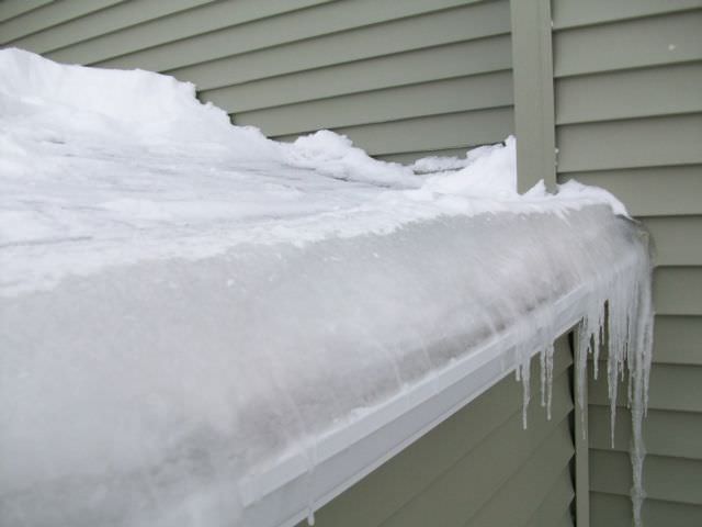

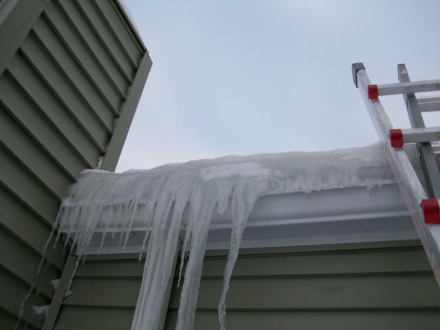

jodil Posted January 6, 2009 Report Share Posted January 6, 2009 Ok I need you help. I have water coming inside at the top behind the trim of my patio door. Last summer I had new siding installed, obviously there is something missing (flashing?) but I cant see what it is since I had 8 inches of ice built up 2 ft up my roof and in my gutters... I shoveled 3 feet of snow off most of my roof. I dont have an attic at this portion of my roof (see pic of my roof line.) What can I do to melt this ice so I can see whats going on with the siding? I was thinking ice melt for drivways but it doesnt say on the bag if its damaging to asphalth shingles. Also what can I do once the flashing (or whatever the problem the dripping problem is coming from) to prevent this damming situation in the future? Thank you! Click to View 32.97 KB Click to View 28.53 KB Click to View 29.38 KB Quote Link to comment Share on other sites More sharing options...
Jim Katen Posted January 6, 2009 Report Share Posted January 6, 2009 Originally posted by jodil Ok I need you help. I have water coming inside at the top behind the trim of my patio door. Last summer I had new siding installed, obviously there is something missing (flashing?) but I cant see what it is since I had 8 inches of ice built up 2 ft up my roof and in my gutters... I shoveled 3 feet of snow off most of my roof. I dont have an attic at this portion of my roof (see pic of my roof line.) What can I do to melt this ice so I can see whats going on with the siding? I was thinking ice melt for drivways but it doesnt say on the bag if its damaging to asphalth shingles. Also what can I do once the flashing (or whatever the problem the dripping problem is coming from) to prevent this damming situation in the future? Thank you! I doubt that the problem has to do with the siding. It looks like you've got some fat & happy ice dams there. The leak you're describing is a classic symptom of an ice dam. Water gets stuck behind the dam, leaks under the shingles and through the roof and then follows the rafters down till it hits the top plate of the exterior wall. From there, it leaks down the studs till it comes to the header above the window or door. If you solve the ice dam issue, I'll bet the leak will go away. With an ice dam like that, I wouldn't try to get rid of the whole thing. I'd try to create channels through it every so often so that water can flow around it. In your climate, I'd probably use heat tape to sculpt appropriate channels. If your roof thaws out this winter, I'd then install the heat tape along all of the gutters, downspouts and the drip edges of the roof to prevent the ice dams from returning. Someday, when you re-roof, it'd be a good idea to install ice & water shield along the lower 6' of your roof. - Jim Katen, Oregon Quote Link to comment Share on other sites More sharing options...
Bain Posted January 6, 2009 Report Share Posted January 6, 2009 Because of capillary action, Jodi, the moisture doesn't always manifest beneath the leak. Is the drywall above the patio door damp? If not, the problem may be something as simple as a lack of, or improperly installed, head flashing. It would be tough to uniformly melt all that snow and ice. Quote Link to comment Share on other sites More sharing options...
SonOfSwamp Posted January 6, 2009 Report Share Posted January 6, 2009 I'd say you're missing flashing over the door and ice/water shield on the roof. Putting in flashing and ice/water shield after the siding and shingles are installed will mean tearing stuff off and starting over (at least in some places). Of course, I could be wrong. There was a time when I thought snow dogs were actual dogs. WJ Quote Link to comment Share on other sites More sharing options...

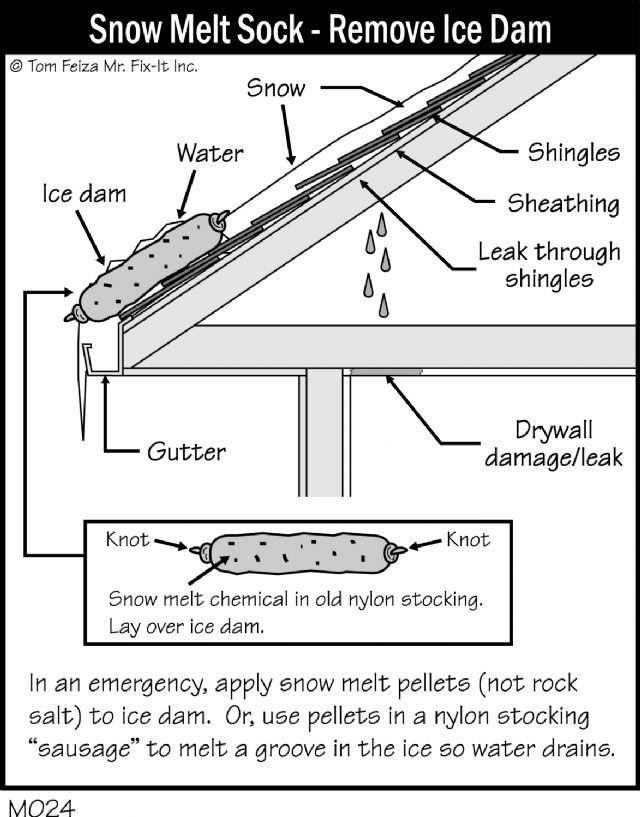

caryseidner Posted January 6, 2009 Report Share Posted January 6, 2009 Jodi, I have never seen anyone use this method, but you mat want to try this. Click to View 90.82 KB Quote Link to comment Share on other sites More sharing options...

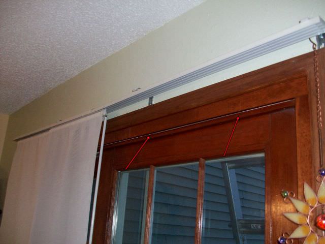

jodil Posted January 6, 2009 Author Report Share Posted January 6, 2009 The drywall is not damp. The water is coming in right under the upper interior door trim (see pic.) There is no water/ice at the top exterior of the patio door. I'm thinking that the water is either coming from the roof somewhere of the gutter region.. I am going to try the ice melter in a pair of tights... I'll let you know how it goes Click to View 40.77 KB Quote Link to comment Share on other sites More sharing options...

Jim Katen Posted January 7, 2009 Report Share Posted January 7, 2009 Originally posted by Bain We don't get anything like that around here. Wouldn't the wall/ceiling intersection be damp if water were pooling on top of the upper plate? Eventually. But it almost always seems to show up at the trim above doors & windows first. We didn't used to get much in the way of ice dams but my house has had them almost every year for the 5 or 6 years or so. The week before Christmas, we had ice dams that looked about like Jodi's do. I just waited for them to melt -- it was 48 degrees out today. - Jim Katen, Oregon Quote Link to comment Share on other sites More sharing options...
Jim Katen Posted January 7, 2009 Report Share Posted January 7, 2009 Originally posted by jodil The drywall is not damp. The water is coming in right under the upper interior door trim (see pic.) There is no water/ice at the top exterior of the patio door. I'm thinking that the water is either coming from the roof somewhere of the gutter region.. I am going to try the ice melter in a pair of tights... I'll let you know how it goes I think you'll find that the water is coming from the back end of the ice dam. The gutter region is frozen solid. The water flows down the rafters, pools on the top plate and slips down the studs. Another possibility is that the icy underside of the roof has become a condensation engine and the water you're getting is condensate. If your drywall isn't damp yet, it might be that the builder put a layer of visqueen behind it to act as a vapor barrier. If so, the visqueen might be protecting the drywall. - Jim Katen, Oregon Quote Link to comment Share on other sites More sharing options...

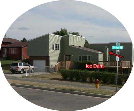

Brandon Whitmore Posted January 7, 2009 Report Share Posted January 7, 2009 I'm glad I don't have to deal with ice dams where I live (other than freak storms), but I would be more than a little concerned with the design in pictures one and two. It looks like water could build up against the wall and wick up and over any flashing at that location. I would like to hope that there is a property detailed cricket/ saddle in there, but what are the chances? Jodi, did you ever have ice dams like this prior to the installation of the new siding? If so, is there a history of past leakage? Quote Link to comment Share on other sites More sharing options...
kurt Posted January 7, 2009 Report Share Posted January 7, 2009 The house is made to ice dam. Flush eaves, no overhangs, all those walls and eaves for water to back up under. If you go heat tape, use Delta-Therm http://www.delta-therm.com/roof_deicing_cables.htm FTR, I dislike heat trace solutions immensely, but they can solve some tricky problems. The only other option is strip the roof and siding, and run WR Grace way up (6' up the roof, couple feet up the walls). The salt in the silk stocking thing looks interesting. I'd like to know if it worked. Take pictures. Quote Link to comment Share on other sites More sharing options...
Rocon Posted January 7, 2009 Report Share Posted January 7, 2009 Here I go again, I am sure that Housdoc will shoot me down again. I think you are looking at the symptom and discussing the treatment for the symptom. Your issue is probably Insulation related. Your house has so many transitions so close together It makes me wonder if you have insulation coverage over the top plate, chimney, and or the confined rake wall. This is the perfect situation and time of the year in your locale to use some Infra red thermography (by someone that know how to interpret the readings). The results should be fairly obviouse where the problem lies. you can find some good info on this issue at: http://www.buildingscience.com/search?S ... xt=ice+dam Quote Link to comment Share on other sites More sharing options...
kurt Posted January 7, 2009 Report Share Posted January 7, 2009 I wouldn't shoot it down. Of course it's insulation and ventilation related. And a host of other things. I doubt there is any way to solve this problem with insulation and ventilation without gutting the roof structure and rebuilding it to accommodate the type and amount of insulation/ventilation necessary to make a difference. That ain't happening. Which leaves the scaled efforts of...... 1) Get rid of the ice dams & provide drainage with salt, heat trace, or some other means. 2) Or, strip the siding and roof, WR Grace the whole thing, then reroof and reside. 3) Or, gut the house and start over. I'm betting #1 is the call. Quote Link to comment Share on other sites More sharing options...

Les Posted January 7, 2009 Report Share Posted January 7, 2009 Jodi, First - a home inspector should not be living in a nice house like that! Second - Ice melter works better than salt. Salt will melt faster and the chemical stuff is not so sensitive to the water. Third - I have used the sock method many times, using my wife's panty hose legs. Fourth - I pretty much agree with the other learned brethern. Fifth - We call them snow dogs. Sixth - do something to get rid of water now and fix it later. Seventh - I likely would use ice cable and suffer the scorn of other inspectors. or "God put it there and he will take it away" Quote Link to comment Share on other sites More sharing options...
