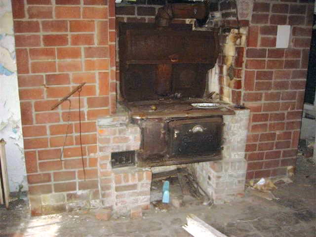

Inspectorjoe Posted January 9, 2009 Report Share Posted January 9, 2009 Mike: Did they use that sheet metal technique in your area? The only place I've ever seen it is in western MA. The use of sheet metal may be dying out, as I typically only see it on older buildings. It seems to me that it would be very effective - more so than Ice and Water Shield. With the self-stick product, the water still gets under the shingles, which can't be good. I tried to find a decent picture (my vacations are usually a busman's holiday), but only found this, which I cropped from a much larger one. It was taken outside of Lee. Click to View 45.84 KB Quote Link to comment Share on other sites More sharing options...

gtblum Posted January 9, 2009 Report Share Posted January 9, 2009 Originally posted by Inspectorjoe Click to View 45.84 KB Now that's a refridgerator box. Anyone out there familiar ice belts? (Metal squares designed to spring back and break the ice.) Quote Link to comment Share on other sites More sharing options...
