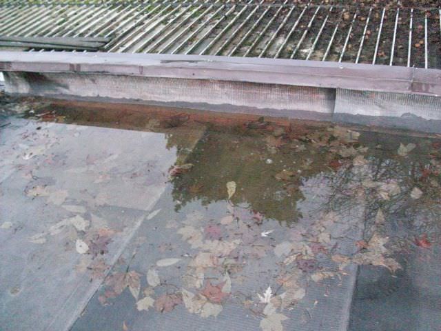

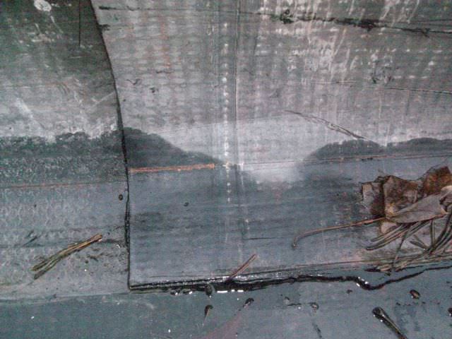

Brandon Whitmore Posted January 13, 2009 Report Share Posted January 13, 2009 This looks like an EPDM roof to me, what say you? I haven't seen a membrane quite like this one as it is much thicker than I am used to seeing. The MLS listing shows the roof as a built up roof, but this looks like a single ply. Is there any chance that a roofer would go to the trouble of installing a hot mop roof and then install this type of membrane as a cap sheet? Doesn't seem likely to me. What about these installation details? Click to View 69.72 KB Click to View 64.78 KB Click to View 60.11 KB Click to View 79.36 KB Click to View 59.13 KB Would you consider this standing water to be enough to call it ponding? It is up to about an 3/4 " deep in areas. Thanks, Quote Link to comment Share on other sites More sharing options...

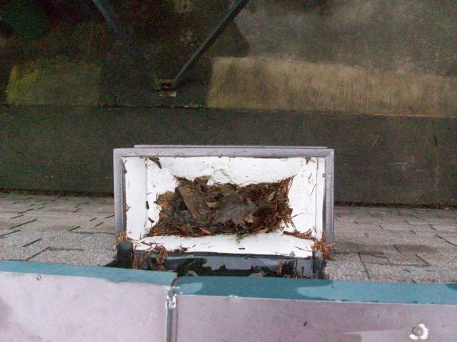

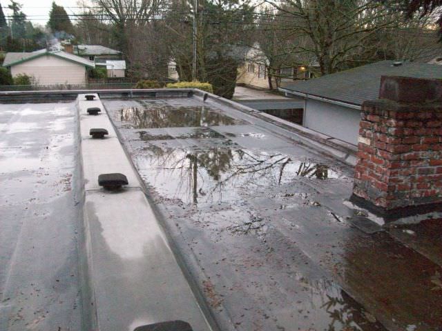

Brandon Whitmore Posted January 13, 2009 Author Report Share Posted January 13, 2009 Here's a couple more pic's of the standing water... Click to View 60.28 KB Click to View 68.97 KB Quote Link to comment Share on other sites More sharing options...

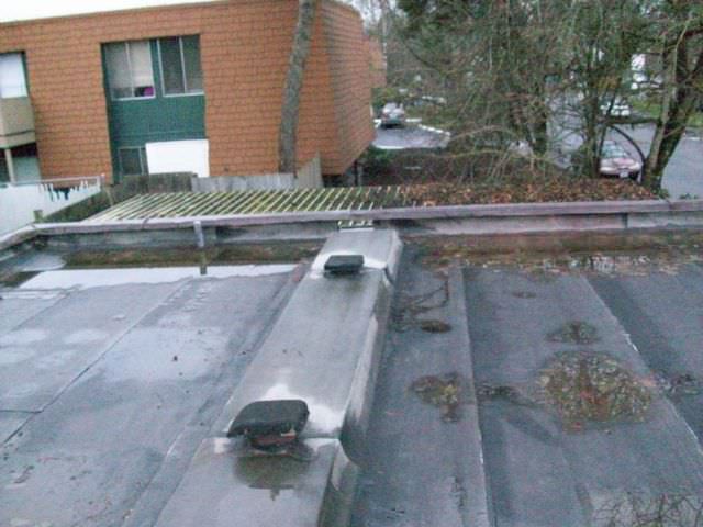

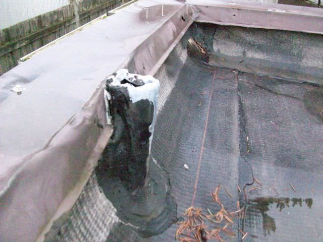

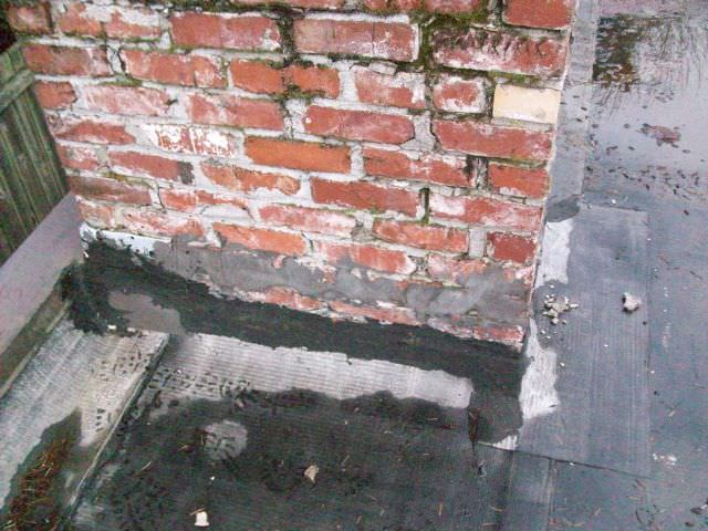

Bill Kibbel Posted January 13, 2009 Report Share Posted January 13, 2009 It sure looks like modified bitumen. It needs UV protection. Terminating it vertically and smearing goop on the top edge is not an acceptable flashing detail and will soon separate. The plumbing vent penetrations will leak too. If that water stands for more than 24 hours, it's ponding. Quote Link to comment Share on other sites More sharing options...
caryseidner Posted January 13, 2009 Report Share Posted January 13, 2009 That IS GAF's ruberoid modified bitumen. Like Bill said, it's all wrong. All of the correct flashing details can be found at GAF's website. Quote Link to comment Share on other sites More sharing options...
Brandon Whitmore Posted January 13, 2009 Author Report Share Posted January 13, 2009 It doesn't look/ feel like any mod. bit I am used to, but I am not arguing. It is much thicker and more firm than the stuff I have seen. Of course, I don't look at many flat roofs in these parts (you guy's answered my questions on the last flat roof I saw). Thanks for the info. , I have something to go on now. PS: The roof was just installed in Sep. '08 and is fully warrantied by the roofer - just thought you would want to know. Heck, it only has one leak I can find right now. I know the 24 (48) hour rule, but at what temp/ under what conditions? (I am guessing any temp/ weather conditions)-- in this case it is ponding) Quote Link to comment Share on other sites More sharing options...
energy star Posted January 13, 2009 Report Share Posted January 13, 2009 The roof is in very bad shape. I see no skuttle holes. The drains must be installed somewhere but I don't see them, and the chimney needs some attention. I can only imagine the moisture under the roof membrane. Quote Link to comment Share on other sites More sharing options...

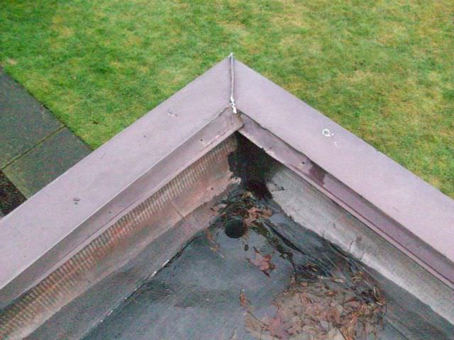

Brandon Whitmore Posted January 13, 2009 Author Report Share Posted January 13, 2009 The roof is in very bad shape. I see no skuttle holes. The drains must be installed somewhere but I don't see them, and the chimney needs some attention. There are 3 drains total-- 2 scuppers and one built in. The scuppers are placed at each end of the raised center platform as shown in pic 1. Click to View 66.46 KB Click to View 59.04 KB Quote Link to comment Share on other sites More sharing options...
Brandon Whitmore Posted January 13, 2009 Author Report Share Posted January 13, 2009 That is GAF's ruberoid modified bitumen Cary, Thanks for the manufacturers info. The realtors are working on getting the info. to me so I can write up the report. I told them I had plenty of concerns, but that I would not send out the report until I saw the manufacturers installation instructions. It should save me an argument with the roofer. Quote Link to comment Share on other sites More sharing options...
energy star Posted January 13, 2009 Report Share Posted January 13, 2009 Yeah I see from the pics now. I thought the skuttle holes had to exit at the lowest point? That roof looks as if it has been on for a long time, since Sept of 08 is a shocker. I had a 13,000 sq ft flat roof on my building. PITA! Quote Link to comment Share on other sites More sharing options...

kurt Posted January 14, 2009 Report Share Posted January 14, 2009 Bill and Cary, thanks for keeping this on track. I've been on a big flat roof all afternoon......... If it isn't mod bit, I'd be very surprised. As everyone has already noted, the installation details are execrable and the lack of drainage dooms this installation. Fixing this roof means tearing it off, installing tapered foam to provide drainage, and reinstalling with termination bars, counterflashing, and appropriate details around the penetrations/chimneys/parapets/coping (or lack thereof). I use the GAF specs often. The NRCA details parallel or are the same as most of the GAF specs. The mfg. (whoever it is) would take one look at this and wash their hands of it. Quote Link to comment Share on other sites More sharing options...
Brandon Whitmore Posted January 14, 2009 Author Report Share Posted January 14, 2009 Ponding as defined by the NRCA: Ponding the excessive accumulation of water at low-lying areas on a roof that remains after the 48 hours after the end rainfall under conditions conducive to drying. Thanks again to all. Quote Link to comment Share on other sites More sharing options...
kurt Posted January 14, 2009 Report Share Posted January 14, 2009 Yes. Around here, ponding is anything that hangs around 48 to 72 hours, depending on which mfg. rep you're talking to. Quote Link to comment Share on other sites More sharing options...
Brandon Whitmore Posted January 14, 2009 Author Report Share Posted January 14, 2009 Problem is, you could argue what conditions are "conducive to drying". Where is the cut off -- 100 deg. day with 40 mph winds, 50 deg. with no wind or rain for 48 hours.......... I wish it were better defined. Quote Link to comment Share on other sites More sharing options...
kurt Posted January 15, 2009 Report Share Posted January 15, 2009 With that POS roof, definitions of ponding are superfluous. The sucker doesn't drain. Every visible detail from your photos screams incompetent installation. Anyone wants to argue fine points of drying times, I'd take my riding crop across their lips for talking back......... I know what you mean about the definition, but it's not something that can be clearly defined. Too many variables. Quote Link to comment Share on other sites More sharing options...
