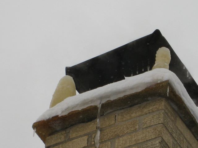

caryseidner Posted January 14, 2009 Report Share Posted January 14, 2009 I saw these ice formations on a chimney cap of a house I inspected today. A natural gas water heater and forced air furnace are routed into the chimney. Outside temperature...DAMN COLD! (10 degrees +/-). The color in the photo is accurate. What the heck causes this? Click to View 27.71 KB The neighboring house chimney had the same thing on it. Except the color was white (newer appliances/flue = less rust?). Click to View 26.9 KB I'm guessing there is no problem with this, but I was wrong once.[] Quote Link to comment Share on other sites More sharing options...
Terence McCann Posted January 14, 2009 Report Share Posted January 14, 2009 Condensation is forming on the rain cap and dripping down then freezing. The 4 corners are the low point with the middle of the cap being the highest. Flue gas is moist. A slightly acidic Popsicle. Quote Link to comment Share on other sites More sharing options...
Jim Katen Posted January 14, 2009 Report Share Posted January 14, 2009 Aren't they just ice stalagmites caused by the condensation dripping off of the caps? - Jim Katen, Oregon Quote Link to comment Share on other sites More sharing options...
caryseidner Posted January 14, 2009 Author Report Share Posted January 14, 2009 Yeah. I guess that's all it is. The parts that through me a bit were: 1) The color difference, but that's gotta be rust.2) I didn't mention in my original post, but these were the only two chimneys on the block that had the stalagmites. 3) I have never seen this before. id="indT"> Quote Link to comment Share on other sites More sharing options...
Mark P Posted January 14, 2009 Report Share Posted January 14, 2009 How about this.. Snow lands on the rain cap, the warm exhaust melts it and then it refreezes when it runs off the corners. Quote Link to comment Share on other sites More sharing options...
Brad Manor Posted January 14, 2009 Report Share Posted January 14, 2009 Stalagmites are the ones that grow upwards. Stalactites are the ones that hang down. -Brad ..... nevermind, I just took a closer look [:-paperba Quote Link to comment Share on other sites More sharing options...
kurt Posted January 15, 2009 Report Share Posted January 15, 2009 There's supposed to be a metal liner inside that clay tile liner. Yes, I know all the local morons say you don't need a metal liner if there's a clay tile liner, but they're wrong. That said, I see this all the time in winter. Simple condensation, and stalactite/stalagmite formation. Quote Link to comment Share on other sites More sharing options...

AHI in AR Posted January 15, 2009 Report Share Posted January 15, 2009 Originally posted by caryseidner Yeah. I guess that's all it is. The parts that through me a bit were: 1) The color difference, but that's gotta be rust. We don't get cold enough around here to see that sort of thing, but I'd guess that the coloration of the "stalagmites" is due to the inclusion of combustion byproducts from previous use as a woodburning fireplace chimney (resins, etc) in the condensation. Quote Link to comment Share on other sites More sharing options...

Jeremy Posted January 15, 2009 Report Share Posted January 15, 2009 Originally posted by AHI in AR Originally posted by caryseidner Yeah. I guess that's all it is. The parts that through me a bit were: 1) The color difference, but that's gotta be rust. We don't get cold enough around here to see that sort of thing, but I'd guess that the coloration of the "stalagmites" is due to the inclusion of combustion byproducts from previous use as a woodburning fireplace chimney (resins, etc) in the condensation. My thoughts as well. I have seen it with wood burners...and darker. Quote Link to comment Share on other sites More sharing options...
caryseidner Posted January 15, 2009 Author Report Share Posted January 15, 2009 Originally posted by kurt Originally posted by energy star My understanding is a properly sized, new, or well maintained chimney does not need a metal liner. Many older homes have a very large chimney that will be to large for proper draft or the thing is just falling apart inside, in that case you are correct. Is that what you are referring to Kurt? Any chimney on an outside wall venting gas combustion appliances has to have a metal liner. I might be wrong on this one, but it looked like it was on an outside wall. It is on an outside wall and there was not a metal liner in it. Thanks Kurt. Quote Link to comment Share on other sites More sharing options...
Brandon Whitmore Posted January 15, 2009 Report Share Posted January 15, 2009 Kurt, Do you have a code cite off the top of your head by chance? I don't remember reading this, but I guess I need to re- read the whole book anyways. PS: Did a quick Google search to see if I could cheat and not look in the IRC. The first article I read was this: http://www.oldhouseweb.com/how-to-advic ... nace.shtml I read the whole thing before realizing it was from Bill. Quote Link to comment Share on other sites More sharing options...
energy star Posted January 15, 2009 Report Share Posted January 15, 2009 A new chimney on an outside wall does not require a metal liner. If the flue or chimney is to large or needs repair, a liner will serve you best, as the link above points out. I gotta go do some duct blasting. later. Quote Link to comment Share on other sites More sharing options...
Darren Posted January 15, 2009 Report Share Posted January 15, 2009 Kurt; This is what I was told at a seminar this year (Presented by Julius Ballanco PE, you may know him, he's from Ill.) Any fan assisted appliance that's connected to an exterior chimney, that chimney MUST be re-lined with a metal liner. Any fan assisted appliance that connected to an interior chimney, that chimney PROBABLY should be re-lined, but may not have to be (depending on the size). Is that what you're referring to? Quote Link to comment Share on other sites More sharing options...

caryseidner Posted January 18, 2009 Author Report Share Posted January 18, 2009 Originally posted by Jeremy Originally posted by AHI in AR Originally posted by caryseidner Yeah. I guess that's all it is. The parts that through me a bit were: 1) The color difference, but that's gotta be rust. We don't get cold enough around here to see that sort of thing, but I'd guess that the coloration of the "stalagmites" is due to the inclusion of combustion byproducts from previous use as a woodburning fireplace chimney (resins, etc) in the condensation. My thoughts as well. I have seen it with wood burners...and darker. The house was only 40 years old and I don't believe it's fuel source was ever wood or oil. Just natural gas. My (revised) guess is the color was due to the rust on the rain cap, which you can't really see in the photo. Quote Link to comment Share on other sites More sharing options...
