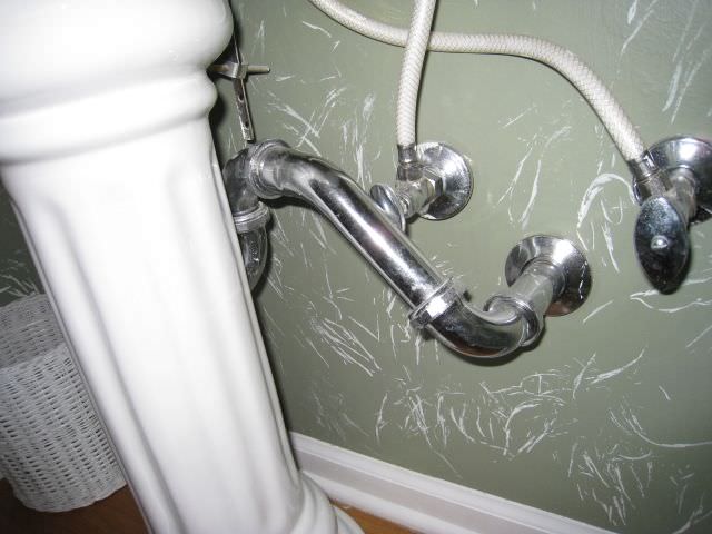

caryseidner Posted January 15, 2009 Report Share Posted January 15, 2009 This has bugged me for a while, but I finally was able to snap a couple of good photos that (I think) illustrate my question. Here is a P-Trap beneath a pedestal sink, or is it an S-Trap? Clearly this pipe moves in an S shape. How long does the horizontal portion, directly downstream of the 'P', have to be to make it a 'P' and not an 'S'. Or is that not the criteria? Click to View 45.71 KB Click to View 46.47 KB Quote Link to comment Share on other sites More sharing options...
Richard Moore Posted January 15, 2009 Report Share Posted January 15, 2009 I would consider that an S-trap. The trap arm, the pipe crossing in front of the stop-valve, should be near horizontal. It could be reconfigured using a longer tailpiece (or a tailpiece extension) to achieve that. "How long does the horizontal portion, directly downstream of the 'P', have to be to make it a 'P' and not an 'S'. Or is that not the criteria?" If you are talking about the short section before the 45 bend, it doesn't matter in this case. The whole trap arm (including all bends) has to be near horizontal until it reaches the vented drain in the wall. Quote Link to comment Share on other sites More sharing options...
Terence McCann Posted January 15, 2009 Report Share Posted January 15, 2009 That's a good one Cary. Typically you don't offset a pedistal sink like that [:-bigeyes What in the world are they thinking?? Quote Link to comment Share on other sites More sharing options...
Brandon Whitmore Posted January 15, 2009 Report Share Posted January 15, 2009 I believe the trap arm needs to be at least 2X the diameter of the pipe long to be a P trap-- don't ask me to quote my source. That installation is definitely not a proper trap. Also, the weir (water level) of the trap is too high on that one. I'll try to find a diagram on- line. Quote Link to comment Share on other sites More sharing options...
kurt Posted January 15, 2009 Report Share Posted January 15, 2009 I'm not sure what I'd call that, but I don't think it's an S trap. An S trap is where the drain extends vertically down. This is someones bizarre idea of an offset with an incorrect pitch, not an S trap. Quote Link to comment Share on other sites More sharing options...
Brandon Whitmore Posted January 15, 2009 Report Share Posted January 15, 2009 Here's a pretty good explanation for a P trap. Scroll down to the diagram. http://www.homerepairforum.com/forum/pl ... cover.html Also, an S trap is basically un-vented. If there is a vent, that's just a screwed up attempt at a trap that will probably not work. I'm not sure you want to give that creature a name. Quote Link to comment Share on other sites More sharing options...
Richard Moore Posted January 15, 2009 Report Share Posted January 15, 2009 Originally posted by kurt I'm not sure what I'd call that, but I don't think it's an S trap. An S trap is where the drain extends vertically down. This is someones bizarre idea of an offset with an incorrect pitch, not an S trap. Kurt, I agree it's not a classic S-trap, but anything that slopes down that much is not vented correctly to prevent siphonage (albeit, it seems unlikey that full siphonage could actually occur). I guess I should have used "effectively acting as a S-trap"? Quote Link to comment Share on other sites More sharing options...

AHI in AR Posted January 15, 2009 Report Share Posted January 15, 2009 Count me as one who doesn't consider that an S trap. Normally, I believe that the highest likelihood for a problem for that design would be due to the fact that there is too much slope to the "horizontal" section -- leading to the possibility that the more solid components of the waste stream (soap, hair, etc. ) could separate out because the water will exit more rapidly than the more dense materials will. If that happens, you can get a build up of gunk in the trap. However, that is a pedestal sink. I assume it is in a seldom used half bath. If so, the real likelihood of a problem in anything close to a reasonable time span is pretty small. But it's still wrong. Quote Link to comment Share on other sites More sharing options...
kurt Posted January 15, 2009 Report Share Posted January 15, 2009 Here's a question..... If there was a longer tailpiece on the sink drain, resulting in the arm being at the correct (1/8"-1/4" per foot) angle, is this acceptable? No sez I, 'cuz it's too ugly. Quote Link to comment Share on other sites More sharing options...
AHI in AR Posted January 15, 2009 Report Share Posted January 15, 2009 Originally posted by kurt Here's a question..... If there was a longer tailpiece on the sink drain, resulting in the arm being at the correct (1/8"-1/4" per foot) angle, is this acceptable? No sez I, 'cuz it's too ugly. Is merely being "ugly" prohibited by code? If so, I'm in trouble... Quote Link to comment Share on other sites More sharing options...
Jeremy Posted January 15, 2009 Report Share Posted January 15, 2009 In addition to everything already said, the section of pipe that is passing through the drywall would need to be one size larger, and then within five feet from the trap, attach to a verticle vent two sizes larger than the pipe in the photo. IRC Section P3105 Fixture Vents. It would still be ugly. Quote Link to comment Share on other sites More sharing options...

Jeff Remas Posted January 15, 2009 Report Share Posted January 15, 2009 This is a great question and it is not spelled out in the building codes at all. I was, however able to dig something up from New Jersey some time back (I don't know if they still have this language) but essentially they said that the outlet from the trap weir had to be at least 3" in length to be condidered a P trap. I have been using 3" as a decision maker ever since then but it is not in the IRC or IPC. Maybe Darren can dig this back up since he is a Jersey boy Quote Link to comment Share on other sites More sharing options...
