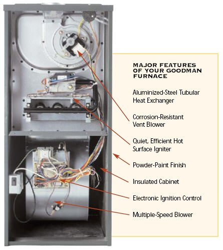

Ok guys. The latest info.
Mr. Sessums,
I was finally able to pull panels off today and find the model number on the furnace. Goodman model number GMS81155CNA
There a light inside this model that remains solid if the unit is operating normally. Once inside the unit, I found a typed list of what it means if the light does other things. If it is off, there is control failure. Two flashes... pressure switch stuck closed. Three flashes...pressure switch stuck open. Four flashes... open high limit. Five flashes... flame sensor without gas value. Six flashes... open rollout. Seven flashes... low flame signal. Currently, the light is burning solid.
The flue size is 4 inches.
I don't know if the condo owner understood my description of what is happening. I don't know all the technical words. What I mean by the "blower" stops while the unit is still on upstairs... is that air is no longer blowing out of the vents in the house... but the unit is still running. It is almost like the unit is trying to cut off by going in reverse order. However once the air stops coming out of the vents and the unit runs for 15 to 20 seconds... the air blows out of the vents again before everything cuts off as it is supposed to.
Hope this makes sense.
Thanks again for any guidance.
Link to comment
Share on other sites
Well Charlie, from that description it sounds like an older style furnace with the bi-metal style fan control - much like what Jim was describing.
I was hoping find an installation manual, to look at the electrical schematic and see what the fan control was, no luck.
This web site had the manual but when I clicked on it the link came up broken.
I did see this picture
Click to View
46.73 KB
and there is some kind of limit mounted to the blower housing - not sure what it is - over temp limit?
I also ran across this part which is an integrated fan control but unfortunately no picture.
Without an electrical schematic I'm out of bullets.
