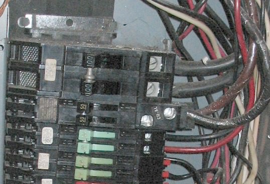

Scottpat Posted February 6, 2009 Report Share Posted February 6, 2009 I have never seen a Zinsco breaker with space for two lines. I'm pretty sure it was made this way as each has it's own lug, but I just want to confirm. Anyone else see a breaker like this? Click to Enlarge 65.39 KB Quote Link to comment Share on other sites More sharing options...
Jim Katen Posted February 6, 2009 Report Share Posted February 6, 2009 I have never seen a Zinsco breaker with space for two lines. I'm pretty sure it was made this way as each has it's own lug, but I just want to confirm. Anyone else see a breaker like this? I can't recall having ever seen one like that, no. - Jim Katen, Oregon Quote Link to comment Share on other sites More sharing options...
Richard Moore Posted February 6, 2009 Report Share Posted February 6, 2009 Looks a bit like this... Click to Enlarge 80.17 KB Seems there may be two "vintages" of Zinsco beakers(?). Most 2-poles I see have the lugs side by side (as in the 25-amp below), but then there are these. Quote Link to comment Share on other sites More sharing options...
Les Posted February 6, 2009 Report Share Posted February 6, 2009 Scott, We ran into them in the Wickes line of modular housing from mid 80's. Not common. Quote Link to comment Share on other sites More sharing options...
Scottpat Posted February 6, 2009 Author Report Share Posted February 6, 2009 This was in a 1975 condo. Curious how not many have seen them. Quote Link to comment Share on other sites More sharing options...
HOTWATERHEATER Posted February 9, 2009 Report Share Posted February 9, 2009 i have noticed a few in south arlington, texas Quote Link to comment Share on other sites More sharing options...
