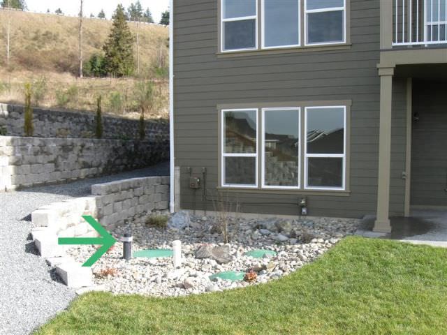

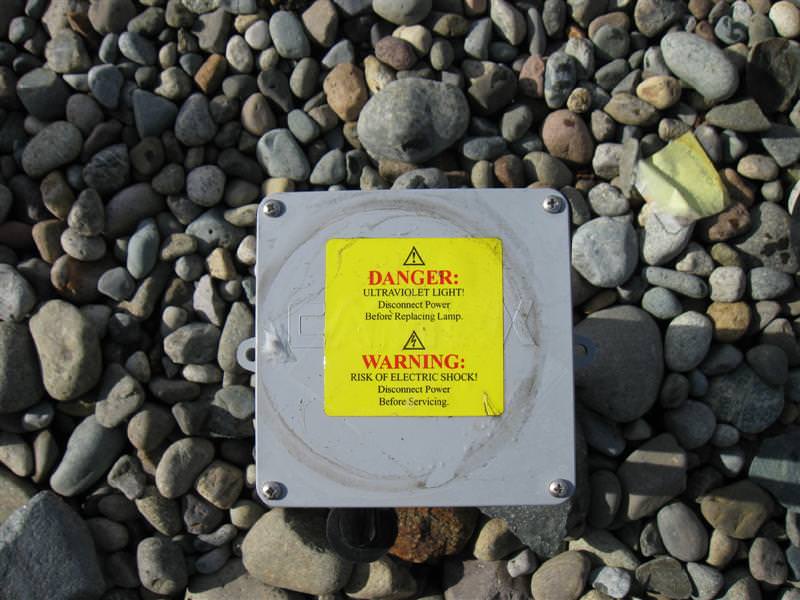

Robert Jones Posted February 13, 2009 Report Share Posted February 13, 2009 New construction home, on septic, lawn sprinkler system installed. I haven't run into this before and was hoping someone could describe to me what it is. Thanks, Click to Enlarge 90.49 KB Click to Enlarge 69.33 KB Quote Link to comment Share on other sites More sharing options...
Jerry Simon Posted February 13, 2009 Report Share Posted February 13, 2009 Rob... The UV light supposedly purifies the septic system's waste water. Go here... http://www.patentstorm.us/patents/62967 ... ption.html Quote Link to comment Share on other sites More sharing options...

Bill Kibbel Posted February 13, 2009 Report Share Posted February 13, 2009 It's an effluent ultraviolet disinfection unit. They're typically installed on spray irrigation systems, direct stream discharge systems and systems near wetlands. It's the preferred method of sterilization where chlorine could cause problems. Quote Link to comment Share on other sites More sharing options...
