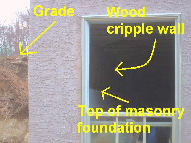

Inspectorjoe Posted February 14, 2009 Report Share Posted February 14, 2009 The one year old stucco above the lower roofs is white in several areas. There are no other apparent differences between it and the tan stucco. I'm baffled. Click to Enlarge 96 KB Click to Enlarge 53.15 KB Click to Enlarge 57.97 KB Quote Link to comment Share on other sites More sharing options...

Inspectorjoe Posted February 15, 2009 Author Report Share Posted February 15, 2009 No, it's definitely not efflorescence. Rubbing it had no effect. The only thing I had on the roof to wet it with was ..... was .... uh, oh never mind. The only residue on the roof was little bits that got slopped onto it during application. The only thing I can come up with is that maybe before the gutters were installed, roof runoff splashed up and the acidic rainwater reacted with the pigment in the fresh stucco. It seems to be just a cosmetic problem, but I'd like to know if it isn't. Anyway, from the picture below, you can see that it's not the biggest issue. Click to Enlarge 58.52 KB Quote Link to comment Share on other sites More sharing options...
Bill Kibbel Posted February 15, 2009 Report Share Posted February 15, 2009 The only thing I can come up with is that maybe before the gutters were installed, roof runoff splashed up and the acidic rainwater reacted with the pigment in the fresh stucco. I think that's partially correct minus the "acidic". The Portland Cement Assoc. warns against wetting colored finish stucco when curing as it can wash out pigment, cause mottling and discoloration. Splash up immediately after application would be the likely culprit. Quote Link to comment Share on other sites More sharing options...
Rob Amaral Posted February 15, 2009 Report Share Posted February 15, 2009 Could be simple rain backsplash... Quote Link to comment Share on other sites More sharing options...
