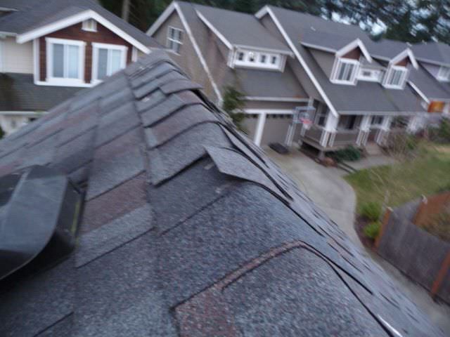

msteger Posted February 28, 2009 Report Share Posted February 28, 2009 I am looking for suggestions for comments for architectural shingles installed at the ridge, instead of cut 3-tab or ridge shingles. I ran into this situation today, but the report comment I came up with explaining the situation and why it can be an issue sounds sort of dumb and not worth using, to put it nicely. Any suggestions for a good comment about the condition and why is appreciated. Thanks. Quote Link to comment Share on other sites More sharing options...
hausdok Posted March 1, 2009 Report Share Posted March 1, 2009 Hi, Are you talking about architectural-grade shingles that have cut up into smaller pieces to cap the ridge or are you talking about the shingles going straight up and over the ridge without ridge cap shingles? Did you take any pictures? ONE TEAM - ONE FIGHT!!! Mike Quote Link to comment Share on other sites More sharing options...
Jim Katen Posted March 1, 2009 Report Share Posted March 1, 2009 At the peak of the roof, the roofer installed ridge cap shingles that he made himself by cutting up laminated field shingles. The shingle manufacturer specifically warns against doing this because the laminated shingles don't bend well. They'll be susceptible to cracking and wind damage and they look whack. Remove and discard the improper materials and replace them with proper ridge cap shingles. Quote Link to comment Share on other sites More sharing options...
randynavarro Posted March 1, 2009 Report Share Posted March 1, 2009 Hm. How timely. You can use these pics from two days ago if you can figure how to re-color and make them look like your house. Click to Enlarge 48.78 KB Click to Enlarge 54.06 KB Quote Link to comment Share on other sites More sharing options...
msteger Posted March 1, 2009 Author Report Share Posted March 1, 2009 Thanks guys. Yep, the pictures from Randy pretty much show exactly what I am talking about. They looked like crap and parts were sticking up as they don't bend well and adhere properly. There was even a cupola over the garage and the little 1.5' x 1.5' peaked roof at the top of the cupola looked terrible, even from the driveway as one could see what looked like small patchwork of dozens and dozens little cut shingles. Quote Link to comment Share on other sites More sharing options...

hausdok Posted March 7, 2009 Report Share Posted March 7, 2009 Hi, The Certainteed Master Shingle Applicator says to use accessory shingles for those or cut caps from shingles with tab cutouts (3-tab) - not laminated shingles - the manual points out that the accessory shingles are far easier to use than cutting up tabbed shingles, which requires a total of 8 cuts per shingle to yield only 3 caps. There are supposed to be 24 scored accessory shingles in each bundle that will produce a total of 72 cap accessory shingles. They're easier to use because they're marked for alignment and positioning so it's hard to get them off-center or use too little or too much headlap. You say they were cut on site; the accessory shingles come as a full shingle that's scored into thirds with the bottom edges notched so that when the three sections are separated from one another the corners are already nipped off and the tabs don't need to be trimmed. If he cut those from laminated shingles, tell him he should go to the proctologist and get his eyes, ears and nose checked. ONE TEAM - ONE FIGHT!!! Mike Quote Link to comment Share on other sites More sharing options...
