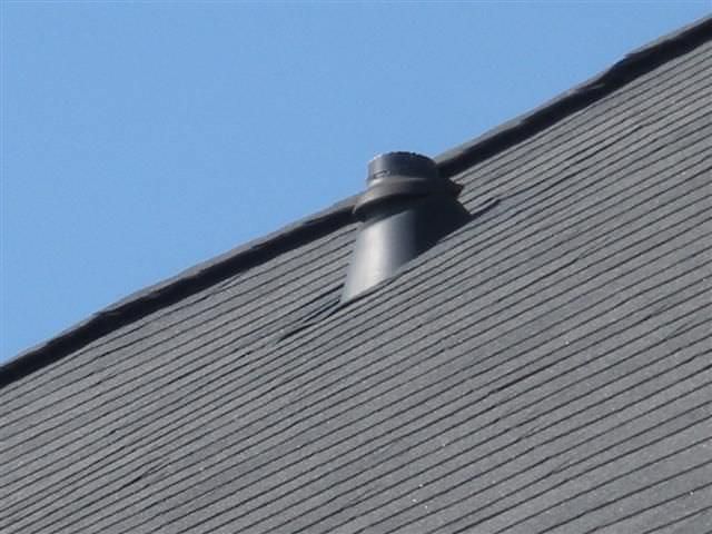

CheckItOut Posted March 6, 2009 Report Share Posted March 6, 2009 Looks like part of a boot is on top of a full boot. 12 yr old house with zero stains on the roof sheathing as visible in the attic around vent pipe. Due to the pitch, I could not physically get to it. Seen anything like this? Click to Enlarge 52.71 KB Quote Link to comment Share on other sites More sharing options...
John Dirks Jr Posted March 6, 2009 Report Share Posted March 6, 2009 I'm not sure about that boot but the pipe looks to be cut a bit short. Is that painted PVC, or ABS? Quote Link to comment Share on other sites More sharing options...
Bill Kibbel Posted March 6, 2009 Report Share Posted March 6, 2009 Looks like part of a boot is on top of a full boot. 12 yr old house... I see that occasionally as a repair for cracked/split neoprene collars. Many of them fail before 12 years. Click to Enlarge 9.77 KB Quote Link to comment Share on other sites More sharing options...
CheckItOut Posted March 6, 2009 Author Report Share Posted March 6, 2009 Looks like part of a boot is on top of a full boot. 12 yr old house... I see that occasionally as a repair for cracked/split neoprene collars. Many of them fail before 12 years. Click to Enlarge 9.77 KB Could be taller and ABS. Quote Link to comment Share on other sites More sharing options...
Phillip Posted March 6, 2009 Report Share Posted March 6, 2009 Looks like part of a boot is on top of a full boot. 12 yr old house... I see that occasionally as a repair for cracked/split neoprene collars. Many of them fail before 12 years. Click to Enlarge 9.77 KB I have seen a few of them as repairs like Bill said. In my area in seems that they start coming apart around 8 year of age. Quote Link to comment Share on other sites More sharing options...
