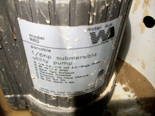

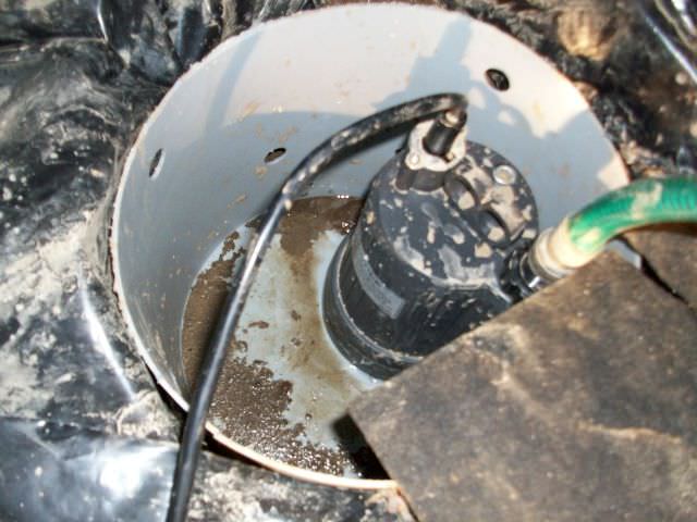

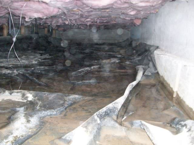

Brandon Whitmore Posted March 17, 2009 Report Share Posted March 17, 2009 I inspected another crappy sump pump install the other day. I am curious as to several things I haven't looked up yet. I am not being lazy, but need info. ASAP. The installation: A bucket with some holes drilled in it was placed in the center of the crawlspace. A new receptacle (no GFCI protection) was installed for this sump pump. The sump pump lacked any float or visible switch, and was running continuously (dry in that area). The drain hose was a cut section of garden hose. The end of the drain pipe was run to the low point drain and was just pushed in through the check valve/ flapper. My concerns: The low point drain (funny name for something that is hardly ever at a low point) was high and dry. There was evidence of recent standing water throughout most of the crawlspace (75%+). The sump was just placed near the middle of the crawlspace. There was no trenching work done. There was standing water throughout about 30% of the crawlspace-- probably about 3" deep The standing water was nowhere near the low point drain or sump. (sump was just installed prior to my inspection after a sale fail). The home's lot was reverse graded-- everything sloped right to the foundation. I have never seen a sump pump such as this one with no visible switch-- do they make pumps with internal switches that sense moisture and turn on when working properly? Shouldn't a sump pump be a last ditch effort (high water table) when water can't be kept out of a crawlspace to begin with? Shouldn't trenching in a mostly flat crawlspace be pretty much a requirement? Isn't running a drain line through the check valve/ flapper of a low point drain an improper installation seeing as how water can now drain back into the crawlspace? Wouldn't permits have been required for the pump installation? Are there any minimum standards (code, etc.) that a drainage contractor must comply with, or can they just do whatever they want with the installation of a sump pump/ drainage system? Quote Link to comment Share on other sites More sharing options...

Richard Moore Posted March 17, 2009 Report Share Posted March 17, 2009 Bad use of the word "professional"! To answer one of your questions, there are diaphragm switched sump pumps with no obvious float. See.. http://www.ridgid.com/Tools/SP330D-Sumpe-Pump & http://www.sump-pump-info.com/float-switches.html Can't say I've ever seen one. You say yours was running continuously but dry. I'm surprised it hasn't burnt out yet...but it will. Quote Link to comment Share on other sites More sharing options...

Brandon Whitmore Posted March 17, 2009 Author Report Share Posted March 17, 2009 Maybe it's just me, but I don't see where you have any obligation to troubleshoot/redesign a wet crawl space. A (seriously) wet crawl space is a problem. That's pretty much common knowledge. Why not just tell the "stakeholders" that it's wet, problems include but aren't limited to (ABCXYZ), and somebody needs to hire somebody to figure out the mess and fix it. As I've said before, how-to instructions are valuable. Writing up a pro-quality game plan for the "stakeholders" isn't HI work; it's a whole different profession, with peer review, editors and other backups (like the publisher's insurance). I've written such game plans. Back in the day, they sold for about a buck a word. One of my favorite phrases: "All I can do is tell you it's screwed and it needs fixing." BTW, as soon as you start offering design solutions, you're pretty much exposed to the wrath of any puddinhead in the mood to sue somebody. Let 'em sue the guy who screwed it up in the first place. WJ: I hammered this house on drainage issues. I wrote in the report that I believed that the sump was just a band- aid, and that exterior drainage work should be done. I recommended that they hire a drainage expert to design a permanent solution to keep water out of the crawlspace to begin with. I told my client that the sump pump should never be needed unless there are water table issues, which I do not believe to be the case (wrote this in the report as well). The frustrating part is that I am now being hired to re- inspect the "band- aid"---- kind of like that roof a few weeks ago. I know that I can be held liable if I start to "design" repairs. I do my best to not do so. I just called the contractor back. He told me that he did the electrical work himself , and that no permits were pulled. When he asked me what needed to be done to "pass" the inspection, I let him know that my re- inspection report was going to state that X work was done without permits, and that he likely violated the law by performing electrical work. I told him what I usually see on a sump type system, but that I do not design repairs. On the re- inspection, I will just write down what I see. If it's dry, I'll say it needs to be watched. If it's wet........... I will also refer to my original report that recommends further measures be taken to keep water out of the crawlspace. I'd like to write something like this: Good job in fixing the band aid. Now hire a true drainage expert to actually fix the mess. Quote Link to comment Share on other sites More sharing options...
Bain Posted March 17, 2009 Report Share Posted March 17, 2009 One of the first things people ask when I tell them a crawlspace is too damp is, "Should we install a sump pump?" But it's a complete waste of time and effort just to dig a pit and plop down the pump, unless the entire crawlspace floor is pitched toward the sump pump. And, of course, it never is. Waterproofing a crawlspace is pretty similar to how B-Dry waterproofs a basement. Around here, the cost is typically 2K-4K. And the work comes with a guarantee. Everything Walter said is true, but in real time it doesn't always work. You--or I suppose I should say I--can't tell every buckethead he's a buckethead and shouldn't have been involved in the job in the first place. The flip side, like Walter said, is you don't want to prescribe the exact repair 'cause that's not your job, and you also don't want to waste unpaid time having a conversation with someone who's clueless. Right or wrong, I would voice my concerns to my client, but when the realtor and contractor entered the equation, I'd recommend they contact a professional waterproofing company--that offers warranties with its work--and let them offer advice on how best to proceed. Doesn't always work, naturally, so sometimes you have to call an audible. This is actually one of the more delicate aspects of our jobs. Last summer, I trashed a house that an attorney was buying. The realtor had her pet contractor ring me up to ask what had to be done to satisfy me. I politely explained that I didn't prescribe corrections over the phone, and that if he wasn't aware of the codes and the proper repair methods, he probably wasn't the best person for the job. He turned sullen and rude, and a few minutes later, hung up on me. The attorney called back an hour later, wanting to know why I wasn't amenable to helping out the contractor, 'cause the seller was wanting to make certain all the repairs were effected correctly. I explained things that everyone here understands, but the guy didn't get it. He kept saying, "How can you tell them it's wrong if you won't tell them how to fix it?" I tried to explain further and also mentioned that it would require a couple of hours of my time and the realtor's contractor would still likely botch everything, but the attorney became increasingly upset, and still probably thinks I'm a big fat schmuck. So Brandon, I empathize, 'cause I realize it's not always an easy call. Quote Link to comment Share on other sites More sharing options...
Brandon Whitmore Posted March 17, 2009 Author Report Share Posted March 17, 2009 To answer one of your questions, there are diaphragm switched sump pumps with no obvious float. See..http://www.ridgid.com/Tools/SP...mpe-Pump & http://www.sump-pump-info.com/...hes.html Thanks Richard-- it looked nothing like those, but it just donned on me that I took pictures....... Here's the pump's installation instructions[:-slaphap: http://www.waterace.com/pdf/R6S%20Utili ... Manual.pdf It flat out says that it's not to be used for permanent installations... Click to Enlarge 58.75 KB Click to Enlarge 50.18 KB Click to Enlarge 53.25 KB Quote Link to comment Share on other sites More sharing options...
Bain Posted March 17, 2009 Report Share Posted March 17, 2009 I was gonna ask what kind of idiot connects a garden hose to a sump pump, but that's what the instructions say to do. Fascinating. As you noted, what would the contractor say about this? "The utility pump is engineered for water removal in temporary applications. The utility pump is not to be used for continuous duty or permanent installations." Or this? "The R6S is designed for residential clean water ââ¬Åspotâ⬠Quote Link to comment Share on other sites More sharing options...
Brandon Whitmore Posted March 17, 2009 Author Report Share Posted March 17, 2009 I was gonna ask what kind of idiot connects a garden hose to a sump pump, but that's what the instructions say to do. Fascinating. As you noted, what would the contractor say about this? "The utility pump is engineered for water removal in temporary applications. The utility pump is not to be used for continuous duty or permanent installations." The contractor told me that he has installed close to a hundred of these things this way, without a problem. That's downright impressive (that he hasn't had problems that is) The buyer's agent told me that this was a thousand dollar installation, and that the contractor guaranteed his work. I'm in the wrong line of work if a contractor is making a grand installing a receptacle, a bucket, and a temporary pump with a garden hose attached. Shoot, I could have actually fixed this problem for a grand. Quote Link to comment Share on other sites More sharing options...

hausdok Posted March 18, 2009 Report Share Posted March 18, 2009 Hi, I agree with what you've said; this issue originates outside of the crawlspace - either it's bad grading or downspouts emptying too close to the home or a broken downspout receiver, so that's where they need to concentrate their efforts and the pump should be the last line of defense. Since the "contractor" is being so accommodating, I suggest that you tell him that if he wants to someday grow up to be an honest-to-goodness competent person he should at least be able to do work that's equal to or better than a do-it-yourselfer's; and then you direct him to the ultimate do-it-yourselfer site - Popular Mechanics - to see how a proper do-it-yourselfer sump pump installation would look. This one is for a pump installed through a concrete floor but that's the only difference; all he'll need to do is sink it deeper in the mud because there's no concrete floor involved. Show the homeowner this article and then show the homeowner the pictures of the rowboat sump arrangement he's got. ONE TEAM - ONE FIGHT!!! Mike Quote Link to comment Share on other sites More sharing options...
Garet Posted March 18, 2009 Report Share Posted March 18, 2009 A temporary pump with no water sensor - Oh My! That's a jack-leg, screwed-up installation created by someone who doesn't understand how to tackle the problem. The simple fact that the crawl still has standing water should be proof to any 5th grader that the system is not doing its job. There's no trying to save this installation. They need to hire a contractor who actually knows what he's doing to start over from scratch. Brandon, sometimes it's easy to get sucked into the middle of other people's problems, but there's no good in it for you. Don't let your business practices be dictated by others. As Walter says: all risk, no reward. Quote Link to comment Share on other sites More sharing options...
