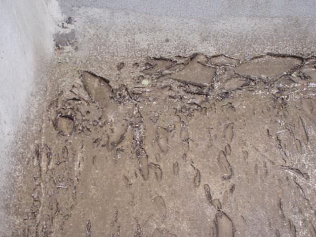

Inspector Will Posted March 21, 2009 Report Share Posted March 21, 2009 I have not seen this type of roof before. Any information about the material and the condition of this particular roof based on the pics would be much appreciated. It appears to be a bitumen like material. Click to Enlarge 66.49 KB Click to Enlarge 65.33 KB Click to Enlarge 78.36 KB W Quote Link to comment Share on other sites More sharing options...
Jim Katen Posted March 21, 2009 Report Share Posted March 21, 2009 I have not seen this type of roof before. Any information about the material and the condition of this particular roof based on the pics would It's hard to tell anything definitive from the pictures, but it looks like a built up roof with a few layers, several years apart, of a silver coating. - Jim Katen, Oregon Quote Link to comment Share on other sites More sharing options...
hausdok Posted March 21, 2009 Report Share Posted March 21, 2009 Hi, I agree with Jim; the perimeter of the roof in the first picture looks like a built up roof (BUR). Old tech - probably well past expected end of service life. OT - OF!!! M. Quote Link to comment Share on other sites More sharing options...
boatman Posted April 5, 2009 Report Share Posted April 5, 2009 looks like bur and a coating i am from newengland prov area been do roofing for 22 years roof is in very bad shape!!!!!!!!!!!!!!!!!!! Quote Link to comment Share on other sites More sharing options...
