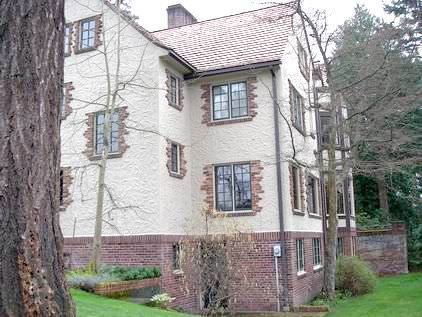

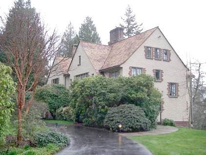

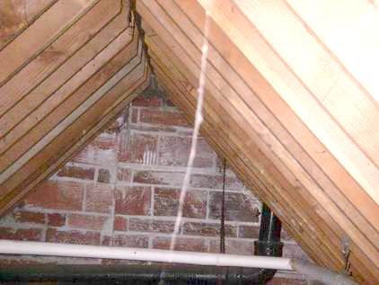

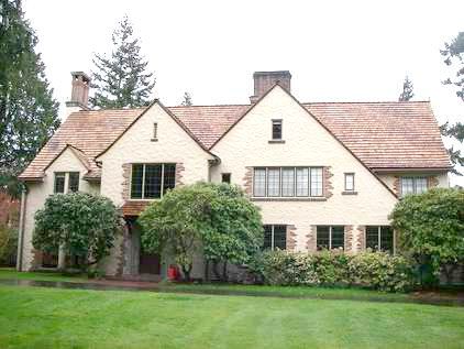

hausdok Posted March 21, 2009 Report Share Posted March 21, 2009 Hi Bill, Got some questions - edumakate me! Its an old 1922 8000 square foot structural terra-cotta mansion with flawless stucco. The only place the structure is visible is in the attic. No cracks or defects. The place appears to be in flawless condition. The main floor (above basement) is 11 inches of reinforced concrete, original Otis elevator. I'm wondering about windows. No arches, attic has timber lintels which would be too small on large lower windows. I beams? Were the webs filled with conc or slurry? Could you create a bond beam big enough for a lintel? Can you drill it without damaging the tile? How many wall thicknesses for a four story? etc. Click to Enlarge 31.54 KB Click to Enlarge 26.81 KB Click to Enlarge 33.99 KB Click to Enlarge 41.41 KB Click to Enlarge 24.03 KB Click to Enlarge 24.37 KB Click to Enlarge 35.26 KB ONE TEAM - ONE FIGHT!!! Mike Quote Link to comment Share on other sites More sharing options...
Bill Kibbel Posted March 22, 2009 Report Share Posted March 22, 2009 I'm wondering about windows. No arches, attic has timber lintels which would be too small on large lower windows. I beams?Steel I-beams would be common for low rise urban and large suburb/rural mansions. Another possibility, although not very common, was to span openings with specialty blocks formed into shapes to create a "flat arch". The illustration below shows 2 skewbacks, 4 fillers and the key-block.Click to Enlarge 15.5 KB Were the webs filled with conc or slurry? Could you create a bond beam big enough for a lintel? Not that I've seen. Can you drill it without damaging the tile? There are three types of terra cotta blocks - dense, semi-porous and porous. Exterior walls are usually dense, thus are the most brittle. Semi-porous are usually made with the clay mixed with coal dust. These were typically made for fireproofing, not structural purposes. Porous blocks were made with sawdust that burned off when firing. These were typically used for interior, non-load partitions. Occasionally, porous blocks were strategically placed in exterior wall assemblies, where nailing on applied details or trim. Wood "plugging" was also used for nailing points. How many wall thicknesses for a four story? etc. If you're talking "wythes", that's not the case with structural terra cotta. At least not in my experience. The standard thicknesses for exterior wall (dense) tile was 6", 8" or 12". 12" was the most common for 3 or 4 storeys. Over 4 storeys, I've always seen a steel structural skeleton, with the blocks used to fill in between. The dense, structural blocks have tremendous strength and are incredibly light-weight as compared to any other masonry building material. The exterior wall blocks typically have shell walls 1" thick and the webs are 3/4" thick. The chart below shows some testing results, but this wasn't on strictly dense, load bearing blocks. Click to Enlarge 81.2 KB Quote Link to comment Share on other sites More sharing options...
