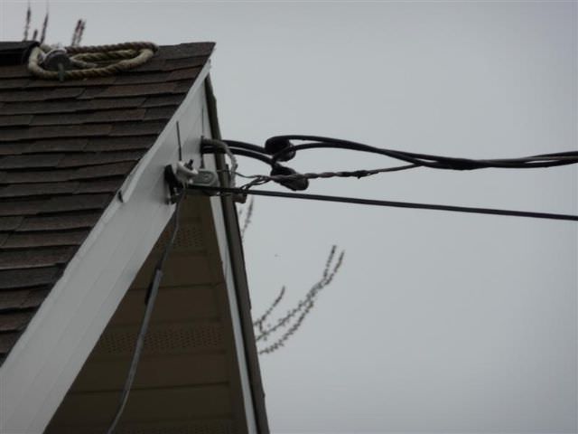

How much droop for a proper loop?
gtblum
Hi,
Not sure why you'd want it when the cable is below the entry point. The whole point of the drip is to prevent water from flowing downward into the weatherhead and mast if the weatherhead and mast are higher than the cable wouldn't a drip loop be pretty much good for nothing?
ONE TEAM - ONE FIGHT!!!
Mike
Link to comment
Share on other sites
I agree with Mike about the slope/loop/whatever being OK but...ummm...what weatherhead? I'm certain that it's not kosher to have the SECs entering a hole like that!

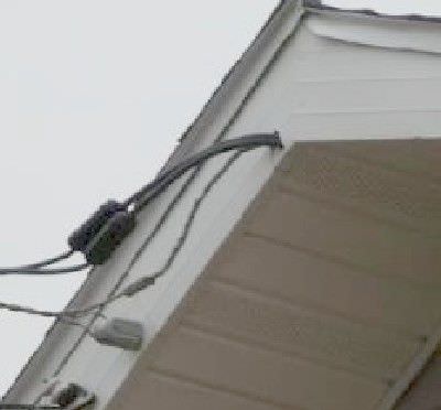

Hi,
yeah that too.
Here's another angle. More like what you see in person. Looked Kind of shallow. Earned my money today. There was a lot of lipstick on that pig.
Thanks guys.
