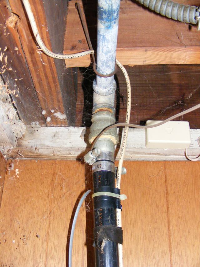

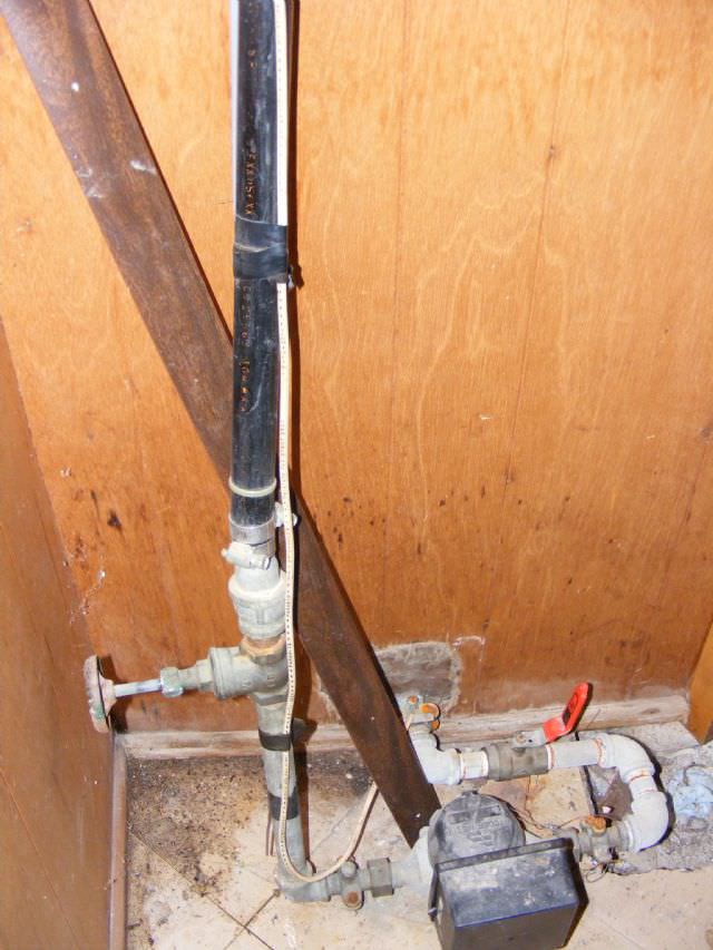

Jeff Beck Posted March 27, 2009 Report Share Posted March 27, 2009 Six foot section that runs from the water meter to a galvanized nipple for distribution. It's stamped with Orangeburo (Orangeburg?) SP 100 PSI. Clamped at both ends with automotive clamps so it's very suspect. I'm thinking that it's either HDPE or ABS. Aside from the wrong clamps is it allowed for inside distribution? Click to Enlarge 92.79 KB Click to Enlarge 106.11 KB Thanks, Jeff Beck Foresight Inspection Service LLC Quote Link to comment Share on other sites More sharing options...
Jim Katen Posted March 27, 2009 Report Share Posted March 27, 2009 Six foot section that runs from the water meter to a galvanized nipple for distribution. It's stamped with Orangeburo (Orangeburg?) SP 100 PSI. Clamped at both ends with automotive clamps so it's very suspect. I'm thinking that it's either HDPE or ABS. Aside from the wrong clamps is it allowed for inside distribution? That's PE pipe. Around here, everyone calls it funny pipe, which is, I believe, a brand name. It's supposed to be used for wells & irrigation. Every old farmhouse in these parts seems to use some of it indoors here & there. Neither the UPC or the IRC allow it as distribution pipe. But I've gotta say that, after seeing hundreds of houses with this stuff under them, I've never seen it leak. - Jim Katen, Oregon Quote Link to comment Share on other sites More sharing options...
Bill Kibbel Posted March 27, 2009 Report Share Posted March 27, 2009 Funny Pipe is a trademark of Toro and that tubing is not tested/rated for potable water. HDPE is what's pictured and as Jim said, is permitted for supply, not distribution. It's probably manufactured in Orangeburg, NY or SC. Anyone still see any old "Orangeburg" sewer lines? Quote Link to comment Share on other sites More sharing options...

Jeremy Posted March 29, 2009 Report Share Posted March 29, 2009 Jim, When you've seen it how is it clamped? As I recall, it was hub fittings with some kind of tar holding them together. - Jim Katen, Oregon I think Jeff is referring to the supply line application in his photos. The clamping in the pictures is the correct way to connect the pipe to the fittings. Quote Link to comment Share on other sites More sharing options...
Jim Katen Posted March 29, 2009 Report Share Posted March 29, 2009 Jim, When you've seen it how is it clamped? As I recall, it was hub fittings with some kind of tar holding them together. - Jim Katen, Oregon I think Jeff is referring to the supply line application in his photos. The clamping in the pictures is the correct way to connect the pipe to the fittings. Oh, oops. Yes, what Jeremy said. Hose clamps seem to work just fine. - Jim Katen, Oregon Quote Link to comment Share on other sites More sharing options...
