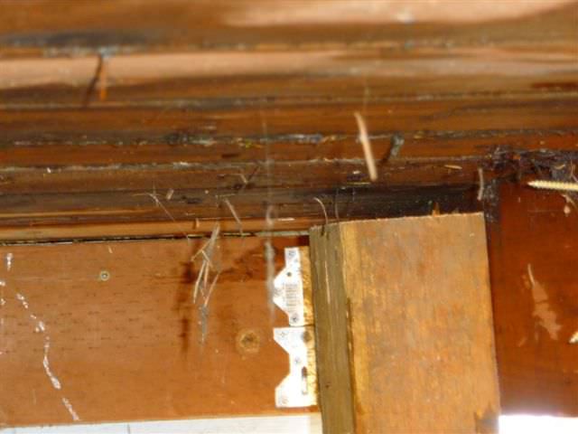

Robert Jones Posted April 1, 2009 Report Share Posted April 1, 2009 I inspected a 11 yr old manufactured home today and the deck installed on the front a rear of the home were completed by the current home owner(flipper). As I was kneeling down to view the underside of the deck, I heard him say "the county said it was good". Just goes to show. Hope the pics show the quality workmanship. Click to Enlarge 50.45 KB Click to Enlarge 49.64 KB Click to Enlarge 40.48 KB Click to Enlarge 78.53 KB Quote Link to comment Share on other sites More sharing options...
RickSab Posted April 5, 2009 Report Share Posted April 5, 2009 Let me guess. The county looks at drawings and says OK that will work. I can't believe that that was inspected by even a parking meter attendant. Quote Link to comment Share on other sites More sharing options...
Robert Jones Posted April 5, 2009 Author Report Share Posted April 5, 2009 I think what happened was, the county guru came out and made sure that it wasn't actually attached to the manufactured home. Did not actually look at the construction of the thing. At least the guy that built it was consistent, the back deck was identical. Quote Link to comment Share on other sites More sharing options...
