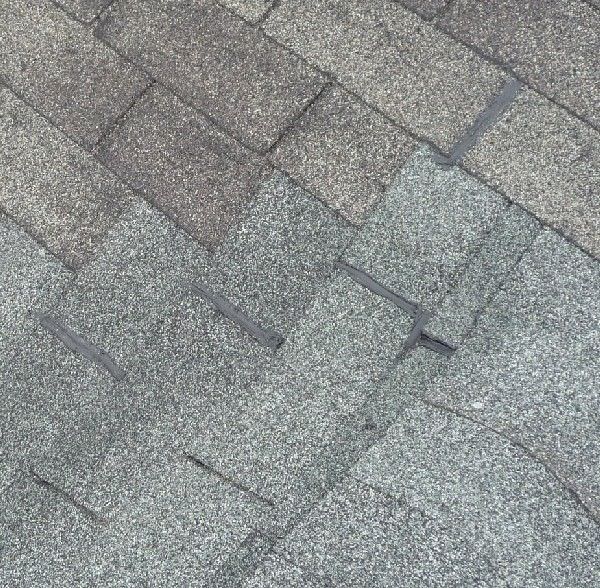

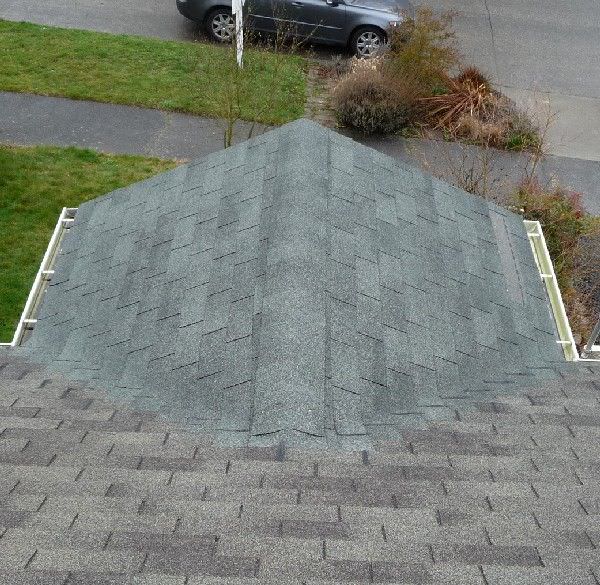

Richard Moore Posted April 3, 2009 Report Share Posted April 3, 2009 A swept valley is the prettiest. ...and at the other end of the scale there's this from today's inspection. Click to Enlarge 112.03 KB Click to Enlarge 157.91 KB Click to Enlarge 139.72 KB Evidently, you can do it anyway you want as long as you caulk between every tab! [:-propell Quote Link to comment Share on other sites More sharing options...
Jim Katen Posted April 3, 2009 Report Share Posted April 3, 2009 A swept valley is the prettiest. The third course up on the left side is uneven. I think he should redo it. - Jim Katen, Oregon Quote Link to comment Share on other sites More sharing options...
Jeremy Posted April 3, 2009 Report Share Posted April 3, 2009 I agree with Kurt and Bill. The swept valley is the prettiest, but for those who don't have that privelege I like the clean line of a well cut closed cut valley. Jim, that swept valley may look alright to you in a couple years. Quote Link to comment Share on other sites More sharing options...

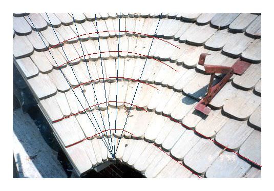

Kyle Kubs Posted April 3, 2009 Report Share Posted April 3, 2009 A swept valley is the prettiest. The third course up on the left side is uneven. I think he should redo it. - Jim Katen, Oregon To my eye, it looks like more then just the third course. The angle of the picture may be skewing things a lot from what they really are but it looks like the arcs, angles & exposure are running off. Click to Enlarge 48.79 KB I would starve to death doing that kind of work. I find it impossible to keep my furnituremaker's blood from running the show. Any of my friends seeing me up on that roof would instantly say, "check his tool belt, bet ya he's got a dial caliper in there somewhere" It's not my fault really, I have this geometrical obsession that puts me into the deranged category of anal where that stuff is involved. Quote Link to comment Share on other sites More sharing options...

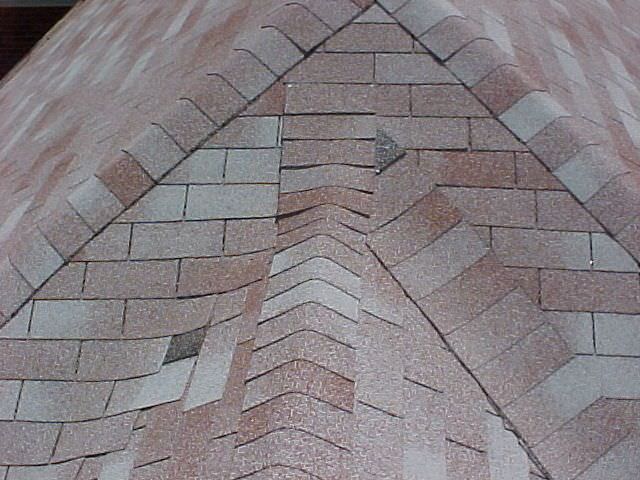

Garet Posted April 16, 2009 Report Share Posted April 16, 2009 Open or woven doesn't really matter, as long as you install proper valley cap shingles on top. Click to Enlarge 74.24 KB Quote Link to comment Share on other sites More sharing options...
Jerry Simon Posted April 16, 2009 Report Share Posted April 16, 2009 Open or woven doesn't really matter, as long as you install proper valley cap shingles on top. Click to Enlarge 74.24 KB That's one of the funniest construction pictures I've ever seen. Like those weird pictures...the more you stare, the more you see you can't believe. Quote Link to comment Share on other sites More sharing options...
