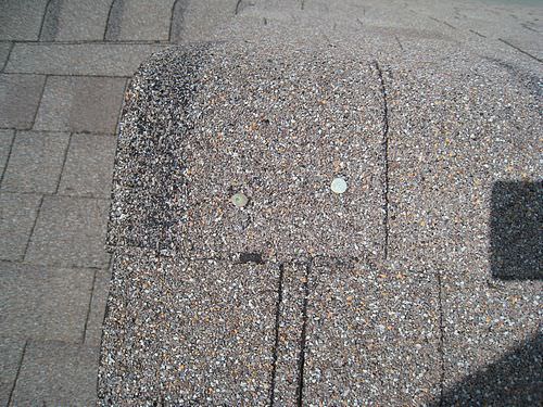

Chris Bernhardt Posted April 7, 2009 Report Share Posted April 7, 2009 Anyone every heard of hot nailing asphalt shingles? I called out exposed roofing nails on some ridge end shingles on a newly constructed residence, and the builder shot back that he doesn't have to seal over the nails because they are hot nailed. I googled hot nailing shingles and didn't find anything. Sounds like BS to me. Chris, Oregon Quote Link to comment Share on other sites More sharing options...
Jim Katen Posted April 7, 2009 Report Share Posted April 7, 2009 Anyone every heard of hot nailing asphalt shingles? I called out exposed roofing nails on some ridge end shingles on a newly constructed residence, and the builder shot back that he doesn't have to seal over the nails because they are hot nailed. I googled hot nailing shingles and didn't find anything. Sounds like BS to me. Never heard the term. Perhaps he meant that they were hot-dipped galvanized nails and would be less likely to corrode over time? - Jim Katen, Oregon Quote Link to comment Share on other sites More sharing options...
Chris Bernhardt Posted April 7, 2009 Author Report Share Posted April 7, 2009 Never heard the term. Perhaps he meant that they were hot-dipped galvanized nails and would be less likely to corrode over time? - Jim Katen, Oregon He claims that the nails are hot and self seal against the roofing. I say it's BS. Chris, Oregon Quote Link to comment Share on other sites More sharing options...
Jim Morrison Posted April 7, 2009 Report Share Posted April 7, 2009 Chris, You're correct. Quote Link to comment Share on other sites More sharing options...
Scottpat Posted April 7, 2009 Report Share Posted April 7, 2009 Never heard the term. Perhaps he meant that they were hot-dipped galvanized nails and would be less likely to corrode over time? - Jim Katen, Oregon He claims that the nails are hot and self seal against the roofing. I say it's BS. Chris, Oregon Tell him that you researched and you can not find anything about "Hot nailing". Ask him to provide you with documentation from the shingle manufacturer saying that "Hot nailing" is OK and does not need sealing. I bet he can't find anything.. Quote Link to comment Share on other sites More sharing options...
Jim Katen Posted April 8, 2009 Report Share Posted April 8, 2009 Never heard the term. Perhaps he meant that they were hot-dipped galvanized nails and would be less likely to corrode over time? - Jim Katen, Oregon He claims that the nails are hot and self seal against the roofing. I say it's BS. Chris, Oregon Don't the ceramic granules get in the way? - Jim Katen, Oregon Quote Link to comment Share on other sites More sharing options...
Chris Bernhardt Posted April 8, 2009 Author Report Share Posted April 8, 2009 Don't the ceramic granules get in the way? - Jim Katen, Oregon Click to Enlarge 78.12 KB Yep. Chris, Oregon Quote Link to comment Share on other sites More sharing options...

Jim Katen Posted April 8, 2009 Report Share Posted April 8, 2009 [Click to Enlarge 78.12 KB Yep. Chris, Oregon Well, those are electro plated so I guess my idea of hot-dipped nails is out the window. - Jim Katen, Oregon Quote Link to comment Share on other sites More sharing options...
