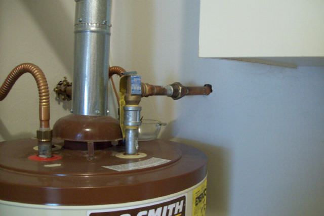

tbird Posted April 8, 2009 Report Share Posted April 8, 2009 Another doosy from today. With the TPR valve raised on a extension like this, the temperature probe is not protruding in the tank and will not work properly. Am I right? Click to Enlarge 27.94 KB Thanks for your input! Quote Link to comment Share on other sites More sharing options...
Jim Katen Posted April 8, 2009 Report Share Posted April 8, 2009 Another doosy from today. With the TPR valve raised on a extension like this, the temperature probe is not protruding in the tank and will not work properly. Am I right? Depends. They make TPR valves with extra long probes. Get the model number off the valve to be sure. - Jim Katen, Oregon Quote Link to comment Share on other sites More sharing options...
Terence McCann Posted April 9, 2009 Report Share Posted April 9, 2009 Is that 3/4 copper on the discharge? I have a hard time telling sizes from a picture. Quote Link to comment Share on other sites More sharing options...
tbird Posted April 9, 2009 Author Report Share Posted April 9, 2009 Is that 3/4 copper on the discharge? I have a hard time telling sizes from a picture. Yeah, its 3/4. Quote Link to comment Share on other sites More sharing options...
