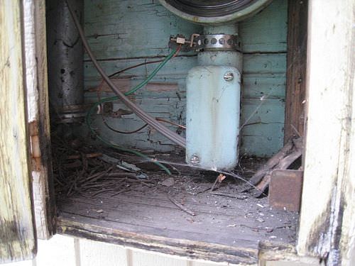

Chris Bernhardt Posted April 10, 2009 Report Share Posted April 10, 2009 What's the name of this type of grey zip looking cable? It was strippable like zip cord except it had solid conductors. Click to Enlarge 41.23 KB Chris, Oregon Quote Link to comment Share on other sites More sharing options...
caryseidner Posted April 10, 2009 Report Share Posted April 10, 2009 Looks like Romex. Quote Link to comment Share on other sites More sharing options...
Chris Bernhardt Posted April 11, 2009 Author Report Share Posted April 11, 2009 Romex has separately insulated conductors with a jacket over them. With this cable there is no jacket, just the thermoplastic molded right onto the solid conductors. Chris, Oregon Quote Link to comment Share on other sites More sharing options...
SWagar Posted April 11, 2009 Report Share Posted April 11, 2009 It looks like an appliance connector (cable) or extension cord. Quote Link to comment Share on other sites More sharing options...
Jim Katen Posted April 11, 2009 Report Share Posted April 11, 2009 It looks like an appliance connector (cable) or extension cord. It certainly does. But I've never seen one with solid conductors. The whole point of appliance cordsets is that they're flexible. I don't know what it is. - Jim Katen, Oregon Quote Link to comment Share on other sites More sharing options...

Jim Port Posted April 18, 2009 Report Share Posted April 18, 2009 Type UF cable typically has solid conductors with a gray covering. It is rated for use outdoors and underground. Quote Link to comment Share on other sites More sharing options...
hendrix Posted April 23, 2009 Report Share Posted April 23, 2009 looks like UF Quote Link to comment Share on other sites More sharing options...
Jim Katen Posted April 23, 2009 Report Share Posted April 23, 2009 Memory is odd. I don't remember having seen cable like that before you posted the picture, though clearly I must have. In the last week, now that it's on my mind, I've seen it on two inspections. It is, as Jim & Craig said, a type of UF cable. - Jim Katen, Oregon Quote Link to comment Share on other sites More sharing options...
hausdok Posted April 23, 2009 Report Share Posted April 23, 2009 Hi, Yeah, UF; I had it on an inspection Sunday. OT - OF!!! M. Quote Link to comment Share on other sites More sharing options...
