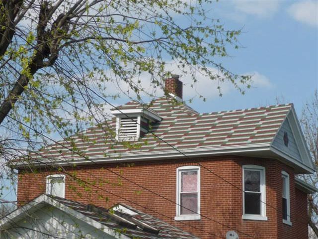

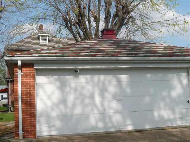

Mark P Posted April 18, 2009 Report Share Posted April 18, 2009 Click to Enlarge 65.57 KB Click to Enlarge 82.06 KB Quote Link to comment Share on other sites More sharing options...

Mark P Posted April 18, 2009 Author Report Share Posted April 18, 2009 It is one of a kind around here. I've driven by it a few times. I just decided to snap a picture the other day. You can't tell from the pictures, but it is well over 20 years old. Quote Link to comment Share on other sites More sharing options...

Richard Moore Posted April 19, 2009 Report Share Posted April 19, 2009 . . . So really, I suspect that it's a case of what "supply house" the home owner found that gave a "discount" on materials. Or which jobsites the owner found that didn't lock up their materials at night. - Jim Katen, Oregon That's what I was trying to say...in a more PC way. Think of "supply house" in the broadest terms. Somehow I just don't see that as the work of someone who would sneak around stealing materials. Too neat, not just the roof, but the house as well. I'd guess it was a deliberate choice, maybe drug induced, but deliberate. It's certainly not my taste, but it does look well executed. Quote Link to comment Share on other sites More sharing options...

Tom Raymond Posted April 20, 2009 Report Share Posted April 20, 2009 That is definately intentional and I give them an A+ for holding that pattern, but they get an F for execution. "Booking" shingles like that violates every manufactuters installation instructions that I can think of. Tom Quote Link to comment Share on other sites More sharing options...
Mark P Posted April 20, 2009 Author Report Share Posted April 20, 2009 That is definately intentional and I give them an A+ for holding that pattern, but they get an F for execution. "Booking" shingles like that violates every manufactuters installation instructions that I can think of. Tom Tom, What does "Booking" mean? Quote Link to comment Share on other sites More sharing options...

Tom Raymond Posted April 20, 2009 Report Share Posted April 20, 2009 That is definately intentional and I give them an A+ for holding that pattern, but they get an F for execution. "Booking" shingles like that violates every manufactuters installation instructions that I can think of. Tom Tom, What does "Booking" mean? I'm refering to the way they offset the shingles. First course is a full tab, next course is a half tab, next is full, and so on, the butt ends of alternating courses align and are very close to the butt ends of the courses between them. This is the way roofers get a job done quickly, and it is contrary to every shingle manufacturer's installation instructions that I'm aware of. "Booking" is what we called it when I was a roofer, probably 16 - 18 years ago now. Tom Quote Link to comment Share on other sites More sharing options...
Jim Katen Posted April 21, 2009 Report Share Posted April 21, 2009 I'm refering to the way they offset the shingles. First course is a full tab, next course is a half tab, next is full, and so on, the butt ends of alternating courses align and are very close to the butt ends of the courses between them. This is the way roofers get a job done quickly, and it is contrary to every shingle manufacturer's installation instructions that I'm aware of. "Booking" is what we called it when I was a roofer, probably 16 - 18 years ago now. Tom If you're referring to the vertical racking method, Certainteed allows it on many of their shingle products and includes instructions for it as an acceptable method in their Shingle Applicator's Manual. - Jim Katen, Oregon Certainteed Master Shingle Applicator Wizard Quote Link to comment Share on other sites More sharing options...
