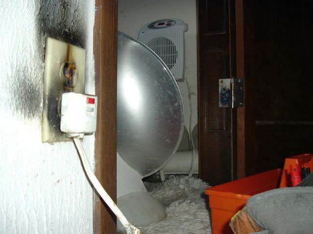

Mr. Electric Posted April 20, 2009 Report Share Posted April 20, 2009 I have personally tested 20 amp (Zinsco) circuits with 30 amps on them that did not trip (see picture running 2 portable heaters and hairdryer at the same time). Jim K. is right in that there is not a lot of hard evidence on them except what you can find at http://www.inspect-ny.com/elec...sco.htm. I helped Daniel Friedman put this information together (most of the pictures are ones that I personally took). I donââ¬â¢t have time to log onto this site a lot. So if you have any specific questions I am at mrelectricoly@msn.com Click to Enlarge 44.64 KB Quote Link to comment Share on other sites More sharing options...
