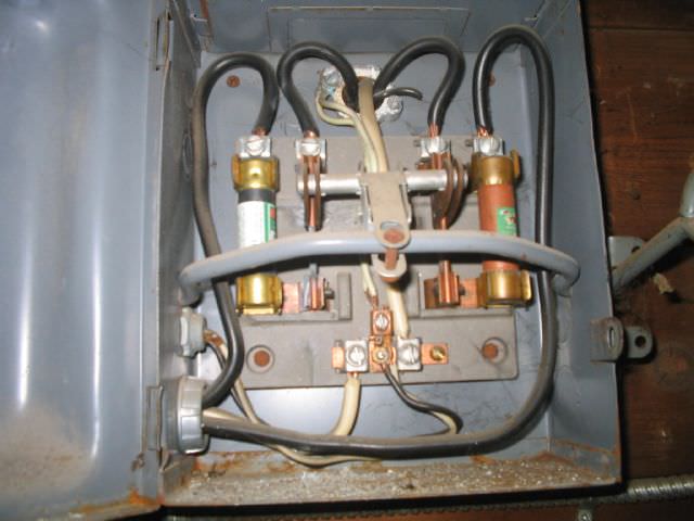

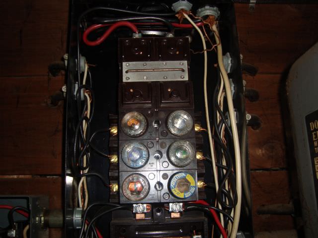

schooner Posted April 22, 2009 Author Report Share Posted April 22, 2009 Thank's Jim, I'll keep this in mind. I wrote this up the attached pictures as get a licensed electrician in for repair/upgrade, with a few other choice words. Main/service and 2 sub panels. Looks like a feed from the service panel to the sub's was unprotected.(sorry for the picture quality). Would like feed back. Also water penatration into the main. Click to Enlarge 49.08 KB Click to Enlarge 46.96 KB Quote Link to comment Share on other sites More sharing options...
