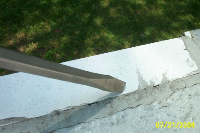

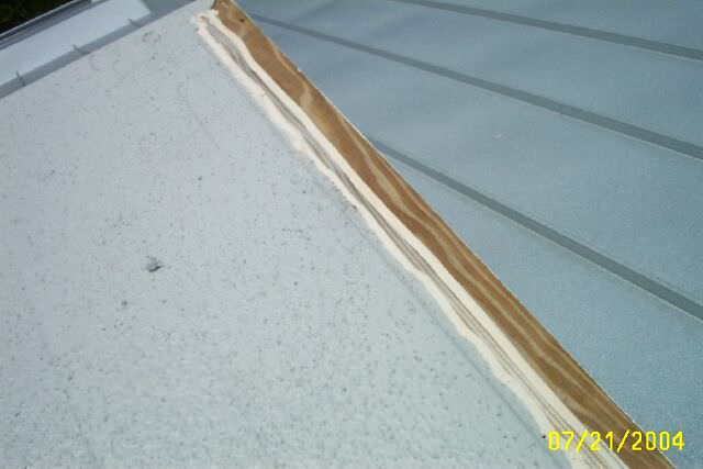

Danny Pritchard Posted July 22, 2004 Report Share Posted July 22, 2004 Is anyone familiar with this type of roof?It is a concrete type material with some type of coating painted on top.The picture is from the balcony they also had this on a covered walkway.This was on a new home.There were several things about this roof that I questioned. Download Attachment: Concrete roof.jpg 51.55 KB Download Attachment: Poorly sealed flat roof flashing.jpg 70.42 KB Quote Link to comment Share on other sites More sharing options...

Danny Pritchard Posted July 22, 2004 Author Report Share Posted July 22, 2004 Mike, This was a hard surface.It seemed like a concrete material to me.When you say urethane if you are talking about a rubber type material I would have expected it to cover the drip edge in the 2nd photo. Quote Link to comment Share on other sites More sharing options...

Danny Pritchard Posted July 22, 2004 Author Report Share Posted July 22, 2004 I'm not familiar with flexicor panels.What I normally see is either a rolled roofing or a concrete type roof over a rubber membrane similar to a showerpan construction.The way this roof was flashed sent up a red flag. Quote Link to comment Share on other sites More sharing options...
hausdok Posted July 22, 2004 Report Share Posted July 22, 2004 Hi, It still looks like a urethane surface to me. Is it possible that there is another drip edge beneath the one that is showing that the roof was originally bonded to. Urethane surfaces are nothing more than a layer of liquid urethane poured over a deck that has been especially primed. The joints, flashings and edging are all taped in first with fiberglass mesh lain in urethane and then another layer or two are applied waiting a day or two between coats. At some point, sand is spread onto a fresh coating while it is still wet and it is allowed to dry. Finally, a topcoat goes on over the sanded coat and the whole thing is air cured. The final product can be anywhere from 1/8 to 1/4 inch thick and is extremely durable and hard. ONE TEAM - ONE FIGHT!!! Mike Quote Link to comment Share on other sites More sharing options...
Jim Katen Posted July 22, 2004 Report Share Posted July 22, 2004 I agree with Mike. It looks exactly like Gacodeck, a urethane coating used to waterproof decks & balconies. - Jim Katen, Oregon Quote Link to comment Share on other sites More sharing options...
