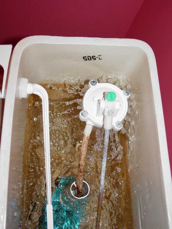

Brian G Posted July 22, 2004 Report Share Posted July 22, 2004 I've run into this particular thing twice now. I don't know if these are designed to work this way (not much going down the filler tube), or it's a blown gasket thing, or what. Someone shed light on the dark recesses of my ignorance please. Brian G. [:-boggled] Download Attachment: BriansBallcockValve.jpg 59.03 KB Quote Link to comment Share on other sites More sharing options...
kurt Posted July 22, 2004 Report Share Posted July 22, 2004 Blown gasket; ya need new tank guts..... Quote Link to comment Share on other sites More sharing options...
Brian G Posted July 22, 2004 Author Report Share Posted July 22, 2004 Thank you Herr Mitenbueler! The only reason I doubted myself was because if you lean down and look under there you see a bunch of little openings that just might be designed for this. So let me go a step farther down "DUH!" lane. Why does it matter whether the water goes down the tube or just out into the tank? The ones I've seen like this appear to function normally. Brian G. A Plumber I Ain't [:-dunce] Quote Link to comment Share on other sites More sharing options...
kurt Posted July 22, 2004 Report Share Posted July 22, 2004 There should still be water going down the tube, some going out the normal exit, & a lot is going out the head gasket. The bowl is probably not getting it's "fill", but is getting enough to make it work. While I could get specific, they work this way, although it isn't "right". I'd tell them to repair/replace the tank hardware. Quote Link to comment Share on other sites More sharing options...
rfarrell Posted July 22, 2004 Report Share Posted July 22, 2004 Brian, The other thing about these is that they often splatter up under the tank lid and down the back and wall etc. Quote Link to comment Share on other sites More sharing options...
Brian G Posted July 22, 2004 Author Report Share Posted July 22, 2004 Go figure. Last week I did a house with 3 toilets, all had problems with the supply line for the tube. One missing entirely, one cut very short discharging in the tank, and one very long so badly crimped that no water was passing through it. All of the toilets worked as if nothing was wrong(?). Naturally I wrote 'em up anyway, and these get it too. Brian G. If'n It Taint' Right, Taint Right! [^] Quote Link to comment Share on other sites More sharing options...
DonTx Posted July 22, 2004 Report Share Posted July 22, 2004 This is one of the qualities I like about Mr. G, always bringing up stuff I forget about. Now that he's cleared up the leaking head gasket problem I've wondered about, I'll ask another one. Should there be a 1 inch difference between the top of the fill tube and the ball cockvalve? I've heard something about needing an air gap to prevent possible back siphoning...is this it? C'mon people, let's talk commodes! Donald Quote Link to comment Share on other sites More sharing options...

Paul MacLean Posted July 22, 2004 Report Share Posted July 22, 2004 Originally posted by Donald Lawson This is one of the qualities I like about Mr. G, always bringing up stuff I forget about. Now that he's cleared up the leaking head gasket problem I've wondered about, I'll ask another one. Should there be a 1 inch difference between the top of the fill tube and the ball cockvalve? I've heard something about needing an air gap to prevent possible back siphoning...is this it? C'mon people, let's talk commodes! Donald The fill valve, flush valve, whatever you want to call it should be at least an inch above the top over the overflow tube in the tank to stop back-siphoning and prevent possible cross-connections. Think of it as an air gap. New guts for most toilet tanks can be had at the big orange box for less then $10. I tell'em they come with directions and if you know a few four letter words, it's a do-it-yourself project. Quote Link to comment Share on other sites More sharing options...
DonTx Posted July 22, 2004 Report Share Posted July 22, 2004 Great...I've been doing those two things...now on to the third item. Some ballcocks do not have a fill hose. Should all of them have a fill hose running over to the overflow tube? I've often thought that those flush assemblies filling from the bottom could be a source of cross contamination. I suppose there is a back flow preventer built in? Donald Toilet Mouth For A Day [:-king] Quote Link to comment Share on other sites More sharing options...

Paul MacLean Posted July 23, 2004 Report Share Posted July 23, 2004 Originally posted by Donald Lawson Great...I've been doing those two things...now on to the third item. Some ballcocks do not have a fill hose. Should all of them have a fill hose running over to the overflow tube? I've often thought that those flush assemblies filling from the bottom could be a source of cross contamination. I suppose there is a back flow preventer built in? Donald Toilet Mouth For A Day [:-king] I don't worry about those little fill hoses unless they're not tied down and squirt water everywhere. Some run into the overflow tube and some directly into the tank. Another note: Using toilets to date houses doesn't work here. The City of Austin has been promoting the 1.6 gallon commodes (even giving them away) to cut down on water usage. As a result old toilets hardly exist anymore. Several years ago I saw a demonstration by the Texas Board of Plumbing Examiners on possible cross-connections. One example was an improper flush valve in a toilet tank. With a loss of water pressure, you could turn on a sink faucet and fill your glass with toilet water.[:-sick] Texas SOP says look in toilet tanks. Quote Link to comment Share on other sites More sharing options...
kurt Posted July 23, 2004 Report Share Posted July 23, 2004 Several years ago I saw a demonstration by the Texas Board of Plumbing Examiners on possible cross-connections. One example was an improper flush valve in a toilet tank. With a loss of water pressure, you could turn on a sink faucet and fill your glass with toilet water.[:-sick] Texas SOP says look in toilet tanks. Now I'm in the DUH category. I know about this concern, but isn't that "fill your glass w/ toilet TANK water, which is potable water?" This wouldn't backsiphon toiler BOWL water, would it? How could it? Quote Link to comment Share on other sites More sharing options...

Jerry Simon Posted July 23, 2004 Report Share Posted July 23, 2004 Originally posted by kurt Several years ago I saw a demonstration by the Texas Board of Plumbing Examiners on possible cross-connections. One example was an improper flush valve in a toilet tank. With a loss of water pressure, you could turn on a sink faucet and fill your glass with toilet water.[:-sick] Texas SOP says look in toilet tanks. Now I'm in the DUH category. I know about this concern, but isn't that "fill your glass w/ toilet TANK water, which is potable water?" This wouldn't backsiphon toiler BOWL water, would it? How could it? Kurt, Now that you're gonna start looking in the tanks, you'll be amazed at what is growing in some of them...mold, scum like you wouldn't believe. THAT is what you'd be drinking with a cross-connection. And, you'll be amazed at how many "short" fill valves are installed by homeowners when the original valve fails, creating a cross-connection. Also, anyone with thoughts on those tanks where the low-profile white fill valve is mounted to the bottom of the tank? If that ain't a cross-connection, what is? Quote Link to comment Share on other sites More sharing options...
Paul MacLean Posted July 23, 2004 Report Share Posted July 23, 2004 Originally posted by Jerry Simon Originally posted by kurt Several years ago I saw a demonstration by the Texas Board of Plumbing Examiners on possible cross-connections. One example was an improper flush valve in a toilet tank. With a loss of water pressure, you could turn on a sink faucet and fill your glass with toilet water.[:-sick] Texas SOP says look in toilet tanks. Now I'm in the DUH category. I know about this concern, but isn't that "fill your glass w/ toilet TANK water, which is potable water?" This wouldn't backsiphon toiler BOWL water, would it? How could it? Kurt, Now that you're gonna start looking in the tanks, you'll be amazed at what is growing in some of them...mold, scum like you wouldn't believe. THAT is what you'd be drinking with a cross-connection. And, you'll be amazed at how many "short" fill valves are installed by homeowners when the original valve fails, creating a cross-connection. Also, anyone with thoughts on those tanks where the low-profile white fill valve is mounted to the bottom of the tank? If that ain't a cross-connection, what is? Thanks Jerry! You said it. Quote Link to comment Share on other sites More sharing options...
kurt Posted July 23, 2004 Report Share Posted July 23, 2004 Alas, I am a cretin. Still yet another safety issue to dwell upon. "If I could not have been a Prince, I would have been a plumber." Allegedly, that is the final quote of the Earl of Mountbatten(or some one of those inbred English gentry) as he lay on his deathbed, dying of ecoli ingested due to a careless plumber of the 19th century who hooked things up backwards. Ahhh, the cheek of those Brits...... That said, I've had the opportunity to tour various municipal water reservoirs in my day, & they are all mildly nasty w/ scum & crud. In fact, I'm not sure the interior of my mouth is in as good a bacteriological condition as my toilet tank. I might grudgingly start looking in tanks, but I'm not telling anyone nuthin'. [!] Kiddin..... Quote Link to comment Share on other sites More sharing options...
