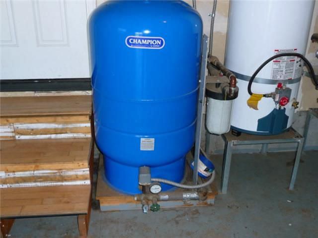

Robert Jones Posted May 1, 2009 Report Share Posted May 1, 2009 My experience has always led me to believe that these pumps were used with private wells. Am I wrong? The buyers were told that the water source is public. Thanks, Click to Enlarge 37.68 KB Quote Link to comment Share on other sites More sharing options...
Robert Jones Posted May 1, 2009 Author Report Share Posted May 1, 2009 Well, The product is A tank made by Amtrol and is the Champion line. This is the product; http://www.amtrol.com/champion.htm Quote Link to comment Share on other sites More sharing options...
Bill Kibbel Posted May 1, 2009 Report Share Posted May 1, 2009 That link shows a hydro-pneumatic tank, not a pump. If there was no visible pump, or wires and a pressure control switch for a submerged pump, I don't know why they'd want the tank. Quote Link to comment Share on other sites More sharing options...
waynesoper Posted May 1, 2009 Report Share Posted May 1, 2009 If you are looking at a well tank then the house has a well or has a booster system added to increase flow for rain style shower heads or large tubs. Typically a booster system uses what is called a jet pump, ( google it) It sits next to the well tank. Typically a well pump will be at the bottom of the well and cannot be seen without hauling up 100 or so feet of platic pipe. So which is it.? Quote Link to comment Share on other sites More sharing options...
Robert Jones Posted May 1, 2009 Author Report Share Posted May 1, 2009 This is a well tank w/pressure gauge/power box. Quote Link to comment Share on other sites More sharing options...
waynesoper Posted May 1, 2009 Report Share Posted May 1, 2009 so is there black pipe of copper pipe coming into the house. Is there a jet pump? whats up there? Now you have us all wondering. Quote Link to comment Share on other sites More sharing options...
Robert Jones Posted May 1, 2009 Author Report Share Posted May 1, 2009 Wayne, There is a copper feed to the interior. The tank is located in the garage. I have e-mailed you a couple of pics. Did I mention that I really wish Windows Vista had the powertoy resizer? Quote Link to comment Share on other sites More sharing options...
Kyle Kubs Posted May 2, 2009 Report Share Posted May 2, 2009 I'm not liking these new pre-sized pictures (read small) I can't zoom in and see things up close. I've got a 19" monitor here and I'm looking at a tiny picture that only covers less then 1/4 of it. What I do see in your image is the pipe coming into the tank and an electric cable coming into the pressure switch but no water pipe continuing past the tank and no visible power cable coming out of the switch to go to the pump. Makes me think it is an unfinished installation. Looks like a plug in the end of the pipe just to the left of the pressure switch, where the pipe normally continues to distribution. Maybe a well for landscape water? There is a sediment filter on the piping to the right, usually indicates a well... Quote Link to comment Share on other sites More sharing options...

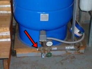

Bill Kibbel Posted May 2, 2009 Report Share Posted May 2, 2009 There has been a pipe disconnected here: Click to Enlarge 12.06 KB The missing pipe was the feed from the well. Quote Link to comment Share on other sites More sharing options...
Robert Jones Posted May 2, 2009 Author Report Share Posted May 2, 2009 Thanks Bill. What would explain the pressure gauge reading approx 50 when the water was not running? I was a little bit limited to to the propane service being removed and the water heater(S) not working. V/R Quote Link to comment Share on other sites More sharing options...

Jim Katen Posted May 2, 2009 Report Share Posted May 2, 2009 I see a pressure tank with a pressure control swich with wiring leading around to the right, problably to a pump somewhere. If this house is on city water, they may simply be getting low pressure from the main. In order to increase the pressure, they might have installed a booster pump and a tank to store the pressure. If you follow the wires from the pressure control switch, you'll find the pump. We have very low pressure at my house. We have a water co-op out here and my house is high up on a hill, not very far below the reservoir. We average 20 - 25 psi most days. That means showers are a slow leisurely affair. The water stream that comes out of my kitchen faucet is rarely more than the diameter of a pencil. Shortly after we moved in, I decided to install a pump & pressure tank like the one in Rob's picture. It's been 19 years now and I'm almost ready to get around to it. - Jim Katen, Oregon Quote Link to comment Share on other sites More sharing options...
