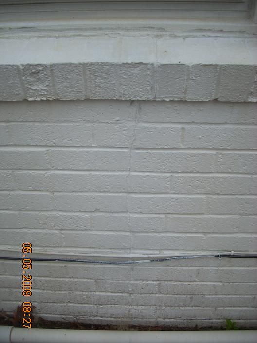

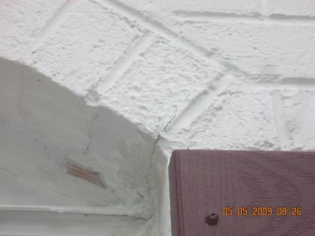

sepefrio Posted May 5, 2009 Report Share Posted May 5, 2009 As I replied in another thread, today I had a bit of fun today. But a little background. I arrive at the inspection and the only one there is the one of the "Team" members, not the agent who set up the appointment. I was told the buyers were out of town and would not make it. Well I start the inspection and finished the exterior. When I went inside, I saw a second lady there. I thought maybe she was the listing agent, but no, she is the buyer. Cool I thought, no need to mail reports/contracts. So I did my contract brief and got everything signed. At the end I asked if she had any concerns or special questions she wanted answered. She said "Yes, I used to own a home in some wetlands and the foundation here worries me". Well I told her about some of the things I had found so far (all the cracks) and that I was looking more into it. I also told her if there is foundation damage, I may not be able to see the damage itself, just signs of it and a more destructive inspection by Bob the engineer may be needed. Well I guess the agent sent to watch the inspection got scared and called her boss. About 45m later, he arrives and comes looking for me. He goes into the a rant about me scaring his clients about foundation, mold and termite damage. I was like what? The ONLY thing I said about mold or termites was my disclaimer, I hadn't seen any signs of either so far. As for the foundation, I had answered the clients question, period. He told me to just do the inspection and not talk to the clients anymore. I was just to write the report and submit it. He also said he called a buddy of his who said it was probably all good and if anything it was the footing and not the foundation. All that based on what this agent told him on the phone, lol. Anyways, here are the pictures of what I saw. Couple of notes, like I said, all the cracking had been caulked up and painted. If you can't see the cracks in the picture look for tha caulk. If you still can't let me know I'll highlight them too. I did highlight a few I thought were hard to see. Also, on the inside, there were a tremendous amount of drywall seem cracks and what looked like Spackle patches in the top and or bottom corners of windows and doors. The entire interior was freshly painted (except ceiling) but these patches were clear. Click to Enlarge 64.37 KB Click to Enlarge 52 KB Click to Enlarge 48.83 KB Click to Enlarge 39.06 KB Click to Enlarge 36.99 KB Click to Enlarge 51.83 KB Click to Enlarge 39.58 KB Click to Enlarge 41.23 KB Click to Enlarge 48.68 KB Click to Enlarge 42.68 KB Click to Enlarge 74.1 KB Click to Enlarge 58.76 KB Click to Enlarge 66.51 KB Click to Enlarge 50.09 KB Click to Enlarge 46.74 KB Click to Enlarge 59.32 KB Click to Enlarge 44.55 KB Click to Enlarge 58.9 KB In the attics, you can see the web pulling away from the gusset plate. You can see where it was, the scraping and where it is now. About 1/3 of them (all same web) were like this. Click to Enlarge 35.27 KB This is the house. Click to Enlarge 76.6 KB Quote Link to comment Share on other sites More sharing options...

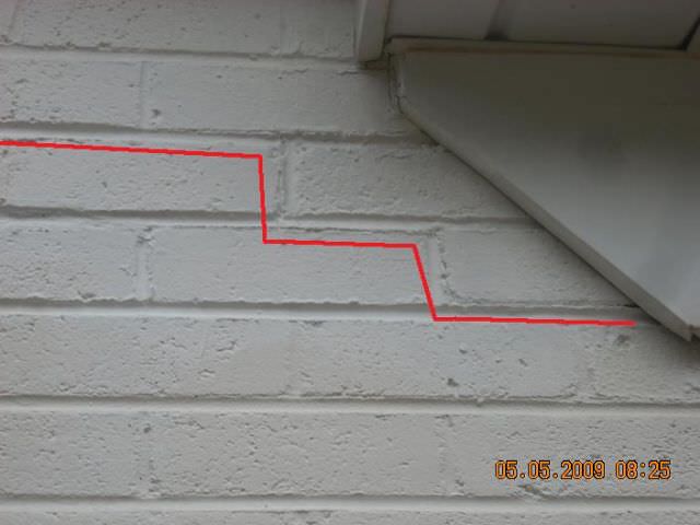

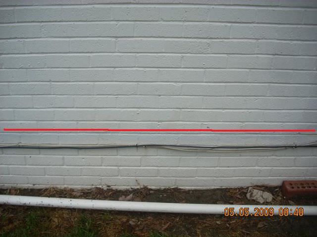

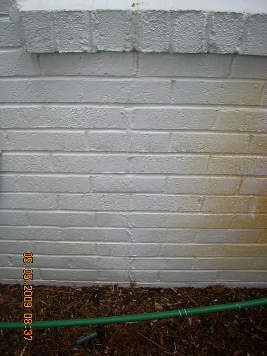

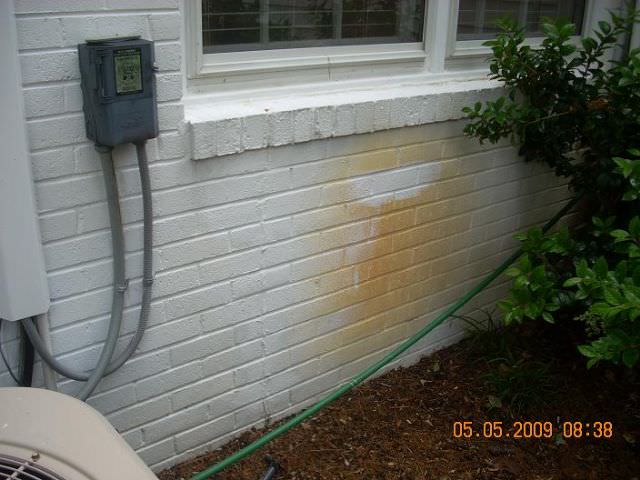

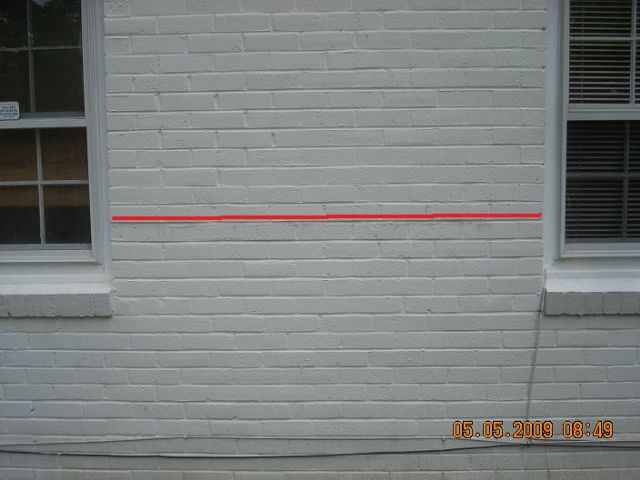

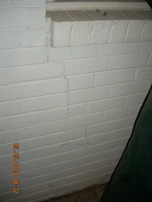

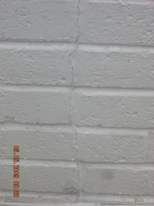

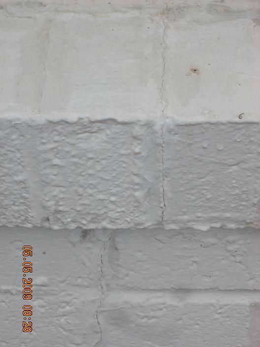

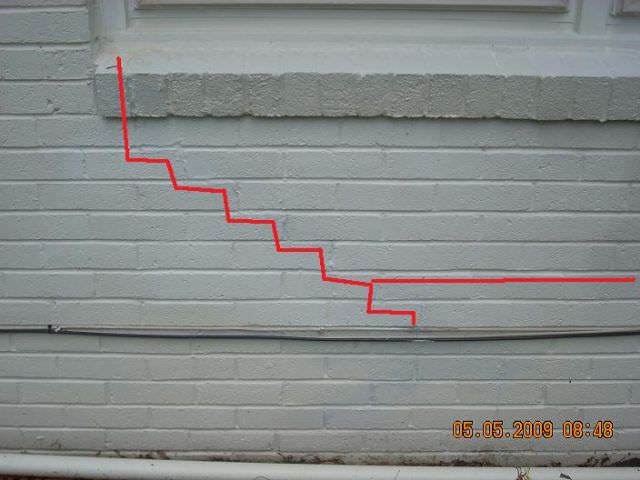

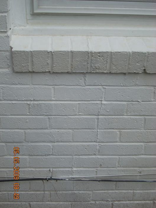

sepefrio Posted May 5, 2009 Author Report Share Posted May 5, 2009 That's just it, I can't see the foundation at all. The owner even covered the garage floor with linoleum (the bathrooms had carpeting wall to wall). And no, one by itself or a few are not a big concern. My big concern is that the cracks can be found everywhere. Those are only about half the cracks. After a while I just stopped taking pictures. No evident bowing of the exterior. All the doors and windows did open and close properly, no binding. No extra load on the truss that I saw either. I am more concerned about what I can't see instead of what I actually see. There has been so much cosmetic repair (caulk, Spackle and paint) to the home that I'm convinced there are more hidden problems. All the cracks, interior and exterior can be explained separately or it could also be one big thing. The one area that concerns me the most, is the front right. All the cracks there point in the direction of that corner of the house settling. Again could just be random or the corner is settling. The rest I could not put a real pattern to them. Maybe because the client told me she "had a home in the wetlands with a bad foundation" and that she is a lawyer has me thinking a little extra, lol. As for this agent, my first decision is what do I do about Thursday. I have another inspection with him then. Quote Link to comment Share on other sites More sharing options...

Tom Raymond Posted May 5, 2009 Report Share Posted May 5, 2009 " I am more concerned about what I can't see instead of what I actually see. There has been so much cosmetic repair (caulk, Spackle and paint) to the home that I'm convinced there are more hidden problems." I think that you should use the above in your narrative, verbatum. Pretty much says what needs to be said. As for the RE with the brass cajones, I would politely pull him aside at your next inspection and ask him not to speak to your client because he may scare them. Tom Quote Link to comment Share on other sites More sharing options...

Garet Posted May 5, 2009 Report Share Posted May 5, 2009 Lots of patched cracks certainly raises some red flags, especially if you think the patches are recent. OTOH with older houses I expect to see some signs of movement. It all boils down to what you are accustomed to seeing in your area for that type of construction. I wish I could be more definitive for you, but I've found that trying to diagnose structural issues based only on internet photos is a lot like asking a doctor to diagnose a heart murmur by putting the phone up to your chest. There's just not enough information without being there and seeing things first-hand. Quote Link to comment Share on other sites More sharing options...
