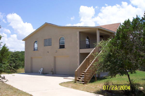

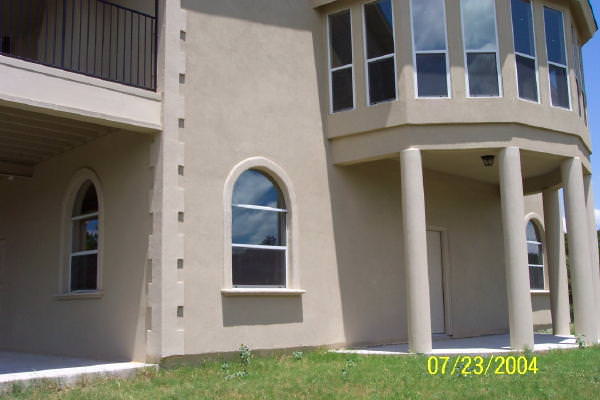

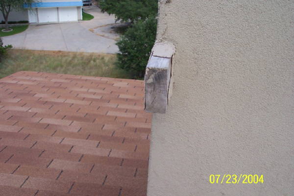

Paul MacLean Posted July 23, 2004 Report Share Posted July 23, 2004 My inspection today. A strange one for Central Texas. Concrete block exterior walls with a 'rubberized stucco' finish. What's the finish material. Any and all opinions welcome. Download Attachment: 04g2310176 (2).JPG 44.58 KB Download Attachment: 04g2310173 (2).JPG 50.39 KB Download Attachment: 04g2310174 (2).JPG 41.52 KB Quote Link to comment Share on other sites More sharing options...

DonTx Posted July 24, 2004 Report Share Posted July 24, 2004 Paul, probably applied a one coat stucco over the CMU's. For the life of me I can't remember what the type of coating is that your talking about although I see it quite often. Let me dig into my files and see if I can find the name. Seems like it's an expoxy type finish for stucco though. Looks like a 20 year shingle on the roof. Amazes me how builders spend money on some things and then scrimp on things like shingles. Donald Quote Link to comment Share on other sites More sharing options...
DonTx Posted July 24, 2004 Report Share Posted July 24, 2004 Okay. If it's what I'm thinking of, it's like Sto's powerwall or powerflex system. It's made up of elastomeric polymers. It may or may not have silicone in it depending upon the brand and manufacturer. If you pick at it just a little, it will look like rubber or vinyl. You'd think you could peel it off if you tried. Donald Quote Link to comment Share on other sites More sharing options...
Danny Pritchard Posted July 24, 2004 Report Share Posted July 24, 2004 Looks like it may be the same material they use on EIFS.You may try going to the Dryvit or Accucrete websites.Those are two of the more popular manufacurers of this material in my area. Quote Link to comment Share on other sites More sharing options...
RobC Posted July 25, 2004 Report Share Posted July 25, 2004 I'd guess Brown + Acrylic finish coat. Quote Link to comment Share on other sites More sharing options...
chrisprickett Posted July 25, 2004 Report Share Posted July 25, 2004 Looks like this to me... http://www.teifs.com/ Quote Link to comment Share on other sites More sharing options...
